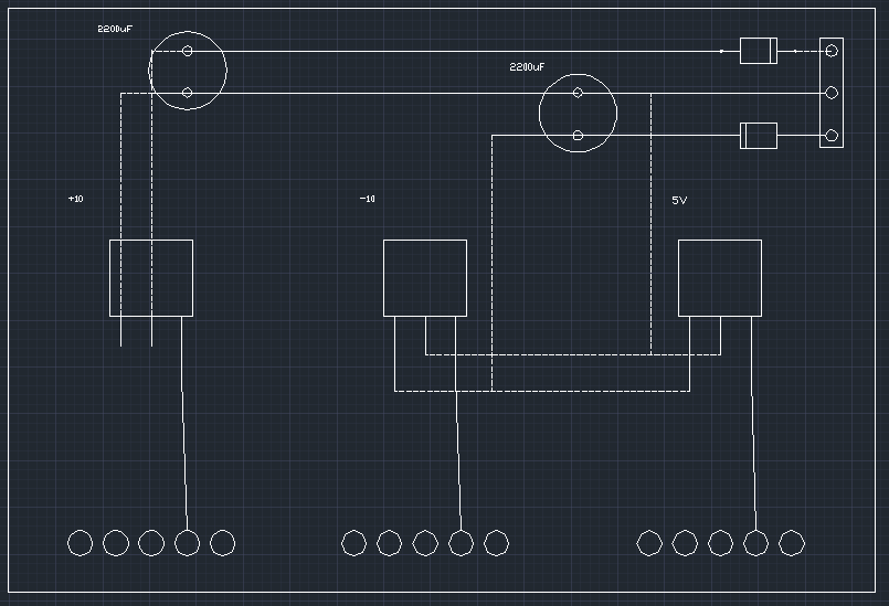

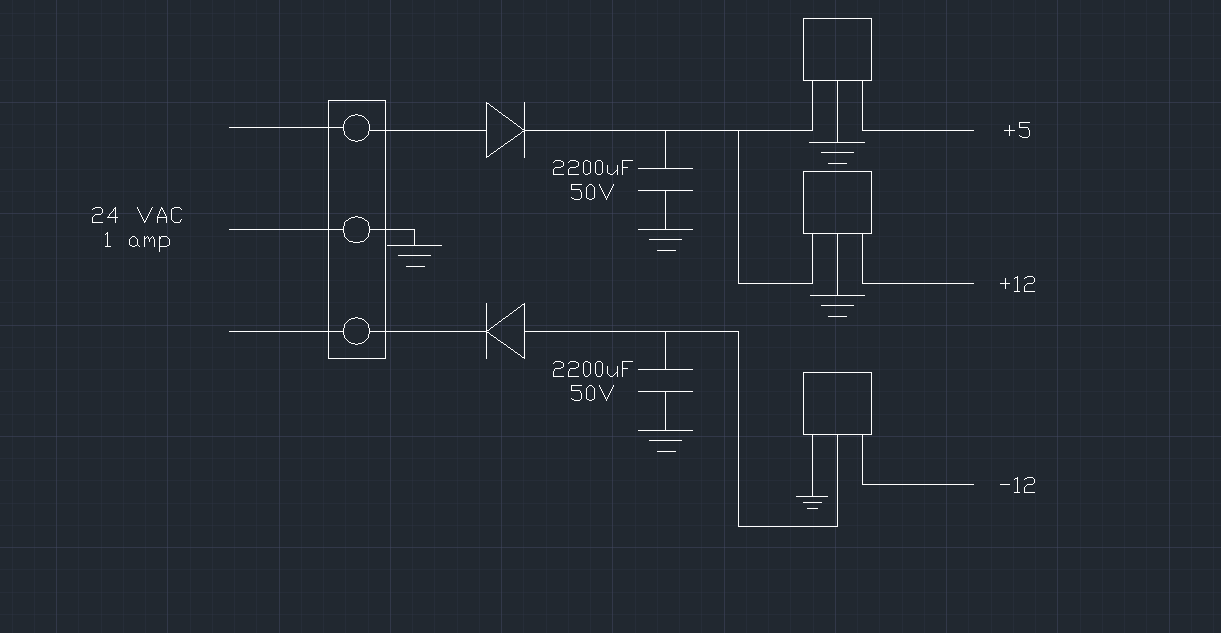

The regulator ground reference MUST be taken from the OUTPUT node where power is sent to the next circuit..
All the grounds are connected, and there is also a jumper for ground to the next circuit. I didn't show it on the layout! woops! sorry. 😀

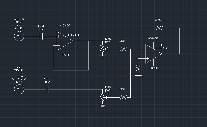

I agree, but in this partticular design, effects stage is implemented as
if it were a pedal with a wet dry knob, i realized later that i should have
considered putting it at the power stage, but i left it as is, theres no
reason why it shouldnt work.
And there is no reason why you need a mixer at all, your effects
has one, wet is effects, dry is the guitar, your overcomplicating.
Set up as pedal, a multi-effect also completely replaces the
amplifiers input channel, which should be set to clean and
simply left there, input distortion is not good post effects.
rgds, sreten.

That's a good point. Even in this circuit, I can probably scrap the pan/mixer pot and just adjust the gain of the effects by adjusting the input resistance of the op amp right?

I understand your point, no mixer and put the output of the microcontroller before the power section. I thank you for your input.
