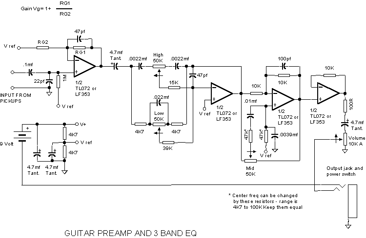

DolbyR said:
Just one question..at first i thought its just a regular voltage divider in the circuit, by now that i start looking better at it, it doesnt exactly look like it...where does the the battery's [-] pole connect? just through a switching jack to ground?
Yes, through the jack to ground, so it switches the power ON when you put a plug in, it's standard practice.
You are also correct in your thought that it uses a simple voltage divider to give a split supply, the two 4k7's.
DolbyR said:
thanks for the quick answer..
i'm still not advanced in reading schematics, but from what i understood, only half of each of the 4 opamps in the 3-band version is used...am i correct? a TL071 would work as good then too?
It would, but the original circuit only used TWO eight pin chips, each with two opamps in! - this is done to save space.

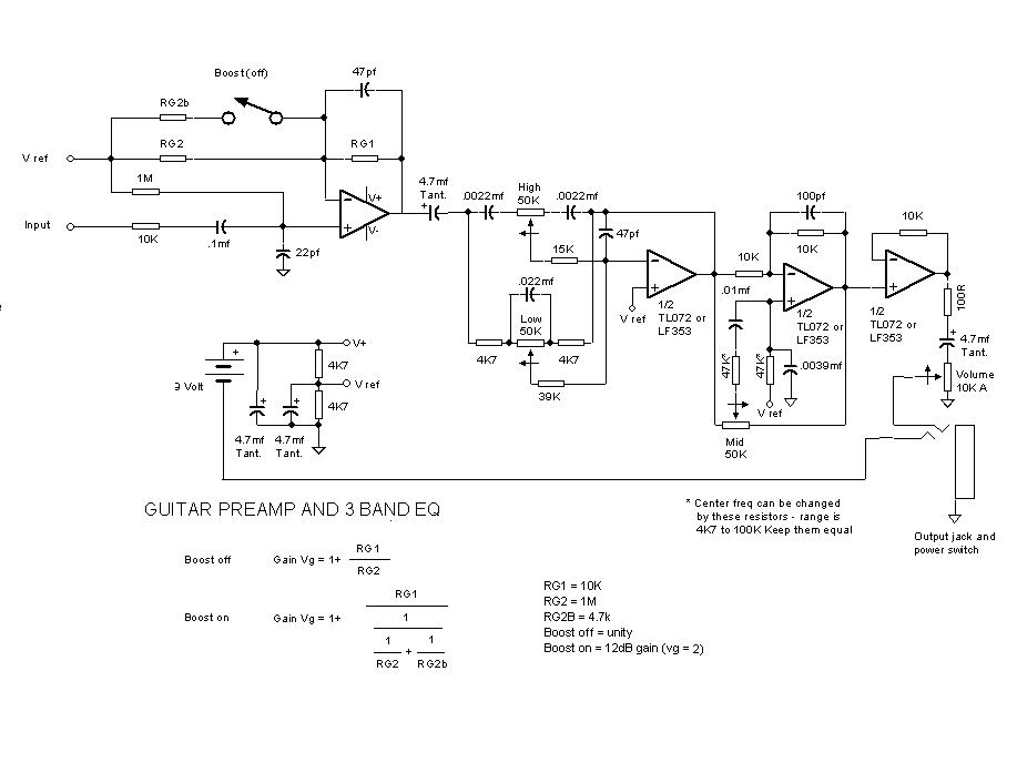

Hi All
I have built the three band version, with boost switch. Brion55 is absolutely right; you do NOT want to switch the feedback resistor. You can, but the resulting bang could cause serious damage to amp and hearing. Fortunately, I tested on very low volumes (always wise, I find) and before I could even post a question about it, Brion55 had posted the answer.
I squeezed the whole thing onto a bit of veroboard 25x17 (because of space restrictions in the guitar) so there are some pretty major contortions, but it all works pretty well.
The boost equation provided a little more than I wanted, so I changed RG2b from 2.4k to 5.1k which tames it a bit (from vg=4 to vg=2ish). But now I think it may need just a tad more, so I will go with a 4.7k in future versions.
Boost switch is via a push/pull DPDT switch on the volume pot, and is smooth as you like (no amp breaking thumps)
I also could not find a .0039mf cap, so I used a couple in series to get to the same value. Works fine.
There were some serious issues with buzzing if everything was turned up full, but these seemed to resolve themselves before I even got round to troubleshooting the earthing issues which seemed to be causing them. It is now a quiet circuit with a wide range of tones available. Thanks to everyone for all the help and advice.
Cheers.

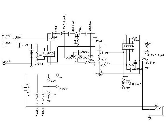

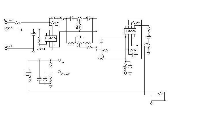

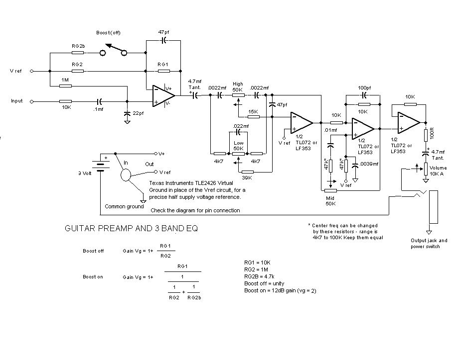

Could somebody check this schem, if it looks correct? ive already almost finished the preamp according to it...it should actually be same as brions original "big brother". Just what i'm wondering is, i suppose v+ and vref should also be connected to the opamps, on the chem nothing is now connected to v+/v-...should it be connected to both opamps or only the first?

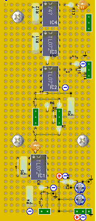

DolbyR said:
Finally get to test te preamp, but no sound whatsoever so i guess i´ll just "freeze" this project for now. its built on protoboard so even troubleshooting will b too difficult.

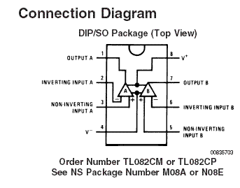

Hi DolbyR according to Scummer's mod you must feed the opamp with +9v (pin 8) and -9v (pin 4), you are probably connecting +9v (pin 8) and common ground (pin 4). I simulated it in Multisim 9 that way and heard no sound. If you have Multisim 9 you can record a 10 sec. sound sample (from your guitar or bass) simulate it and then hear it to see if it actually works, before breadboarding. This tone control circuit is great. Best Regards.
Have a look at this Tl082 opamp diagram, I think it is very clear to understand, if the 3 band tone control circuit has 4 opamp symbols, you will use just 2 dual opamps like the Tl082 or the Tl072, for this opamp (and most duals) pin 4 is V- and pin 8 is V+, if you are going to feed both opamps with 9v you will have to use 2 9v batteries, connecting the "A" 9v battery positive terminal to "B" 9v battery negative terminal and this node to Common Ground, then feed the opamps connecting "A" battery negative terminal to V- and "B" battery positive terminal to V+.
I simulated the same circuit using 2 Tl072 dual opamps and with 2 Tl082's, I used a cheap Yamaha 4 string bass, and the preamp gave it a full bodied sound with lots of presence.

DolbyR, (sorry I misunderstood your explanation!) I have tested the circuit with just one 9v battery, as you know feeding opamps this way works (connecting +9v to pin 8 and common ground to pin 4), probably you damaged the opamps when you tried to figure out how to connect the supply voltage.
I also thought about a way to minimize hum, replace the Vref circuit for a single TLE2426 IC (The Rail Splitter Precision Virtual Ground) it not only saves space! (1 tiny 3 pin IC in place of 2 electrolytic caps and 2 resistors) this IC's output voltage is always equal to one half the supply voltage!
Also remember the star grounding method to minimize hum, I think you get more presence with TL082's, but its just a matter of taste. Regards.
