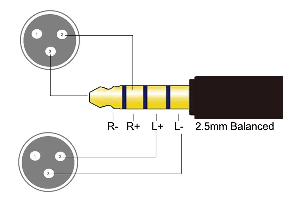

I've got a dac with a balanced 2.5mm output. It's very hard to located a cable for it that outputs dual xlr.
I'd like put together a cable for it, just need to figure out how it's wired up?

it's a trrs headphone out to dual xlr
like below -->

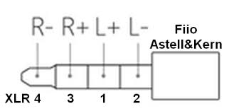

Balanced output diagrams for Sabaj da3
Would like to DIY a 2.5mm jack TRRS to double XLR cable for my Sabaj Da3 on the balanced output.
No information in the package of the DAC, nor on the website.
Not quite sure about the output diagram pinout.
Are all the chi-fi the same? Fiio, Sabaj...?
Is someone here, who knows the diagram of the balanced output???
from Tip to r1,r2,S:
R-R+L+L-
or
L+R+L-R-
Thank you.

I have just spotted your post saebasan. Better late than never!
The diagram in post #11 would support your first suggested sequence.
I would assume that this is the standard sequence.
