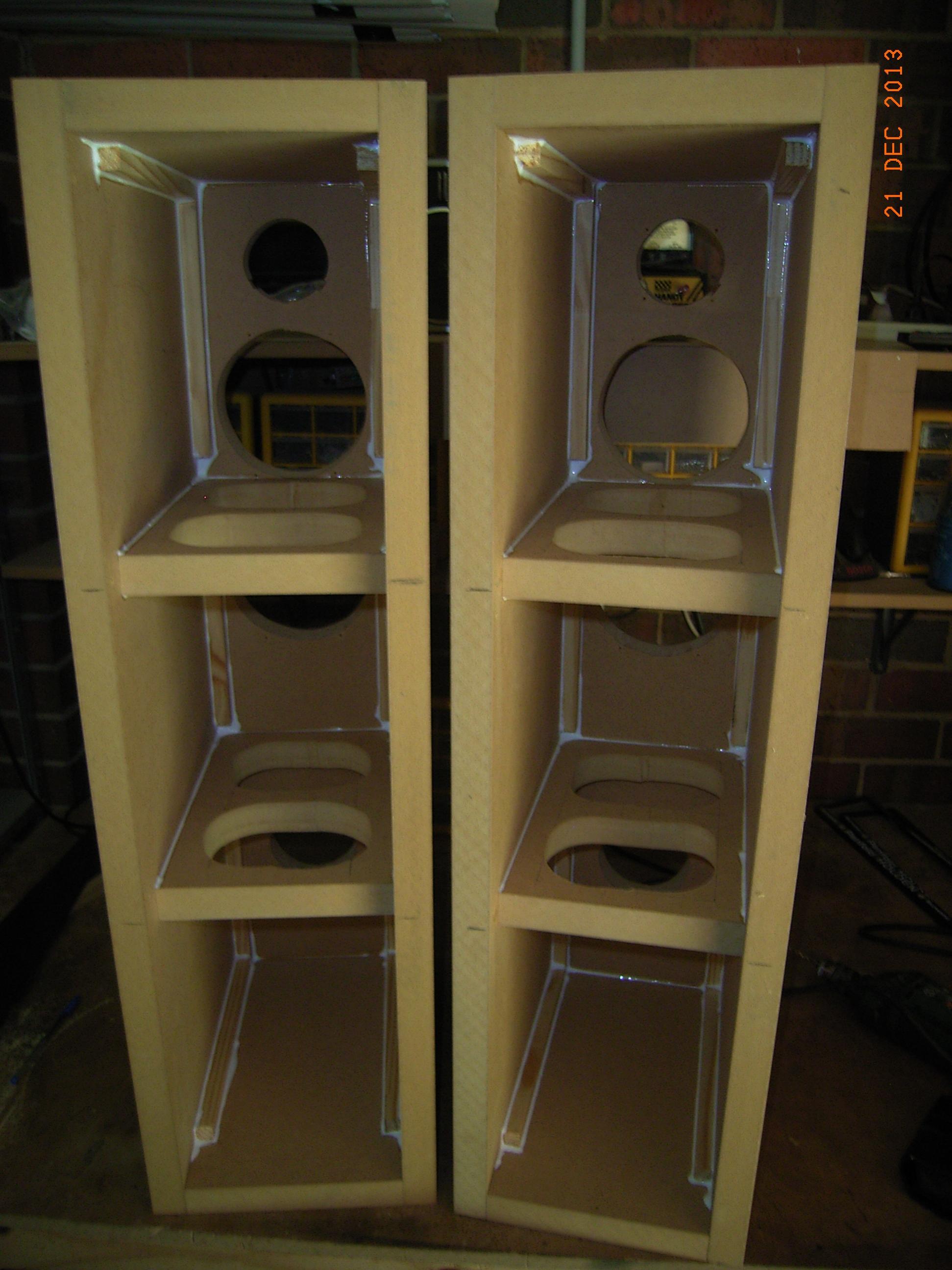

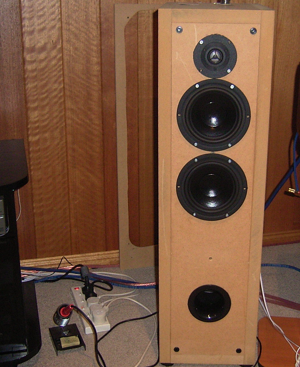

Well, its been a while.
I ended up building these only last month, used very similar dimensions to what was in my first post.
I'm using four M18 woofers (the PL's were too costly in the end) and two D25AG tweeters. Yes, I considered the Vifa XT's but I really do like the D25's sound and I already had a spare pair of them anyway.
BTW: all the drivers are the original Danish made ones. 🙂
They sound very good to my ears, but the crossover is still unfinished.
After a lot of playing around, its currently:
3mH LPF on lower woofer
0.82mH LPF on upper woofer
5.6uF and 0.47mH 12db/oct HPF on tweeter, then an L-pad (1ohm in series and 12ohm in parallel)
So far so good.

The only change since last post is a 4.8mH on lower woofer now. (up from 3mH) Much much better.
Still playing around though.
Here's some pics, I didn't take that many 🙂
All panels are 32mm (1.25") MDF.
Still unfinished as you can see.
They certainly are solid, and heavy too, they weigh nearly 40kg each.
