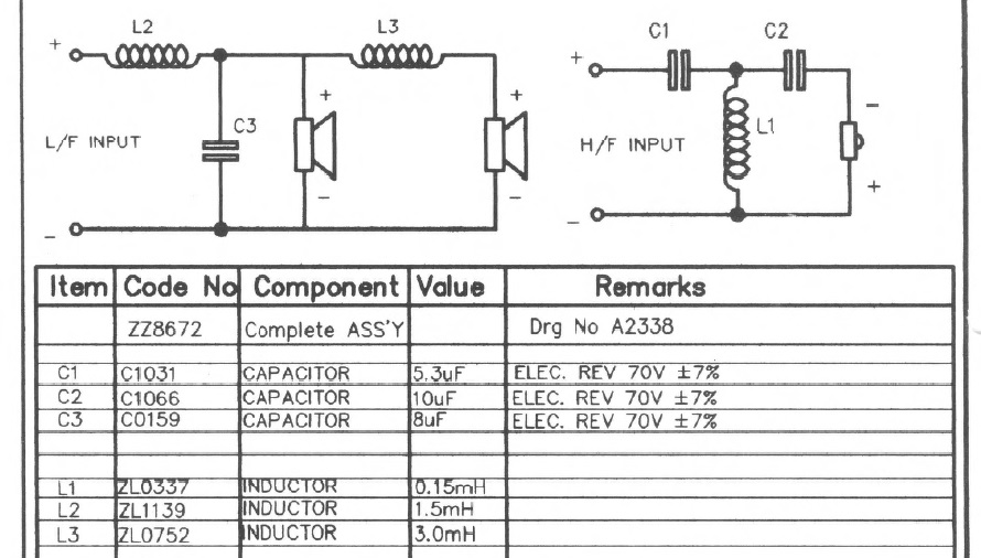

As I understood:
Version 1: The left woofer got a 12db/octave 2nd order by the L2, C3 and the right side woofer got a 6db/octave L3 1st order filter and the woofers work independently from each other? Am I right?
Version 2: If the L3 coil wasn' there both woofer would get the 12db/octave filter. But what happen if we put the L3 coil there? This I don't understand...and how can we get here 3Khz for the left and 400Hz crossover points for the right woofer?
Thanks.

Now I understand it clearly. Thank you so much the info.
It means the 12db/oct filter has to be calculated for 4 ohm impedance and for the other woofer that I want to slopes down much lower in frequency with 6 dB/oct (1st order) need calculation for 8 ohm?

Following on from my dumb post earlier( not reading the thread through) I found this series 2.5 way schematic. Re bsc how would it differ ? http://www.lcaudio.com/index.php?page=26
Following on from my dumb post earlier( not reading the thread through) I found this series 2.5 way schematic. Re bsc how would it differ ? L C Audio Technology / Series Filter
In that case, the .5 way is parallel and should give a full 6 dB, while the 2 way is series. Kind of the opposite of what I did. I could get more BSC with just a bigger inductor, as usual.

I believe the 2nd pic is called a cascaded 2.5 way. The theoretical problem with X.5 ways is that rolling off the .5 driver will cause it to deviate in phase from the other woofer. Personally, never heard that as an actual problem probably because it is rolled off by the time the phase difference becomes significant.
Not quite correct:I'd love to know how.
Double the drivers, gain 3 dB,
Double the impedance, deliver ½ the power, lose 3dB.
Net gain, 0 dB.
dave
Double the drivers (hooking two identical drivers in parallel to an amp vs. just having a single driver) = +6dB
Wiring drivers in series = 1/2 the voltage per driver = 1/4 the power per driver = -6dB on each driver.
Total = +6 -6 = 0db.
It still serves the purpose of creating baffle step by attenuating the midrange 6dB compared to the bass and if wiring two 4ohm woofers in series you still get +3dB overall sensitivity compared to a single 8ohm woofer because you're putting the same amount of power into twice the cone area.

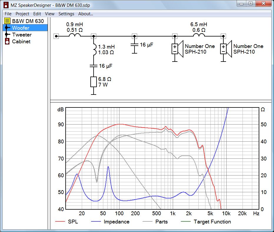

I lstened with John both the B&W DM-630 where the bottom woofer only goes til 160Hz and also the DM-630i version where the bottom woofer goes until 400Hz. The 160Hz version: the vocal a bit narrow, the bass is not strong enough, missing the pounchy, the tweeter looks so much, too much by quantity.
The 400Hz version: Much tighter bass, full bodied vocal, optimal tweeter, has a huge ambient, big soundstage. The bass not pounchy at all, optimum level. All the frequency is perfect and fantastic to listen to it, I got a shock how very 3 dimensional.

Ahh I reread your post and see your way of thinking now. You're thinking in power and I'm thinking in voltage per driver 🙂Series is +3 dB for 2 drivers. -3 dB as you are drawing 1/2 the power of a single driver.
Do you mean for the circuit in post #5? That one won't give any baffle step. The purpose is that the two drivers share the work of producing the bass which has the effect of lowering cone excursion and therefore distortion. At high frequency the capacitor bypasses one of the drivers and the other driver does work at full power. So it transitions from two woofers in series to just one woofer with the other shorted.So potentially you do see a +3 BSC ?
Which is about right for most rooms
If you want baffle step in series config you need something like this:
R1 and R2 represent nominal 4ohm woofers. R3 sets the amount of baffle step. If R3=R1=R2 you get +6dB bsc. If you lower the value of R3 then driver R1 plays louder in the treble achieving a smaller amount of BSC. C1/L1 need to be adjusted to achieve smooth frequency response after changing R3.
Honestly the only case I'd consider using a topology like this is if I wanted to use a pair of 4ohm woofers and needed the design to be nominal 8ohm at bass frequencies. Anything less than full BSC and the impedance will still head towards nominal 4ohm at higher frequencies however.

Here's the DM 630i you like:
Here's the 630 that you don't think so much of:
I don't know if the drivers are the same. But both that famous old negative polarity BW3 design.

We think that absolute they are the same woofers. Only thing is that the foam design around the cone is different on the top surface nothing more, it means are the same.
Can you tell me that the L3 coil influence the left side woofer in sound or not?
If yes, how? I mean in the 630i version. Thank you.

You could take L3 (3mH) out altogether on the 630i. You then get a slightly louder 400Hz to 3kHz, but hardly a biggie. Perhaps L2 should then be about 2mH for the same balance. But the woofers are then working together for the big PA farfield projection that characterises doubled woofers.
