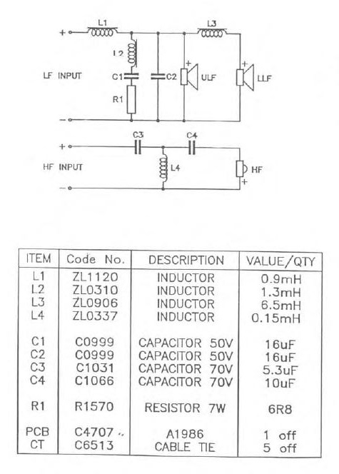

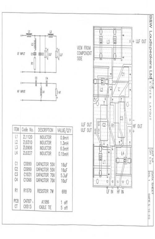

Hello everybody,

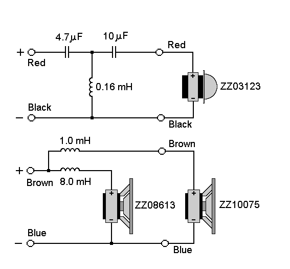

There is a B&W DM-630 speaker at my friend and has to be replaced some parts. I can see that has strange 2.5-way crossover design.
I know that the 2pcs 8ohm bass are parallel with each other and can sound differently?
I also found another 2.5-way crossover design but look little different.
Can somebody explain me how they works and what is the different between them?
Appreciate,
Carlos

Hi Carlos,
There are two differences. One is electrical. For an introduction to crossovers please see my blog post here.
To learn about this design, you should try to simulate it using XSim, here.
The difference happens because of the difference in the value of the coils that go to each woofer. Plug them into XSim (select the coil, then Tune, then increase the impedance value). Use the Frequency Response Graph, and select both of the woofers.
The other difference is the difference in the two woofers. The woofer with the 8uH is probably lower Q and lower resonant frequency than the other. We'd need at least the Thiele/Small parameters (T/S) to better understand the woofers. Also, it's possible if the woofers are different that only one is ported, and the other is in a sealed cabinet.
If you still have questions, please ask then! 🙂
Best,
Erik
There are two types of parallel 2.5 way. One has only an inductor in series with the
lower driver. The other has the midrange low pass network in series with both drivers
and then the lower pass inductor in series with the lower driver.
The latter is generally better but at the cost of double the current in the mid crossover.
rgds, sreten.
Not common is the series 2.5 way, but FWIW it is another type.
Thank you for the help.
For me the second design where the 1mH and 8mH coil is in series with the woofers is simple, I understand, its a 1st order network. Here means all the 2 woofers give the same bass frequency and where the 1mH coil is give some midrange too until the tweeter. This is clear.
But how goes at the first one? There is a 2nd order crossover that rolls-off both woofers and give midrange for both at the same time. After the L3 coil series with the right woofer rolls-off again to get only deep frequencies for the right side woofer? If I understand it in a simple way...🙂 It means the right woofer get rolls-off twice? Funny...

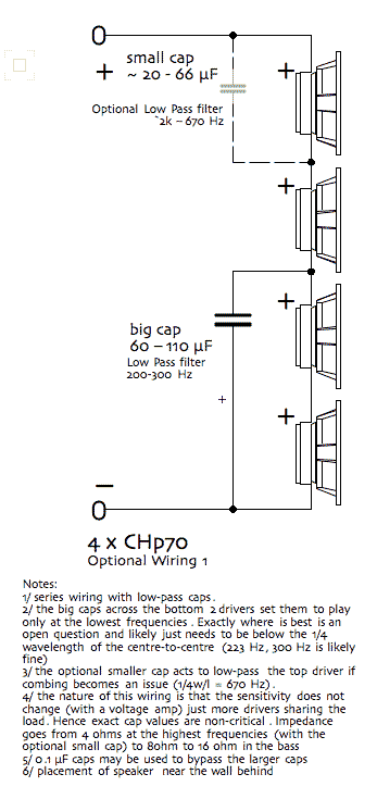

We have extended the concept to 4 drivers… not sure what you'd call it. 0.75-way? (details specific to the box designed)

B&W Group North America Service & Support - Home

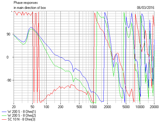

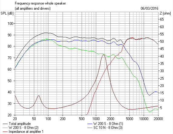

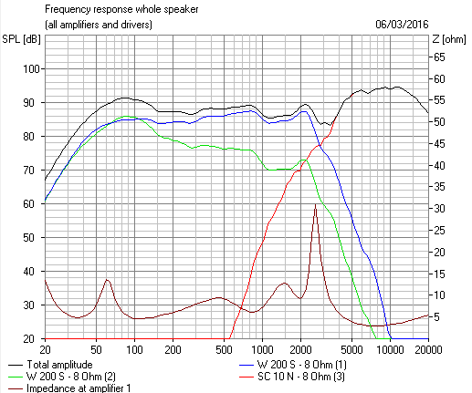

The B&W DM 630 filter is your typical 2.5 way where the basses double up to provide 6dB bass boost or bafflestep at low frequencies. This is not the sort of speaker you want close to a wall. It sits in the middle of the room. You may not hear the bass boost, but your neighbours will. It will thump away for them. The LCR is a 1.3kHz deep notch that must work with the polycones.
A rough sim below. Not as bad as it looks, because I could rapidly tidy that up for my particular drivers. B&W use 8" polycones AFAIK, and metal tweeter. Horrible low impedance, of course.
Also below and last is the sim with just the 1mH and 8mH bass coil on the two woofers. Ridiculously bassy sound. Forget about it. 😀

I've done a couple series 2.5 ways. To be honest, don't know how they provide BSC. Perhaps something to do with the power draw? The bass tapered frequency response of the GR 165X's help. Going to revisit that crossover. Four of the Dayton DS135's sounded thin but adding the 5th seemed to work.
This gets a little weird - DIY • Canuck Audio Mart Hifi and Audio Forum
Plastic speakers - DIY • Canuck Audio Mart Hifi and Audio Forum
The additional driver rolls off around the point of baffle step loss depending on width of baffle
