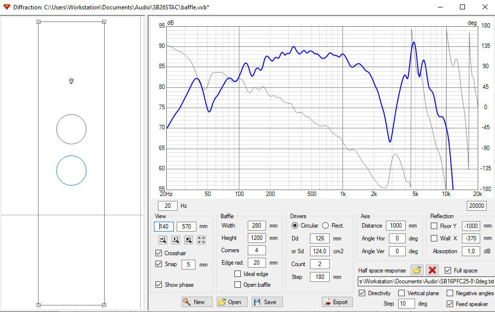

Imho, just a quick look you should be in the woofer usuable bandwidth nearer to 89 dB/2.83V if I look at that : http://dibirama.altervista.org/home...s-sb16pfc25-8-mid-woofer-6-8-ohm-80-wmax.html (not saying measures are perhaps made on a big IEC baffle, so less than 89 dB in real life on your baffle)
I added + 3dB because you double the driver surface but with - 3dB of baffle step which is an average value, you land with around 89 dB at the baffle step transition... more or less according the width of your baffle.

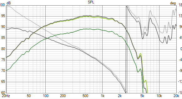

Yes, +6db.my vituixcad give me +6db for midwoofer parallel 2x8ohm? +3db electrical +3db radiant surface.
And then full baffle Step loss is -6db, although depending on the woofer placement and the room you may only need 3db to 5db compensation.
Spec sheet says the driver is 87db but diyiggy's post looks more like 89db. So in the end you MIGHT be able to get by with an 87 db tweeter but could also end up needing as high as 91/92db. You could get the woofers and build a prototype box and know for sure and then select the tweeter.
stupid me, yes +6 dB sensivity I mixed up with + 3dB efficienty ! +6dB spl, ok 🙂
Imho Dibirama measurement are IEC baffle, so 89 dB for one driver in optimistic... it is less on a 20 cm width front baffle. And has the driver natural drop below 200/300 hz where the energy of music (snap/prat) is important (80-200 hz), your 87 dB after EQ should me more accurate... but dunno (rooms decides below Schroeder frequency and you may place the speakers near the wall maybe) !
