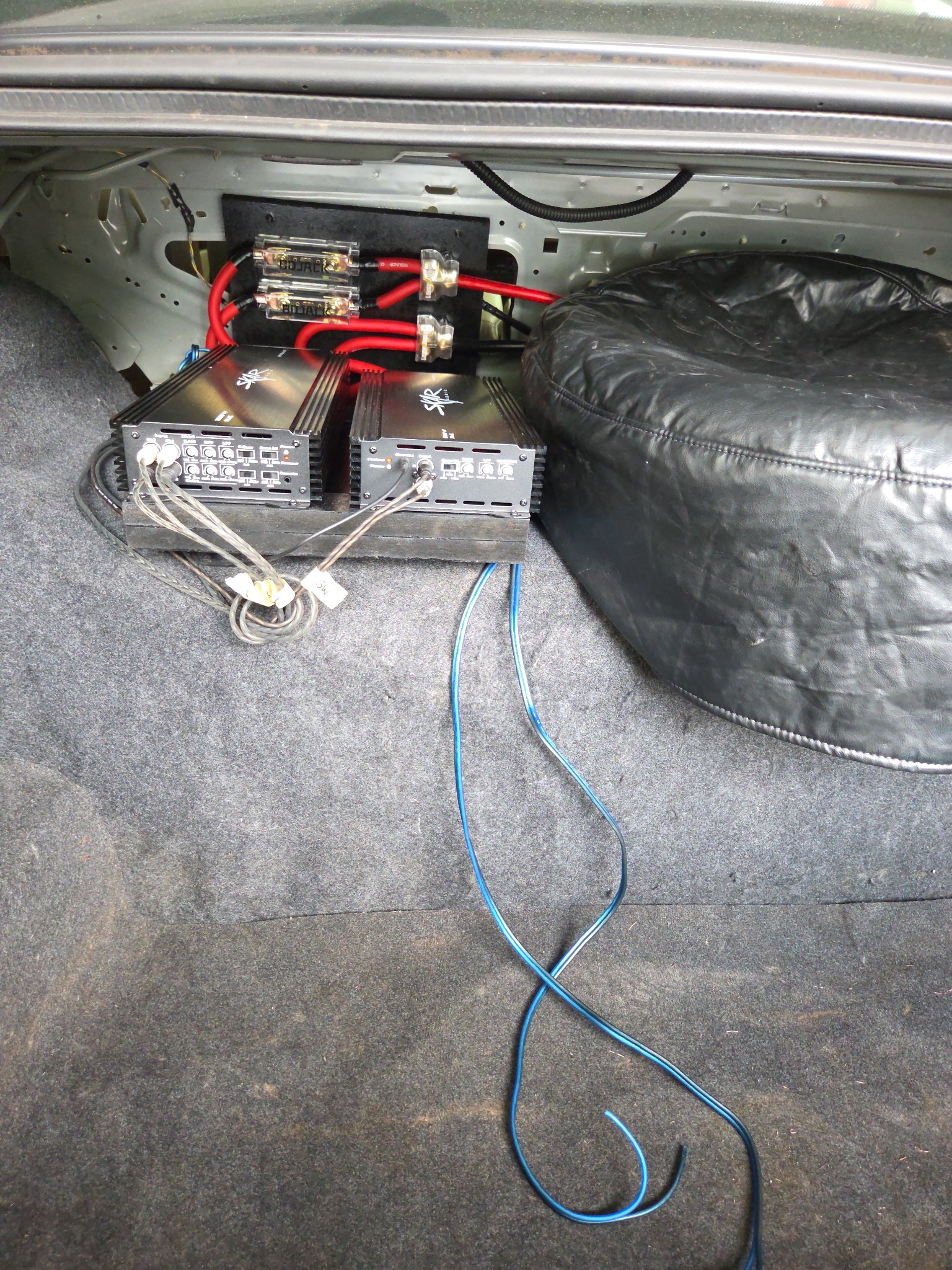

I am debating the relayed fusebox location. I have room next to my battery, but the box I got isn't waterproof so would prefer to have it in the vehicle. To power little things like interior accent lighting, underglow, dsps, etc. I was going to have it under the passenger seat as the lx1300.7 takes up pretty much the entire driver side unless I got cheeky with it. Which I might. But under the passenger next to a small amp with the pucks makes more sense.
The rear Hatchback section has some pretty hollow sounding panels, I might get lucky and find space behind them for a dsp since they aren't too thick. But I have yet to confirm that until I'm ready to rip it apart and sound treat. Would be pretty long rca cables then, I don't know if that would pose a problem.

Then again, and lc7i plus the small ds18 dsp seem pretty small, might fit nicely back there. I'll mock up a plate fixture for under the seat and see how well everything nests in CAD. Might have room if I did something like that.
As long as the cables are decent quality, they're run intelligently, and the head unit has good output levels, should not be a problem. Rear-mounted amps and DSP are common in larger systems.Would be pretty long rca cables
