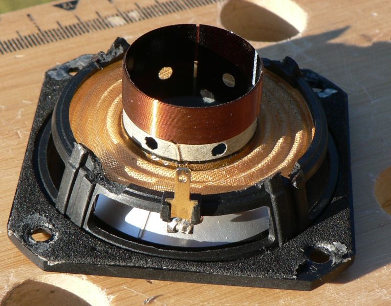

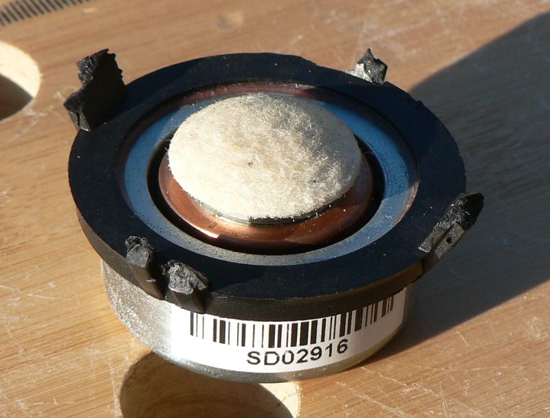

+2 and see pics for reason why as it's built like a tweeter. SB65WBAC25-4 is an excellent option for micro speakers (vented or PR) but for a few dollars more I do prefer Vifa NE95W-04 but that needs 2-3 times the volume which eliminates it for micro use.
