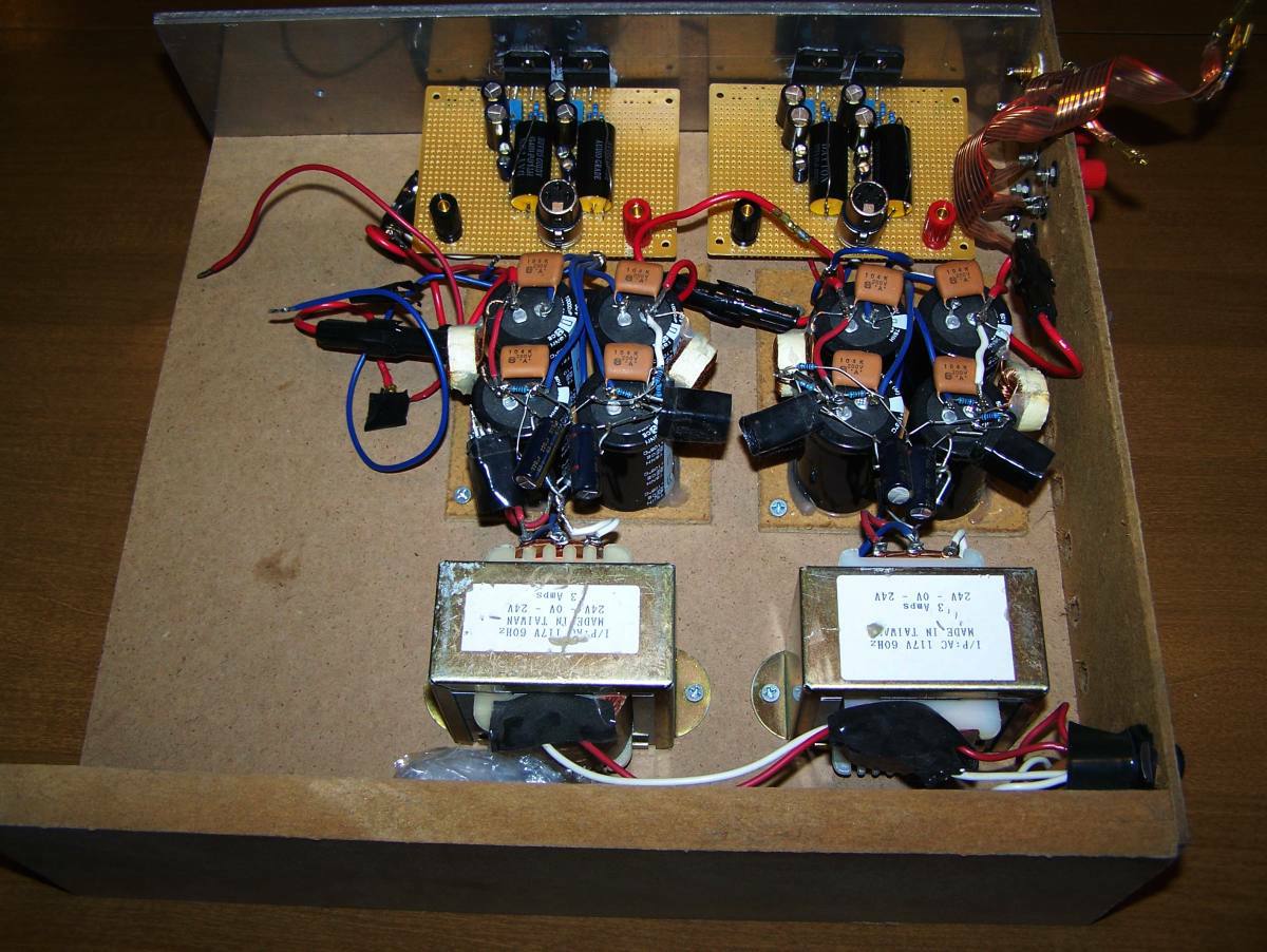

A transformer with 25V AC seconday outputs will give you 35V DC rails (25*1.41). It is an easy mistake to make.
U got me confused there 😀
Well he's talking DC voltage... not the same thing to use when shopping for transformers. LOL
Most 8 ohm speakers are closer to 6 ohms minimum. So the transformer I linked to IS what you want.
ok thx for help guys, I'm a bit of a newb and this is just my second amp I've ever built! first one was lm1875 and I'm my self in grade 12 🙂 yes high schooler...

But when you say BA100 do you mean BR100. like in 2 modules in bridge mode? that is what i understnd from images. not 100% sure what you mean with bridge/balanced
BR 100 - lm3886 - should only be used into 6ohm load when using +-24 DC powersupply else chips are overdriven. they both effectively see 3 ohm loads
BR 100 - lm3875 should not be used in loads lower than 16 ohms with supply +- 35V
might be fine for slightly lower load (12ohms) resistance with your +-29V supply but nothing CLOSE to 6ohms.
lm3875 is limited to a MAXIMUM of 5 amp.
For BR100 lm3875 using a 6 ohm (average) load each lm3875 will effectively drive into 3 ohm loads which is NOT adviseable for best THD and longevity. BAsically they would be permanently very close to SPIKE current and temperature protection even at lower volumes.
Please note page 4 for voltage and load table for parralel and bridge modes using lm3886.

BA= bridge amp, as in BPA with out the P. I didn't bother with the two parallel chips as this was just a test. Built point to point. BR? what ever you call it. Just a quick test circuit to try them bridged since I have a balanced source so no need to create the balanced signal with a diff amp or DRV134. A successful test. Two chips sounds way better than one. Four will be better than two. That's why I am recommending at least BPA200 with a balanced source for the 3886/3875. I never told anyone to build BR100.
