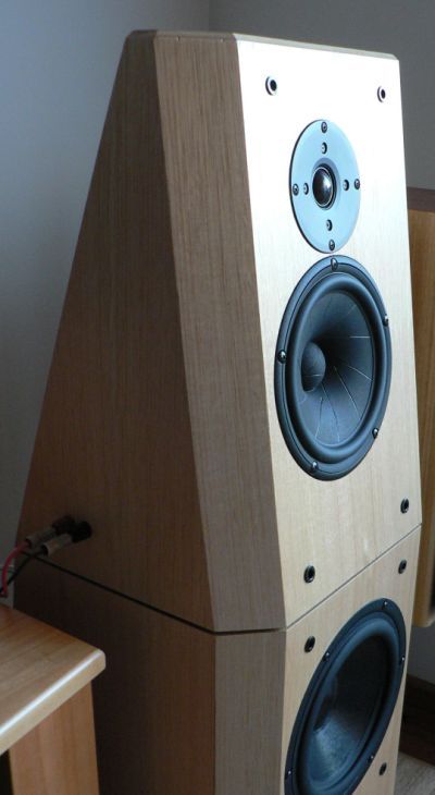

I've tried using XLS drivers (crossed over low) with a 2-way as well as on 3-way and preferred the use of woofers and not subwoofers for music. Drivers such as the old Vifa M22WR, M26WR and the newer SEAS CA26RFX spring to mind.
There are those who do like the use of the XLS drivers but most I have seen are used in OB.
The speaker in the pic uses the 18W8531 with a M22WR-09-08 in a 2.5 way arrangement even though it looks like a 3-way.
