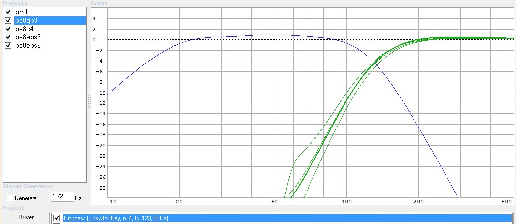

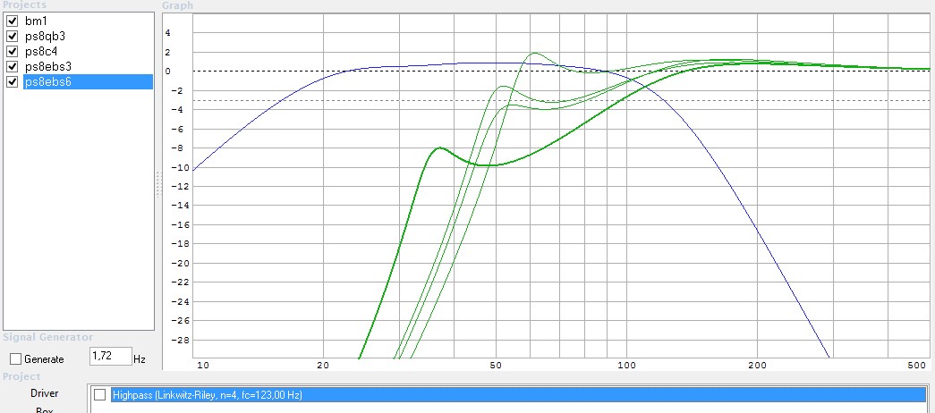

I have two questions after running a few simulations on WinISD:
What crossover frequency would be a better choice, given that the excursion of mid woofer is over the limit at 200 Hz with 70 W applied? (Speaker parameters: Prms = 100 W, XMAX = 1 mm, linear XLIM = 2.5 mm)
If I set the XO to 123 Hz, XMAX peaks at 2 mm;
If I set the XO to 150 Hz, XMAX peaks at 1.5 mm;
After enabling the XO in WinISD there seems to be almost no difference between box sizing. Next photos should illustrate what I mean:
So does this mean that I can ignore the XO and simulate the box with XO disabled OR there is no difference what size box to choose?

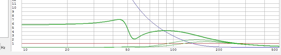

After whole day of simulations I have decided to build 2.5 way system out of it. Main speaker would go down as low as they possibly can without over excursion, to achieve this I will add a shelving high pass filter or a Linkwitz transform with -8 dB gain. I could use some info about shelving filters or other bass cut/boost equalizers.
I presumed that main speaker box will be based on Chebyshev alignment, this way frequency rolls down rather nicely with limiting filter enabled. Does this tuning frequency looks right to you?
I would like to hear from you guys what you think about my idea.

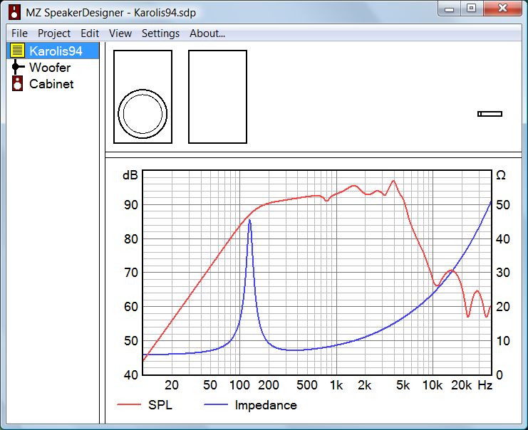

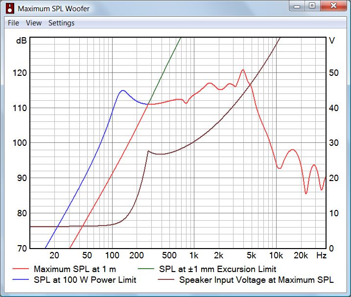

The woofer actually seems to be a classic PA midrange driver where Xmax limits the maximum SPL below 250 Hz. Unfortunately there's nothing you can do, a vent doesn't help at all. My advise is a closed box of 15-20 liters and a crossover frequency of 150 Hz. 1 mm excursion gives an SPL of 99 dB at 150 Hz, that's certainly at the limit, but I assume and hope it does work in practice anyway, unless you listen very loud. 2.5 mm excursion gives 107 dB. 🙂
Attached my simulation results including baffle step. Impedance and frequency response of the driver is unknown (estimated).
