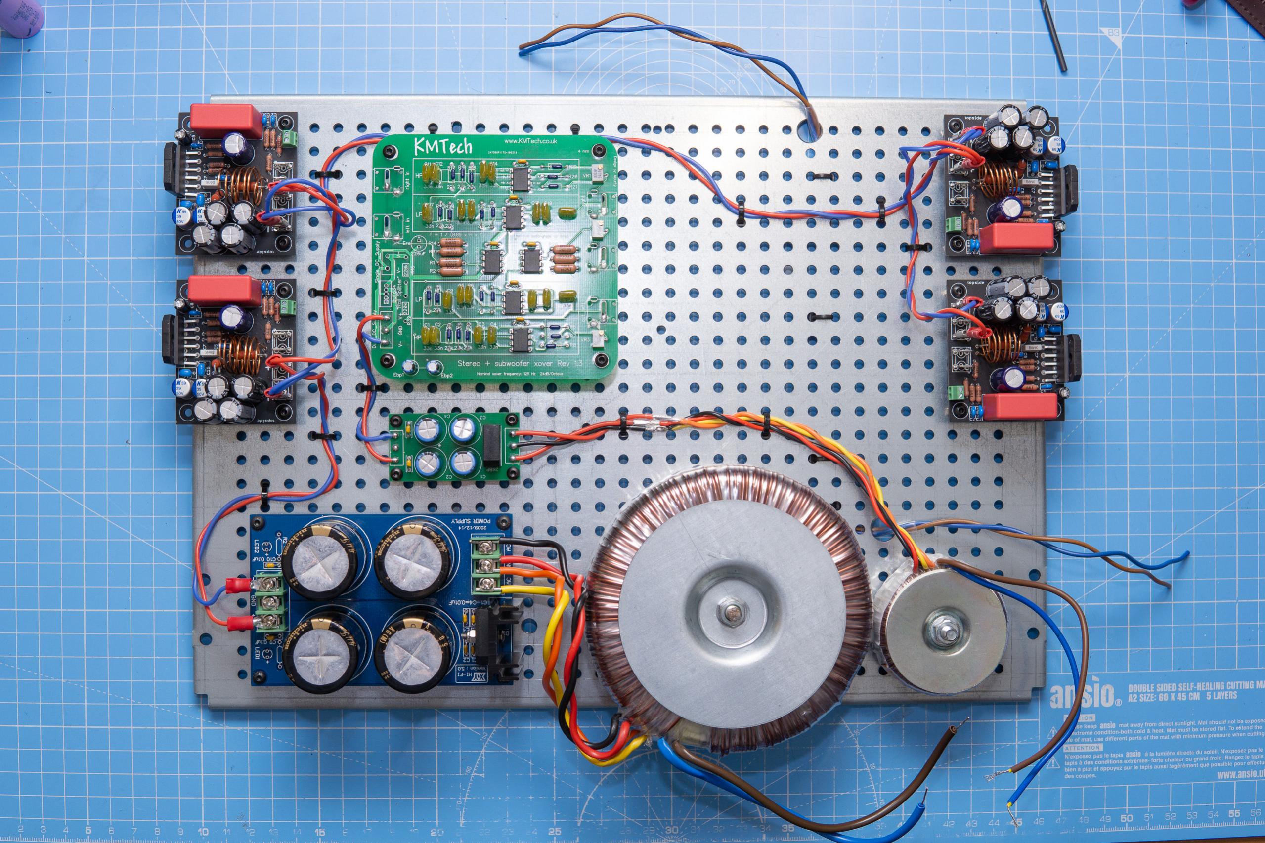

I'm making very slow progress on my 2.1 channel LM3886 & have reached the point where I need to work out the grounding. My previous 2.0 channel LM3886 was essentially permanently ground lifted so I didn't go through this process.

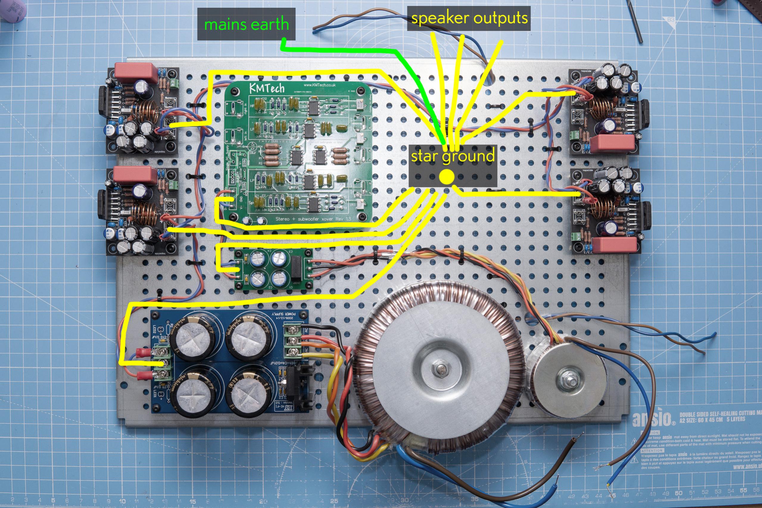

Following the diagram & explanation toward the bottom of this page I think what I need to do is shown in the attached images of my build so far.
Am I on the right track? If so, what is the best physical way to achieve this? Trying to stack 11 crimp connectors onto a single bolt is going to end up a mess, but presumably I can double/triple up wires to crimps?
Also, if I am using shielded cables for the line level inputs to the amps, what should I connect the shield to (if anything)?

I think that your 2.1 system will have subwoofer amp bridged, so tehre is no speaker ground for it.
A I correct, if Yes, then you should have only 2 speaker grounds for L & R speaker and for sub you will have wires directly from LM3886 modules (one positive output as +speaker terminal and the other one from positive output as -speaker terminal).
In general your star point is correct.
Maybe in future you will lift your star point with ground lifter (many times suggested in this forum). Mains earth will stay on the metal part of the chassis and star point for all the modules will be on ground lifter side.
Daisy-chaining the power connections like that is a bad idea...each amp needs to to be connected to the power supply separately. All wires have resistance, and the amps down stream from the others will be prone to voltage modulation of the power due to the amps up stream drawing power ahead of them in the circuit. So in effect, what you have there is one amp connected directly to the power supply, the next amp is connected to a power draw through a small value resistor, that amp's power will be affected by the first amp, the third amp will connect through the second amp and the first amp through yet another resistor and will be affected by amps one and two...and even worse for amp number four.

I would second both Michael Bean and scottjoplin suggestions.
1. Do not daisy chain power. Bring the power to each amp pcb by a twisted triplet (v+, gnd, v-). Same for the crossover board.
2. Twist the output wires together (speaker out and gnd out) and connect them to the amp pcbs.
3. On the input side, use insulated rca jacks, twist signal and gnd together and bring together to the crossover board. Also use twisted pair between each amp pcb and the crossover board.
4. Ideally, I would use two ground loop breakers. One between the gnd of the amps power supply and the chassis (earth) and one between the crossover power supply gnd and the chassis.
I'm not quite clear on what you're doing with the two amps for the sub. Are you using them paralleled (with a 4ohms driver) or bridged (with a 8ohms driver) ? In the first case, you'll need an inverter before one of the board. In the second case, you'll need high wattage, low value sharing resistors at their outputs. It would also be good to use well matched gain setting resistors.
I will redo the wiring individually.
But should gnd to each amp not be coming from the star ground, rather than from the power supply board?
Same question, if my speaker ground is coming from the star ground rather than from the amp PCBs (as in the DMS Audio link in the first post)?
What about the shield of the cable? Should it be connected to anything, at either end?
My intention was to parallel them because it's a simpler setup & because the Neurochrome pages recommend against a bridge setup with 2 chips. So I built them with 0.1% gain setting resistors, then was going to measure the DC offsets of all 4 & parallel the two that are closest, through some 3W 0.1R resistors.
However looking into it more now, with my +/-28.5V supply rails & 8Ω sub I will only get ~50W in parallel & it appears that the recommendation against bridging two chips on the Neurochrome page is actually down to the fact that the setup wouldn't support 4Ω operation & would limit supply rails to +/-28V for 8Ω operation. But both of those things are fine for me & would give me a good bit more than 50W.
So is there a simple, community-favoured design for a signal inverter, so I could run a bridged setup instead?
The myth of star ground has really grown legs. Perhaps because it's easy to visualize. However, as you've discovered, it's not as easy to execute in practice. I would also argue that star grounding in many cases actually results in worse performance, and doesn't solve the problem it was intended to solve (ground loops).
So here's the deal:
  • Current flowing through a wire will cause a voltage drop across the wire due to the finite and non-zero impedance (resistance + inductance) of the wire. This is described by Ohm's Law.
  • If a significant current flows in a ground reference for the input or feedback of the amp, it will result in an error voltage developed across the reference net. This will degrade amplifier performance.
  • Some currents are nice and can be allowed to flow in the ground reference. This includes the return current from the input signal. Current flows in loops, remember? So the signal current that flows into the input impedance, must flow out of the ground reference. That's cool!
  • Some currents are not nice as they are heavily distorted. This includes the feedback current. If a distorted current is allowed to flow in the reference net, it will add a distorted error voltage to the input signal, which degrades amplifier performance. So keep that separate - or lump it in with the large currents if you can do so without corrupting the feedback voltage (see next bullet).
  • Some currents are large. This includes the current going to the speaker and back through the speaker return. This also includes the power supply currents (that's where the speaker current comes from). Large currents have the potential to cause large error voltages (Ohm's Law again), so they should be kept separate.
When you buy a PCB, you only have control of some of these current flows. You have to trust that the PCB layout engineer had a clue about these things when they laid out the PCB. Or... You can ask the vendor to provide measurements of the performance of an amp assembled using those boards. A poor layout will show up as degraded THD, especially at higher frequencies (>1 kHz) and high output power levels. Designing a good layout for the LM3886 is not trivial, but not an overwhelming challenge either, so anybody skilled in the art should be able to reproduce the data sheet performance of the LM3886. So compare the performance of the finished amp with the graphs in the data sheet. They should be pretty darn close (or slightly better as is the case for my LM3886DR).
I have long argued (and AndrewT (RIP) before me) that the best ground reference in a single-ended amp is the negative speaker connection. You can see my rationale here: Grounding – Neurochrome
That is actually the perfect example of how star grounding is fundamentally broken. You can see my exploration of various grounding schemes (with measurements) in this thread: LM3886 PCB vs Point-to-Point (with data)
So what to do in your case...
  • Trust the that the layout engineer did their work correctly.
  • Connect the speaker (+) and (-) binding posts to the respective output terminals on the PCB.
  • Connect the supply for each amplifier board with three wires directly back to the power supply. Keep these wires tightly bundled as they contain some rather nasty current spikes when the amplifier is running at high output power.
  • Connect the input signal and return directly to the RCA jacks. The shell of the RCA jack should be isolated from the chassis. You can use shielded wire if you wish, though generally a twisted pair is sufficient here.
  • Connect the power supply ground to the chassis with one wire. That's your system ground reference. If you ever have issues with ground loops, this is the ground connection you lift.
  • Connect the mains protective earth to the chassis with a single short wire. It does not have to connect at the same point as the system ground. The mains earth is for safety. The connection to the chassis should be with an appropriate lug and secured by a lock nut. This connection must never be lifted.
  • Don't forget to cover all exposed mains connections in heat shrink tubing and to keep a minimum of 6.4 mm (1/4") between any metal connected to the mains live/neutral and the chassis. That's a safety thing.
Hope this helps. Best of luck.
Tom

Also, with regards to the ground reference -
[*]Connect the power supply ground to the chassis with one wire. That's your system ground reference. If you ever have issues with ground loops, this is the ground connection you lift.
I have two power supplies; the big one for the amp modules (18-0-18 transformer) & the small one for the crossover board (6-0-6 transformer). Do I connect the ground from both of these to chassis ground? This would seem logical to me from the signal side of things, as the signal passes through both the crossover board & the amp boards

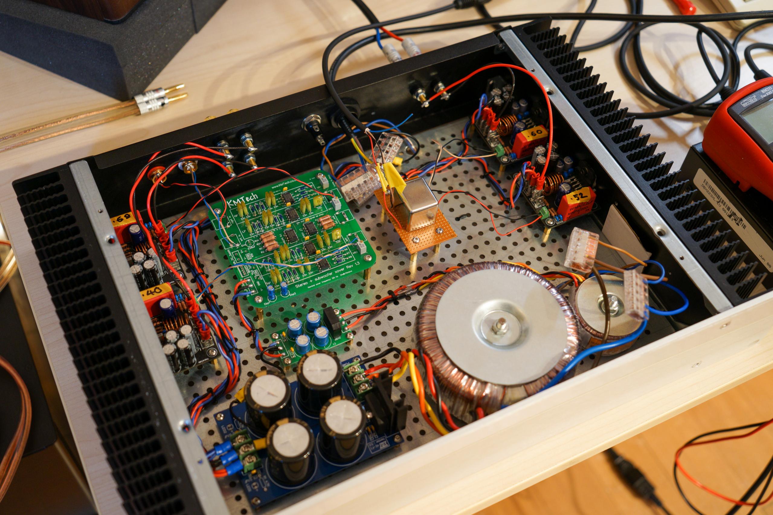

I tried the Neutrik NTE1 but the output from the amp modules to the sub was very low & started to distort really badly as I raised the input level even to only moderate levels. So I ordered the Vigortronix VTX-101-007 to replace the Neutrik part but still had the same issues.
Turns out it's the sub output from the KMTech crossover board which is the issue, as when I connect a low output from my dbx 223XL to the VTX-101-007 the output from the amp modules works as expected - the whole apartment is shaking with nice clean sub.
I can't see anything wrong with the KMTech board, but I think I'm just going to scrap it & stick with an external crossover - it'll give me more flexibility anyway, as I will be able to easily trim the individual channels & also use the amps as regular fullrange amps. I've ordered a new rear panel for the case so I can add another pair of RCA inputs while keeping everything clean. I've had nothing but problems with the KMTech stuff; I've already scrapped both their single LM3886 boards & their parallel LM3886 board which I started this build with...
