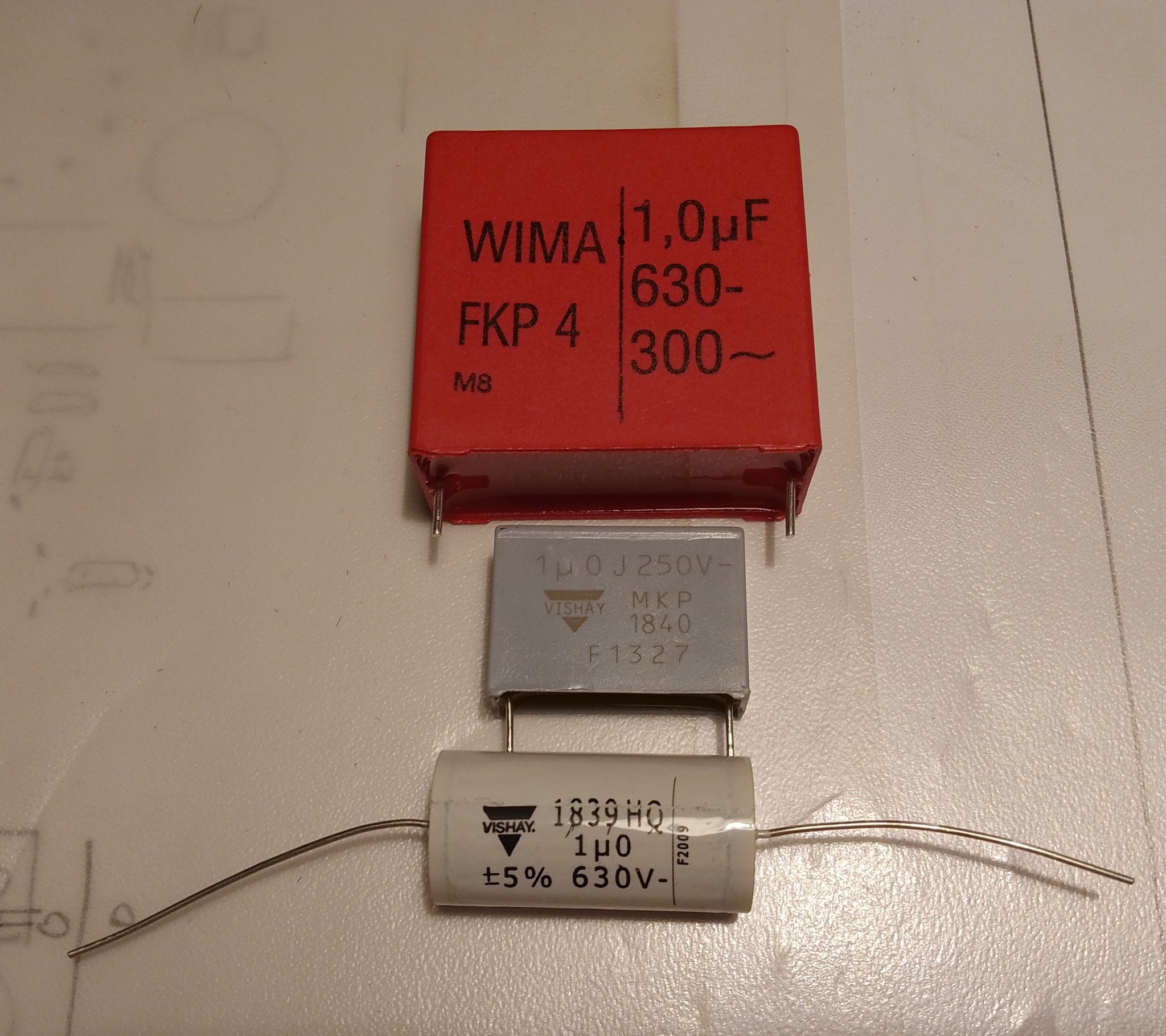

Tube circuit - decoupling with film/foil instead of mkp, I mean series coupling cap between two gain stages or on output of preamplifier.
Smaller values can be used in RIAA eq.
This at least was my reason for buying 1uF / 630 Vdc Wima FKP4 and also for using fkp2&3 in RIAA eq.
Did not compare them yet, so what, if any difference can be had with fkp4 - can't tell.
On the other hand my current thinking goes that project & implementation are much more important than parts used. So buying those fkp4 bricks is for experiment purpose.

Here is the picture, from top to bottom ;
1uF / 630Vdc Wima FKP4
1uF / 250 Vdc Vishay MKP1840
1uF / 630 Vdc Vishay MKP1839
