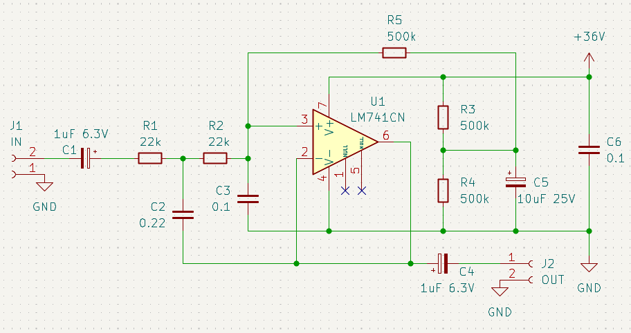

For example, the MFB Low-Pass filter show the "+" input of the Op-Amp, and the input capacitor "C" connected to ground. For use with a Single Voltage Power Supply, both of those connections need to be disconnected from ground and connected to V-Ref. This biases the Op-Amp at +V/2. But this also means that the filter input and output connections will no longer be referenced to zero voltage (Ground). To fix this issue, the input and output of the filter can be coupled with series capacitors.
Apparently it is obvious to him that a resistor is needed. But I didn't understand this until your explanation. So my new version 3.
I put R5 between pin 3 and virtual ground and made R3=R4=R5=500k. It's OK? And please check polarity of C1 and C4. Is it correct?
Thanks!

R3 and R4 can be anything within reason, the original was OK.
They only load the supply. R5 is probably OK but it is a bit large and may cause noise.
Take R5 about 5x to 10x times of R1 and R2, so its impact will be negligeable.
It will only slightly detune the filter.
I would decrease anyway R1 and R2 and increase the filter caps the same factor.
Smaller value R's means lower noise.

Dear OP, try to use a dual supply or do an inverting filter that would leave the non-inverting pin free for biasing purposes.
