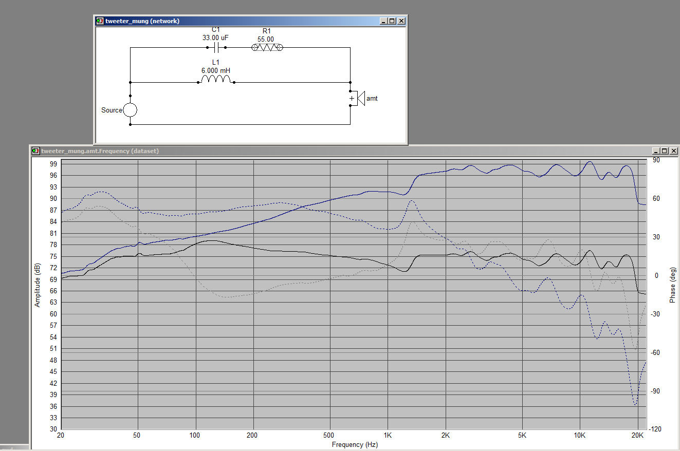

I`m still experimenting but here is a nice comparison so you guys will understand what I`m doing
The red is using 1st order coil crossing, yes, it can be flatter but no matter what value I used after 2Khz~ there will be pretty extreme slope at that treble area and upward.
The black is after i applied the circuit rayma suggested.
green is the response without any crossover

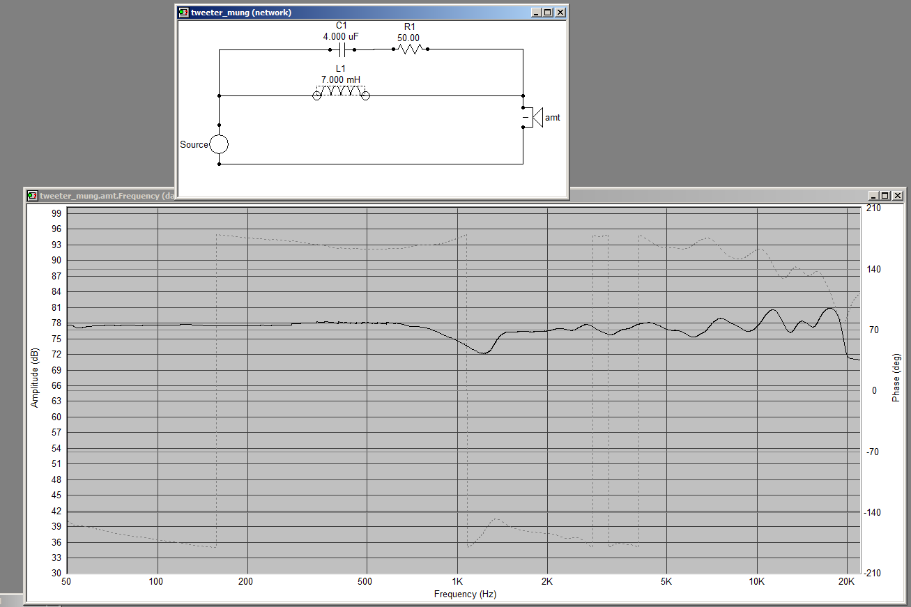

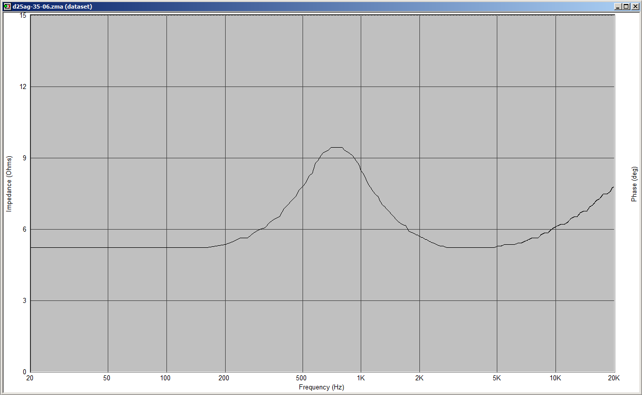

The results will vary depending on the impedance of the tweeter. I used the impedance curve of a vifa d25ag-35-06 it has a fairly low resonance peak at somwhere between 500 and 1000Hz which is actually helping to give that very flat response. I tried with a dead flat 4 ohms impedance and the result is not as good.
The topology should work though. Just the values and the flatness may vary. Do you have an impedance measurement of the driver?
edit: the attached was the impedance curve used which gives the really flat response. Some of the AMT tweeters I looked at from dayton had essentially resistive impedance, completely flat at 4 ohms. If your tweeter is like that then the result may be more like the second attachment which was simmed with a flat 4 ohms impedance.
I did think perhaps it would be possible to insert a tweeter equivalent circuit into the tweeters earth leg to simulate the vifa's impedance peak, not something I've ever tried before, would be interesting to see if it would work....
Might open up some interesting posibilities for response tayloring! I've never seen it done before (possibly for good reason!!). BUT have an experiment with the topology I showed and lets see what results you get.
Basically it is a band stop filter. The coil is rolling off the lows but the cap in parallel with the resistor in series with it, is bypassing the coil at the higher frequencies. The resistor provides the attenuation to bring the highs down to the level that the coil is rolling the low end down to. It works much better than I expected it to... The resistor in series with the cap also stops the coil and cap from forming a resonant circuit which would normally result in a deep notch.

works perfectly ,I must say that the tuning i got from the circuit rayma gave me still weirdly got the upper hand but i still have to do some listening.
the coil is about the same as value as your first post suggested
The capacitor is slightly weird case, it doesn't make differences from about 8UF to 350UF value in the response, but at 3.3UF~ there is a sudden change
the resistor needed to be at a much higher value (around 100-200 at the graph below)
just to show the flexibly it gave me, the changes at the treble response are being done only by changing the resistor`s value.
