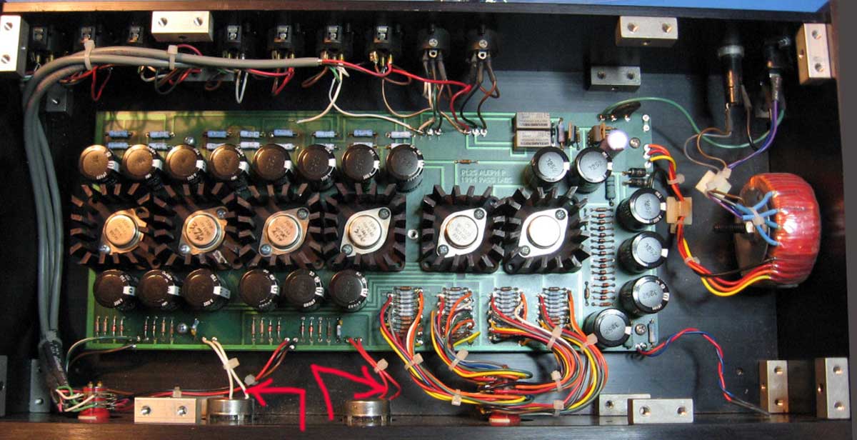

I purchased a Aleph P serial #003 and upon first listen there was noise almost like a ground loop or improperly grounded circuit. No hum. Also I was getting two sources playing at once. I pulled the top and found the two wires that would I believe to connect to the center pins of the RCA's right next in line from the output jacks off and hanging (damn FEDEX). One other wierd thing is that someone apparently wanted two sets of outputs so they wired jumpers from the output jacks to the same center pins of the input jacks that had the wires that came off. *** That is why I had two sources playing at once. **** I will fix this.
The only manual for the P on the pass website is for the revised version and some changes were made.
This preamp has way too much gain for me, too much to be able to be use. The later revision has changes made to the Master volume control to allow it to be set in a number of positions (5 normal and 5 positions that are -12db down.) Then the separate right and left controls do the fine tuning. My preamp has a more conventional ladder volume control. The separate volume controls for L & R are a 1K conductive plastic pot.
If I need more attenuation can I use a higher value pot in its place, or add a resistor in line?

gain span is from 8 to 14db , with max to min value of P101
considering its value is 1K ,gain change is 6db .......... try to increase R115 exactly for 1K .... to 1K5 (1K6 more common value , also good)

there must be some miscommunication - I can't see how increasing amount of source degeneration can increase noise
however , it seems that is early specimen (Ser. No. 003) , mosfets (IRF240) as active elements and bipolars (MJE) in PSU reg role
it's probably time for Papa to chime in ....... but - if schematic is in any way similar to one we have , you can make this :
look at picture I attached , and two red arrows ; desolder one red wire from right pot , solder 1K resistor (small one of 250mW is good enough ) to pot lug , solder wire to free end of resistor .
do the same on other pot with white wire
regarding output caps ..... I'm not seeing any other than big honking electrolytics ...... but that's separate issue ( bypass them or not , recap entire thingie or not)

Much appreciated, I wondered about just adding resistance along the same method as you just described. One other choice is buying a 2K honeywell pot to replace the 1K pot. The resistor to the left of the pot wires must be R115. In your and the pass labs techs schematic that resistor is 475 ohm I believe. On mine it is 211 ohm. I am thinking of replacing it with another Dale 1/4 watt resistor I have lying around that is 681 ohm. Not sure on the calc but suspect that should get me -5db and thats in the ballpark.
