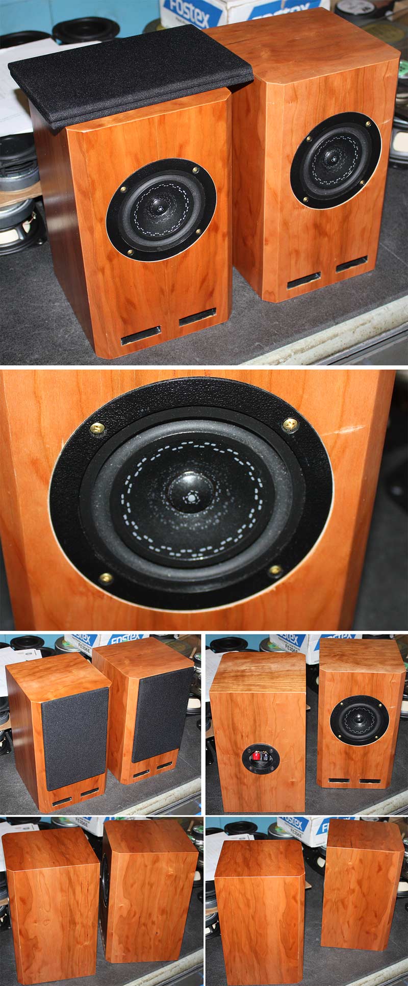

If there is any way you go up to about 6 liters, you could go with the Lance Redeye (The last speaker on the page). It uses the NS-3 and the bass is outstanding. There is no way I expected as much bass as it puts out. Beyond the bass it still sounds great.

I think that unless you measure the speakers yourself they are usually wishful thinking. Audition what you desire. The best mini me of diminutive dimensions I ever came across was the Technics SB F1 owned some & regret moving em on. The cabs needs decent damping, add 1 neodymium slug to the bass, get rid of the nasty steel mesh grilles covering the drivers, replace the electrolytic capacitors in the XO with polypropylene. Finally put some adhesive wool felt around the front baffle @ the exit of the horn loaded tweeter. Compare these mods by doing one & leaving the other stock. You will mod the other real quick! No bass to speak of but oh so sweet on everything else. Pressure cast alloy cabinet mini masterpiece with 86 dB efficiency by Technics.
The ones I modded are up on Gumtree South Australia right now Leo the current owner & seller used em in a recording studio, YES THAT GOOD!. I have no association with him. I saw the ad with my speakers and contacted him to establish if they were formerly mine and they were.
