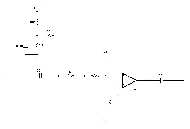

I tried to make a simple 12db/octave active lowpass filter, using the schematic found on WinISD - see picture attached.
However, all it gives is buzz on the output. No 'magic smoke' however.
Details:
op-amp - one side of JRC-2114 (also called NJM-2114 I think)
+ and - 13v unregulated psu (for the purposes of testing)
polyester .33uF caps and 1/4w carbon resistors, 10k
soldered on veroboard
100uF low-z psu bypass on the veroboard
Tested from CD player output (unmodified 1990s Rotel) and fed into subwoofer plate amp (RCM Acustik DT 110 MK II). (CD player direct to sub works fine)
Have I most likely made a wiring mistake? Or is this op-amp not suitable for this application? Anything sound dodgy?

I think your problem lies in that the non-inverting input has no DC path to ground if your CD player has a capacitor in the output (which it 99.99% will have). Place a 10k-100k resistor from your filter input point to ground.
I can't say if those op-amps are unity gain stable or not as they are not common ones. Get some proper ones from Bardwell's 😉 Also bear in mind that the unused op-amp in the package may well be doing all sorts of strange things if the inputs are not connected to anything, and it is likely to affect the used op-amp. Simply connect the unused op-amp as a unity gain buffer and ground the non-inverting input.

I trust that the OP-amp, for DC would be a voltage follower, and that the GND is just not shown. Basically, it looks like 2 LP filters in series, and then fed to a OP-amp follower/****** stage.
Nothing fancy there.
Check for (the obvious) solder-mistakes, and then check for shorted caps or resistors.
If either of the caps is shorted, you won't get meaningful signal through it.

Thanks for the replies guys!
I suspected I'd not done enough with the ground.
Secondly, he probably has more stuff in stock than Maplin!
Thirdly, the op-amp is one I pulled out of my main cd player - CD63ki (a victim of 'upgrade' - to 2604).
http://www.njr.co.jp/pdf/ae/ae04028.pdf
Fourthly, I don't know what a unity gain buffer is. My understanding of electronics is 'beginner-level' at best.

I'm sure my tip with the input resistor will fix it and, if it doesn't and the assembly is OK as per Jennice's recommendation, then correctly terminating the unused op-amp will probably solve it. A unity gain buffer is simply a buffer with a gain of 1. All you need to do is connect the inverting input to output (thus 100% negative feedback) and the signal (ground in this particular case) goes to the non-inverting input. Couldn't be simpler.
A 741 will do and is 'the' generic op-amp, but I'm sure Bardwells will sell you a TL071 (single) or TL072 (dual) which will be infinitely better. An NE5534 will not be suitable in this case without an additional capacitor for compensation, but the dual version -- NE5532 -- will be fine.

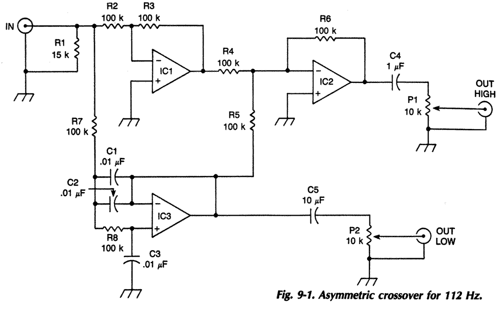

Just an additional remark:
As soon as your circuit is working you might find it a little noisy: In this case think about using smaller resistors like 10 k and use larger caps instead.
As far as your hum goes: I also expect it to come from a wiring error or ground loop (how does your DC suplly voltage look like BTW ?).
Another remark to your crossover: This is a subtractive-type crossover (which is transient-perfect or phase_accurate BTW !!) that generates a first-order highpass function by subtracting a lowpass from the input signal. This highpass has a hump due to mathematical reasons (this is NOT a hump caused by a high-Q pole, causing ringing !) that is depending on the lowpass' Q. If you use a filter of lower Q then the hump will be smaller. Many people use a Bessel 2nd-order lowpass for this reason (yours is a Butterworth one).

I appreciate remarks. But did you perhaps make a mistake in saying '10k'? I am using 10kphase_accurate said:Just an additional remark:

Maybe I have to see an optician, but I could bet almost every resistor on the shematic that you posted is 100 k.
Is your supply symmetrical like +- 13 Volts and not just 13 Volts ?
The source driving your circuit does indeed matter but not to the extent that it should cause a go/no-go situation. It will rather influence quality.

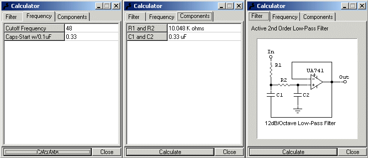

Good evening everyone,
I'm home now and have had another look at my circuit.
I measured the full AC psu voltage on the output: ~27vac
So I proceded to connect a 22k resistor from input to ground, as per suggestions. This took away the AC but I was left with 5vdc!
I tested this anyway, and buried deep within the hum/buz was the music signal!
Next step - I joined pins 6 and 7 together (B-IN >> B OUTPUT), as per richie00boy's advice, and pin 5 (B+IN) I connected to ground. This took me back to having the full AC voltage on the output.
I have carefully checked my connections and to my untrained eye everything looks fine. I checked for continuity in many places and found no shorts. Power - and + go to the correct pins. Where the signal goes in appears to go through the two resistors, and the caps appear to be in the correct positions.
One thing I wonder about - where the schematic shows the output being directly connected to -INPUT --is this really just a plain short?? That is how I have connected it.
If there are no obvious mistakes remaining I think I will just pack it in and buy the correct (single) op-amp. Not like it's costing me very much money.
