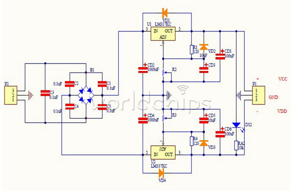

How would you adjust/improve the attached schematic with respect to snubbers? They came with red film caps for C1/2/4/5. They might be CBB, not sure. C3 is a yellow box safety cap.
I use a number of those supplies plus a variant with LM353 and another variant from diyaudio (denoiser/dienoiser).
C3 must be a snubber but not a bare capacitor (RC but not C). C1/2/4/5 are helpful for high-frequency signal devices, e.g. AM-FM radio (usually don't help for audio frequencies). And if you use C1/2/4/5 then their capacitance has to be in the order of several nanofarads.
I would rather put two snubbers, each for every secondary, but not one for two secondaries in series. But one snubber is better than no snubber at all.
A typical snubber for your circuit is something like a 10-22 R resistor and 0.47-1.0 uF ceramic cap. I use film caps only with high voltages, >= 50..100 V.
So if the kit came with 100nF C1/2/4/5 replace them with 2.2nF or 4.7nF before soldering the kit?
What would be typical R & C values for a snubber suitable for a 250 mA DAC supply built with LM317/LM337 and 1A rated transformer?
