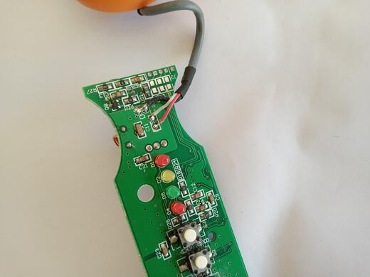

The circuit was working intermittently in the original package. I suspected the cause was a loose DC female connector at one end of the PCB. I remember a few years ago, I replaced this and the issue of intermittent function was resolved for quite some time. Now, the issue has resurfaced, and naturally, I suspected it was the same old ailment. However, opening and inspecting the PCB, I found the power transistor soldering to be the issue. There is a glaring dry joint on the emitter! The transistor is not a high voltage one, but with a Vce(max) = 30V and Vbc(max) = 40V, 60 <= beta <= 400, fT = 50MHz. The transistor part number is NEC D882 and is an NPN transistor.
I will solder the dry joint. If that cures all issues of intermittence, I will not need to do any modifications for this device.
I am attaching a photograph of the PCB showing the dry joint.

The image in my last post does not show clearly the dry joint. I am posting another one with better detail. The pads in question are the three pads next to the LEDs. One of these pads is clearly a dry joint.
Sorry for the confusion, while inspecting the other side of the transistor pads, I found the solder is OK. This is a double sided PCB. This means, the trouble has not yet been resolved and I still need to use a cable for the piezo transducer.
As mentioned earlier, the power transistor is a NEC D882 NPN transistor. This is not a high voltage transistor but with a Vcb(max) = 40V. This transistor is rated at Ic(max) = 3A.
