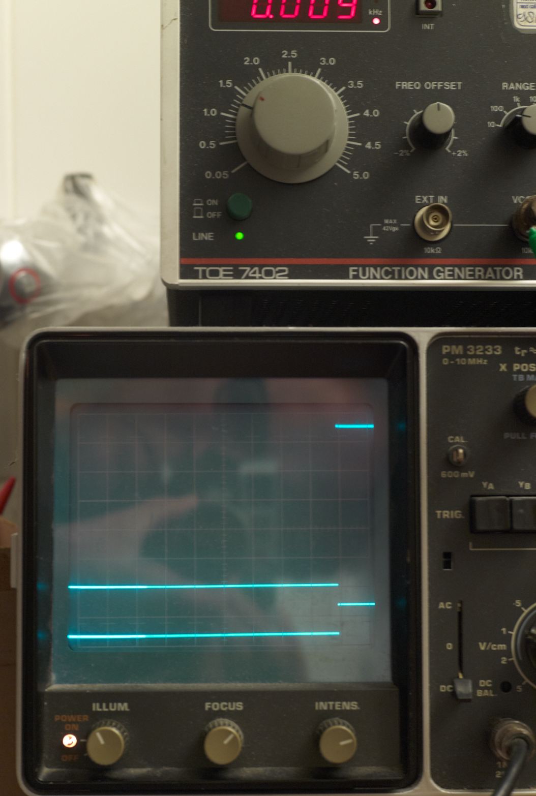

Hi A.wayne,

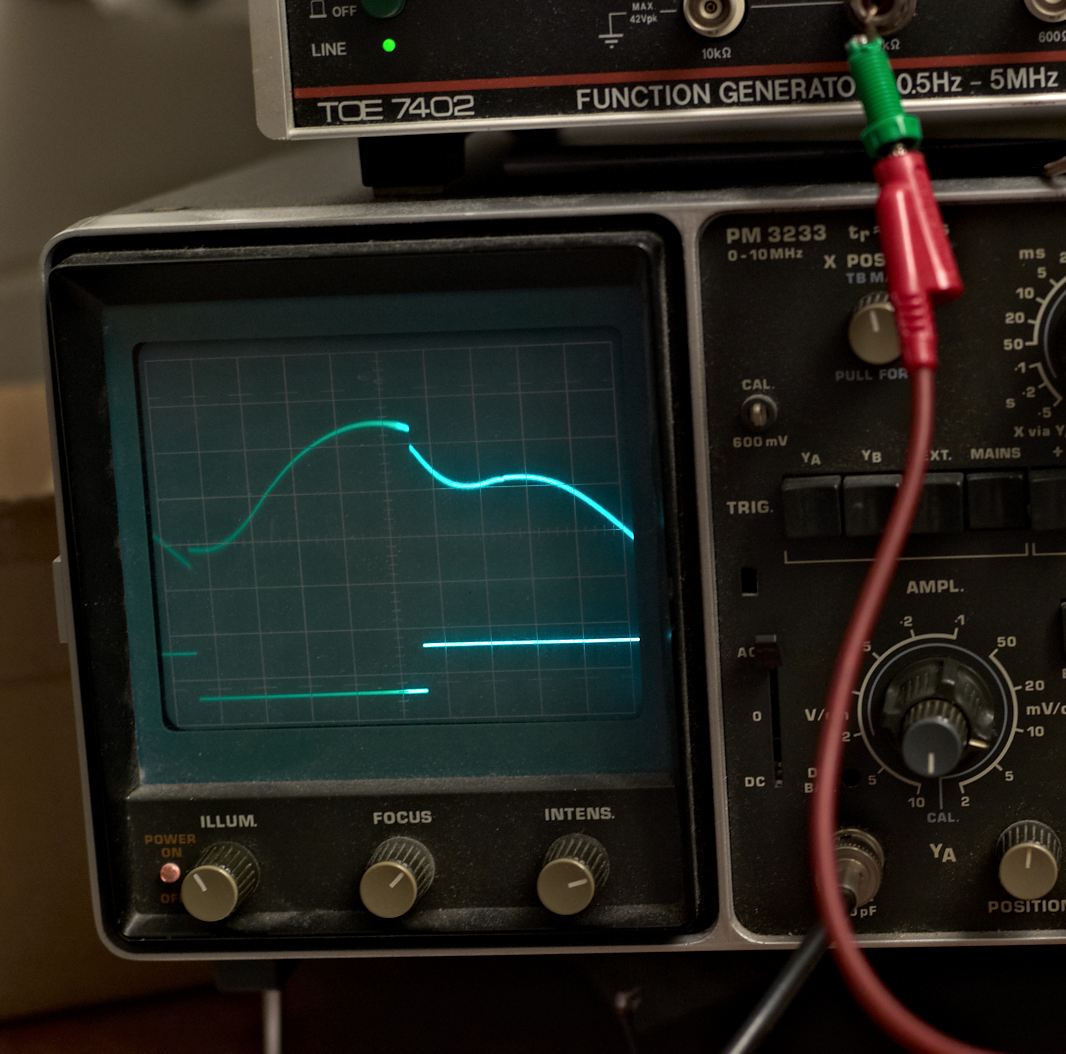

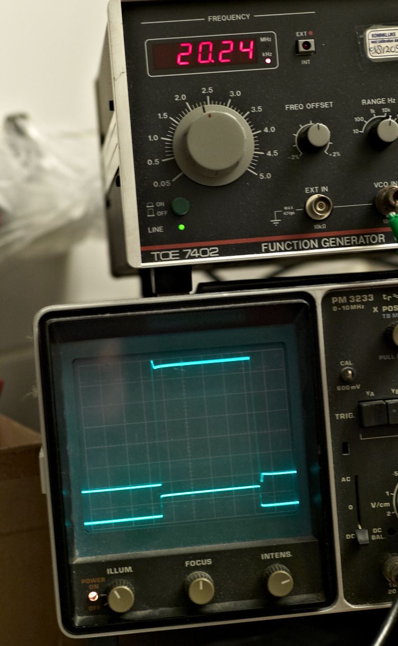

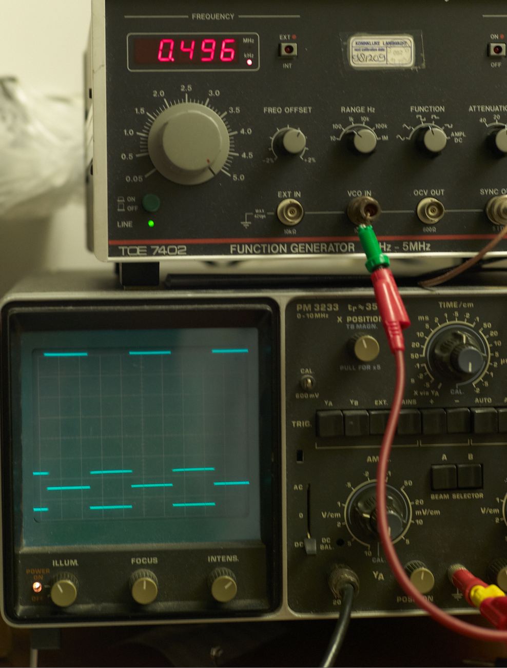

I have some extra square waves on 8 ohms.
The amp bandwidth is from DC to 2 MHz . .
10 Hz (scope set on DC) Not bad . . . :)

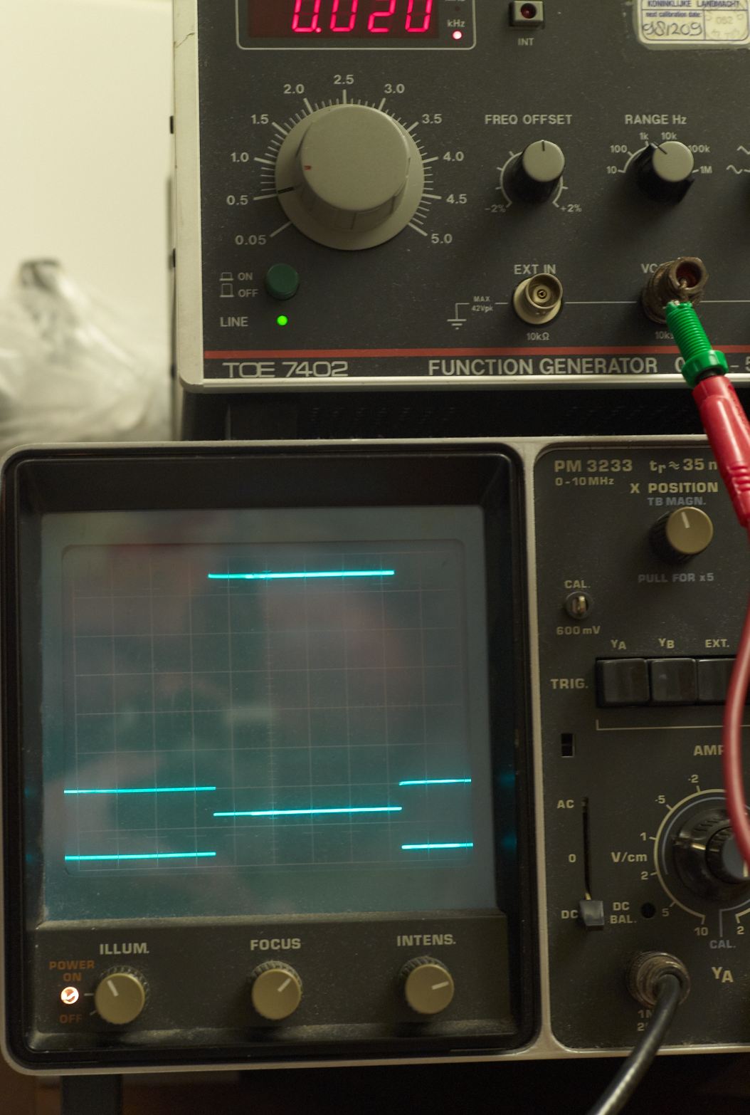

20 Hz

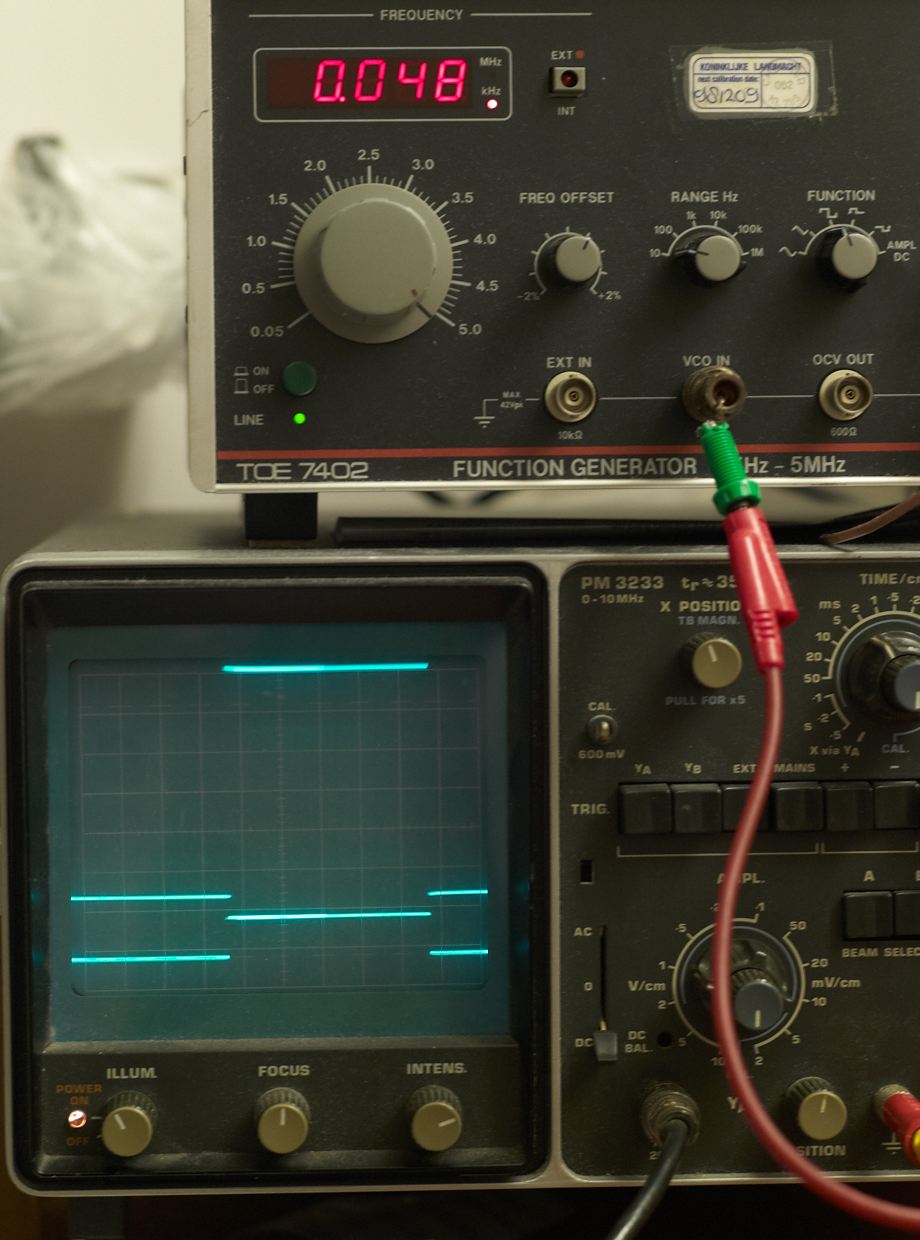

50 Hz, with 50 Hz PS reaction

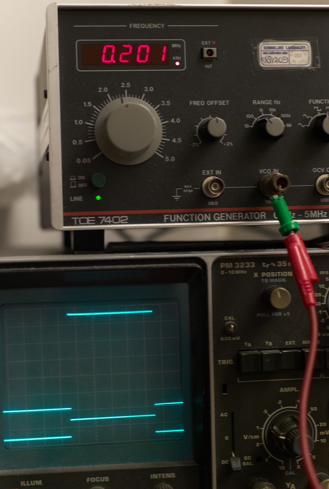

200 Hz (it is getting boring, they are all the same)
5.000 Hz

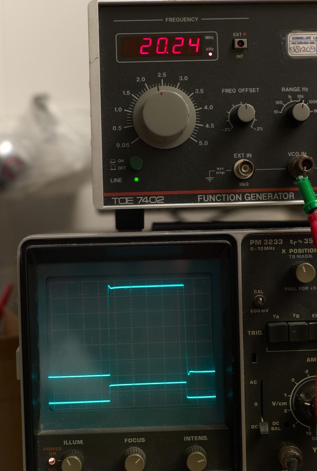

20 K on 8 ohm and 4 ohm
Here we see a slight overshoot that is not harmful and does not impact real life music.
I changed the feedback a few days back, by taking out the 2,7 nF caps I had across the 50 ohms resistors.
Immediately I got the much wanted 'laid back' character, easy listening.
Of course the power supply caps are now getting 'burned in' (formatted), that is positive too.
Really funny because the pole it introduced was as high as 1,2 MHz - still you can hear it clearly.
I listened to a Charlin recording (two microphone concept) and indeed the hall characteristics are good to hear. (Sorry, that is Dinglish).
In fact, the amplifier is 'disappearing'. The sound now is completely transparent. :)

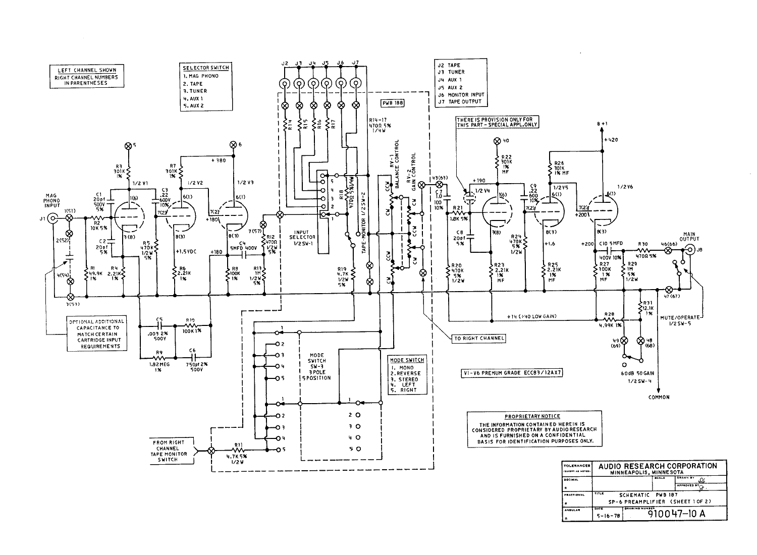

So I decided to oust the Aikido. I had found that the Aikido is great for pop music and non complex material, but sort of dominated a lot of complex music like classical music. My choice fell on the SP6, for which I had made a test circuit in the past using ECC82 in the first position.
I now settled on the ECC81 and 12.5 dB of amplification and this way I came up with a very dynamic line amplifier. The combo gives an infinite dynamic levels of sounds. Less than 0,01% by the way and able to output 20V RMS.

You can give a schematic that preamplifier with ecc82 or ecc81
thank you and cheers!
