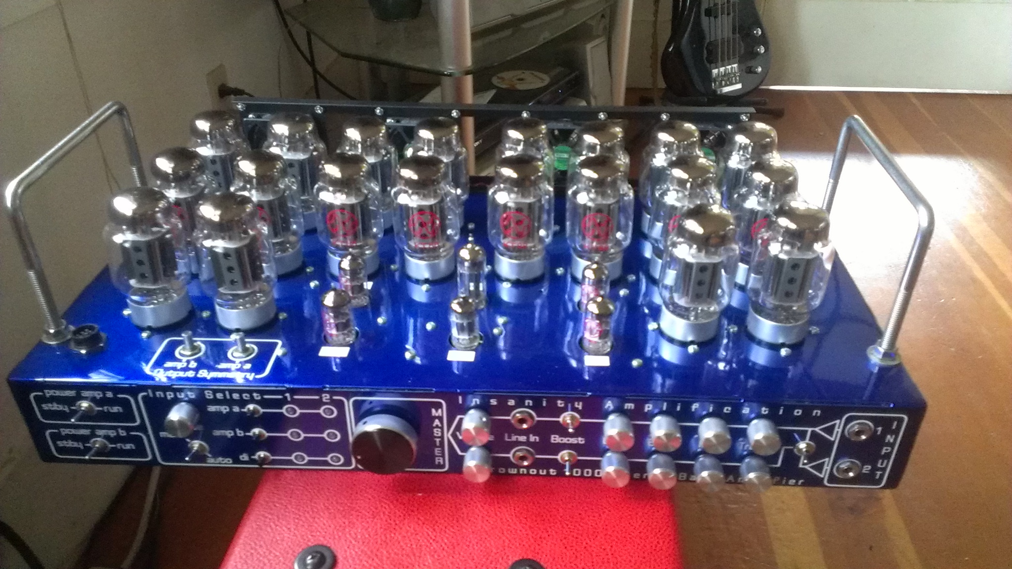

hi artsalo
the tubes are not operated outside their dissipation quiescent current is set at 20 ma , The ouput tx is a 1 kw unit at 20hz wound in the early seventies and came off an amp which had 8 x tt21,s, its primary impedance is 650 ohms perfect for 12x pl509 its basically a 10" cube to give an idea of the size the tubes swing 260 ma just prior to clip and the supply voltage drops to 795 volts I could push the screens harder say 185 volts. Have tried at 205 volts and the amp was unstable so 200 watts a pair is about max for reliable operation, I mean hours on end at full tilt and regularly driven into overdrive clipping it does run 4 x 1000 watt 6th order band pass subs.

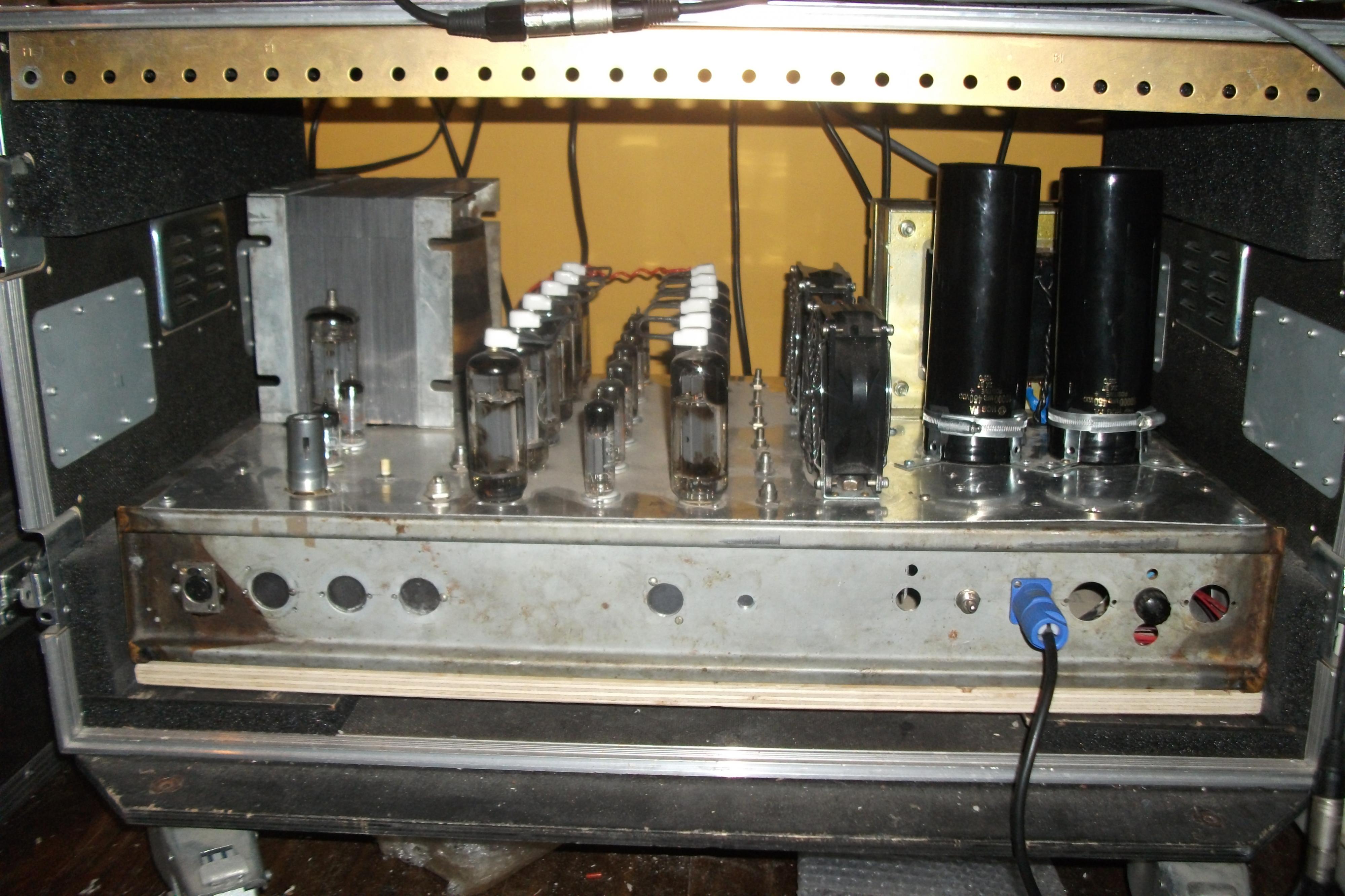

hey wolfpunk which hammond transformers have you used I assume that you have them in parallel. See a pic of mine attached, built into an old chassis, you can see the size of the output transformer with the el 509 next to it, have since rebuilt the power supply as the 4 amp mains tx was not up to it...now has a 6amp supply with 10,000 mf of capacitance, your chassis is very crisp, I will get around to something similar The power supply is on a separate chassis I assume do you have a photograph of it?.
