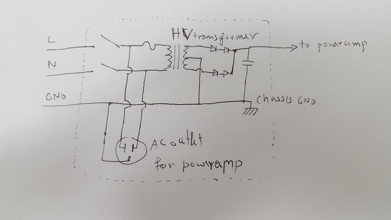

My plan is using Millen connector connect only HV from the power supply chassis. The power supply chassis has on/off switch is wired to have AC outlet with L/N/Gnd for power amp chassis. So, power supply's ground and poweramp's ground are connected.
This way I can reuse this HV power supply with other projects that require 1KV (GM70, etc). 😀
