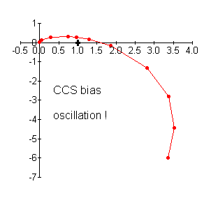

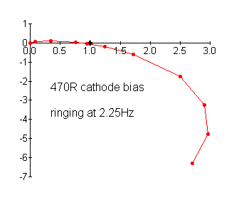

I have put together a quick spreadsheet models, using typical values for LF poles in an amplifier of the Mullard/Radford/Leak topology. I did two versions, one for CCS bias, the other for resistor bias. Without any cheating, the CCS one shows LF oscillation and the resistor one shows extremely marginal stability with serious peaking at 2.25Hz.
The results are in the attachments. Stability requires that the line does not wrap around the 1.0 point on the X-axis.
The step network feeding the PS in the Radford would improve things, which may be why it is there, but in any case the situation is marginal.

DF96, very clever, and surprisingly close to reality! The 470R does indeed ring slightly. Out of interest, how did you produce these graphs and what do they represent?
The graph is a plot of real (x) and imaginary 👍 component of the loop gain at low frequencies. I think this is called a Bode plot. The loop gain is A x b, where A is the amplifier gain and b is the feedback. For simplicity I assumed b=1. A at mid-band was 25 - this represents an amplifier with, say, open loop gain 500 and closed loop gain 20.
I then calculated the amplitude and phase of a set of high pass filters: phase splitter, o/p stage coupling, o/p stage cathode, and OPT. I just picked typical values for each:

o/p cathode gm 12.5mA/V i.e. 80 ohms, plus 470uF and CCS (4.2Hz), or 470uF and 470R (4.2Hz/0.7Hz)
OPT -3dB at 20Hz (20Hz)
The 470R cathode resistor turns that HPF into a lead-lag network with less phase shift but higher LF gain. Add up the phase shifts, multiply up the amplitudes, and then plot the results. The closer the curve goes to the 1.0 point the higher the peak in response, at roughly the frequency of closest approach. If the curve circles the point then you get oscillation. If you want to know more your best option is to Google for feedback stability, servo systems, Bode plots. I think Mr. Nyquist had something to say too.
In olden days before spreadsheets they used to do this sort of thing using graph paper. There are short cuts and approximations which can give a good idea.
The quick and easy way to stability is to have a dominant pole - in our case the OPT. Then ensure that all other poles are well away in frequency. You really want the next pole to be down by a ratio of about the mid-band loop gain (i.e. 0.8Hz). The nearest one is the o/p cathode at 4.2Hz. This is much too close so either needs reducing with an even bigger capacitor (2200uF?), or partially cancelling by turning it into a lead-lag with a resistor instead of CCS. That is how they used to get away with such small decouplers. Alternatively, reduce the feedback which will increase the sensitivity and distortion.
