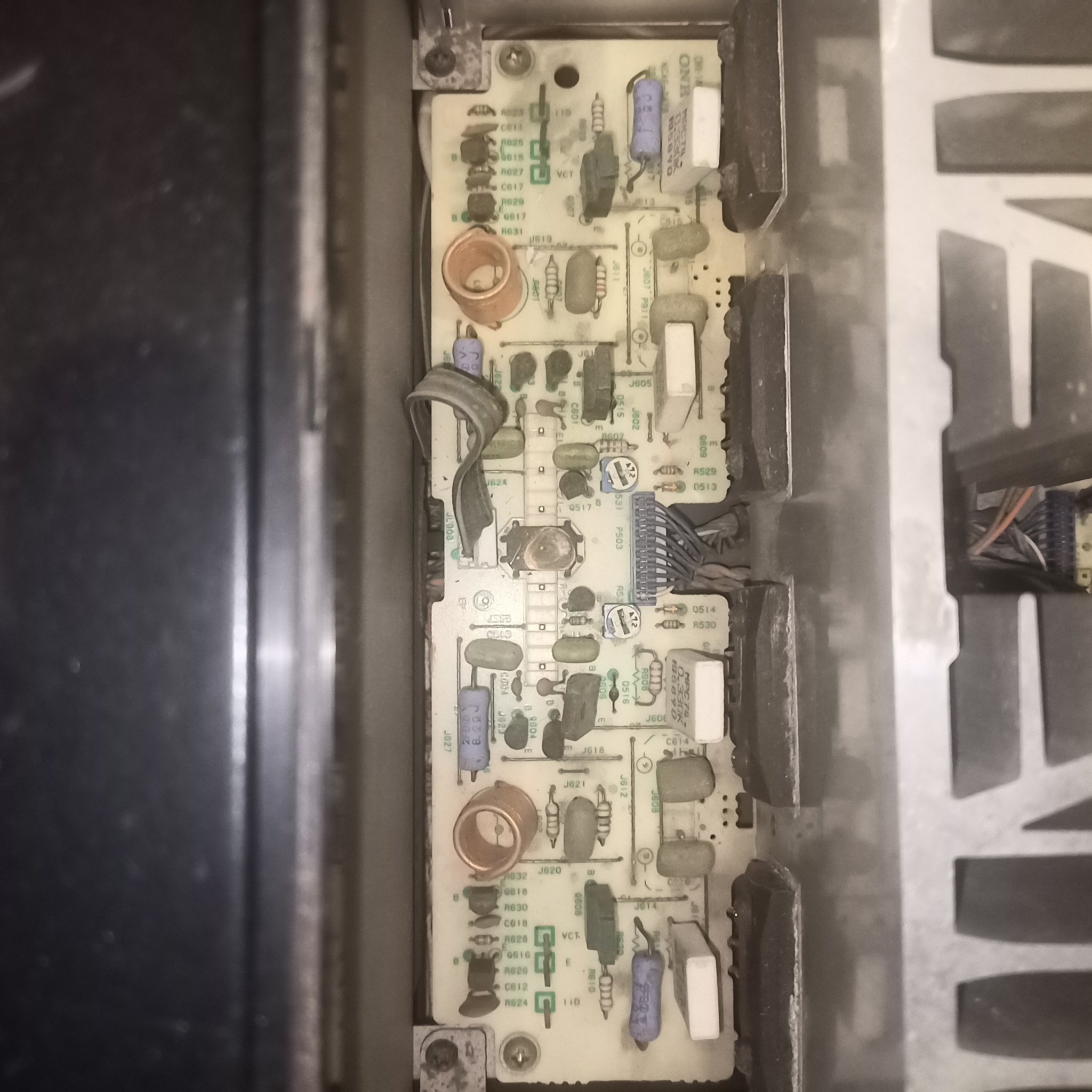

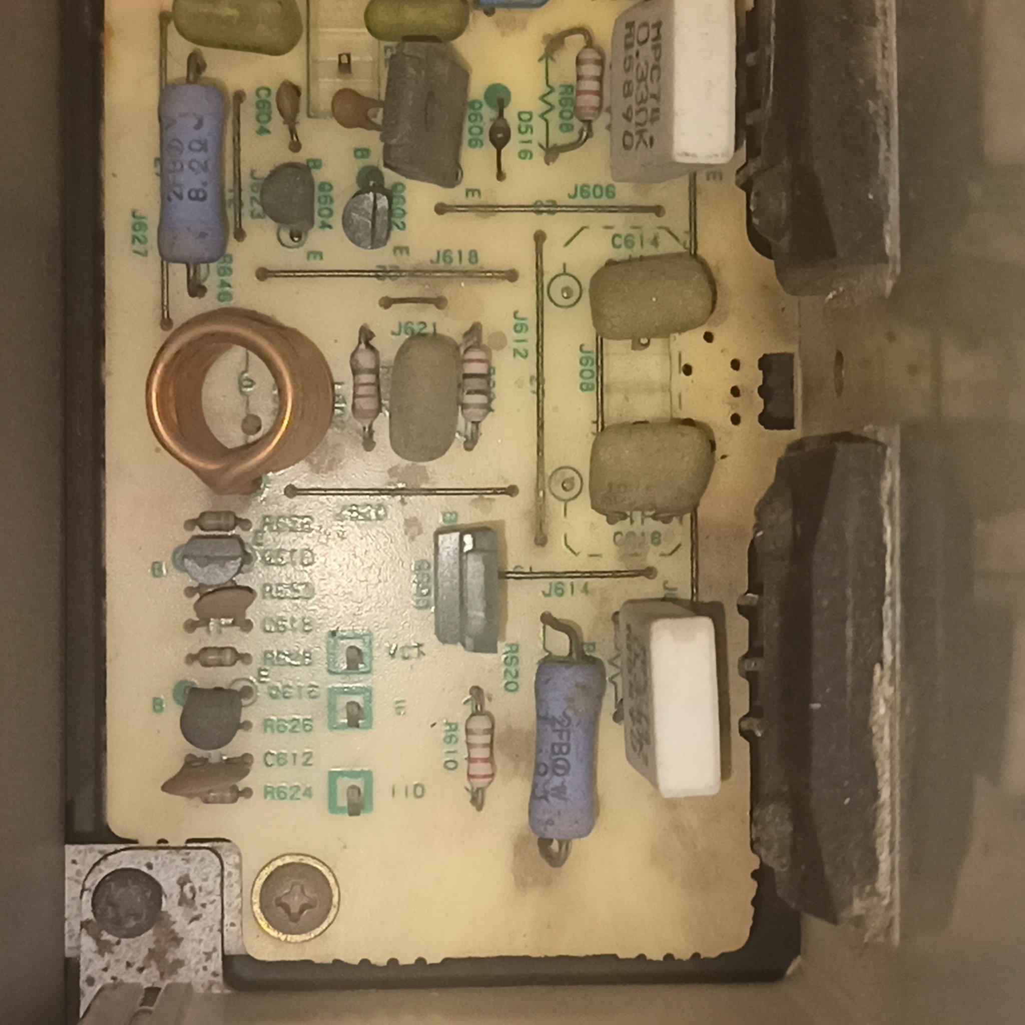

I am using this integra 817xd, seems to be in very good and works ok except that it produces crackling, intermittently, mostly on slow music. And as it was released in 1988, I suppose it should be now recapped, don't know what performance it might be holding back. Values and numbers of all parts are clearly visible, I need to find what parts to get as I think part to part replacement would not be available for this old amplifier. Haven't attached the pics for power section which has large capacitors and look good, thought first get through this tricky part. I am thinking about getting all the parts first and then take out the boards in one go for replacement. Will be uploading more pictures, might get some cheap endoscope camera to identify all the parts without opening the boards.

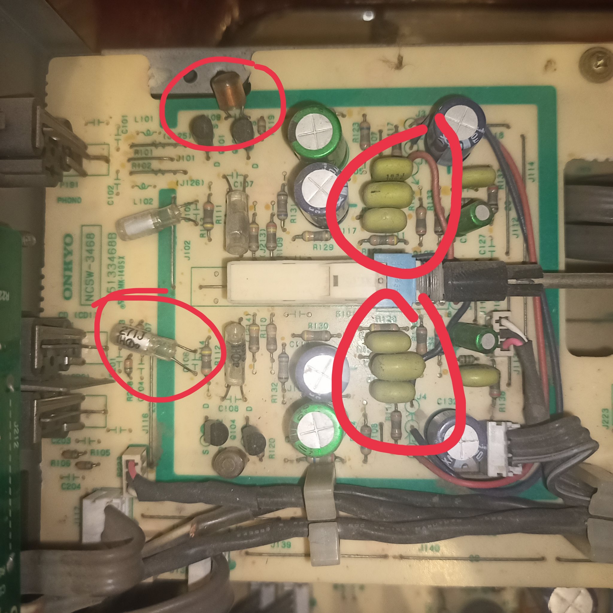

Or just help me identifying these capacitors type and brand too if possible.
The one circled on the left is a 270 pico Farad styroflex capacitor the ones on the right could be something like polyethylene or polypropylene film capacitors
My toughts:
  • brand is not important in the sense that any today's good brand is good; you don't have to go for the same brand they used in 1988
  • it is more important to match the value and voltage written on the old capacitors (for example I have not seen styroflex capacitors like the 270pF in new equipment, a sign that maybe is an obsolete technology)
  • max voltage on the new capacitor can be higher than the max voltage of the old capacitor
  • usually, the electrolytic capacitors are the ones that lose value (capacitance decreases) as they get older (even if they look good) so I would start with that.
  • if you really want to change all capacitors then you should consider buying a multimeter than can measure capacitors
Also, I would start by searching for capacitor value on mouser or digikey; for example search for "270 pF capacitor" then look at the pictures, maybe select some filters like film capacitors or high-reliability capacitors if there are too many results.

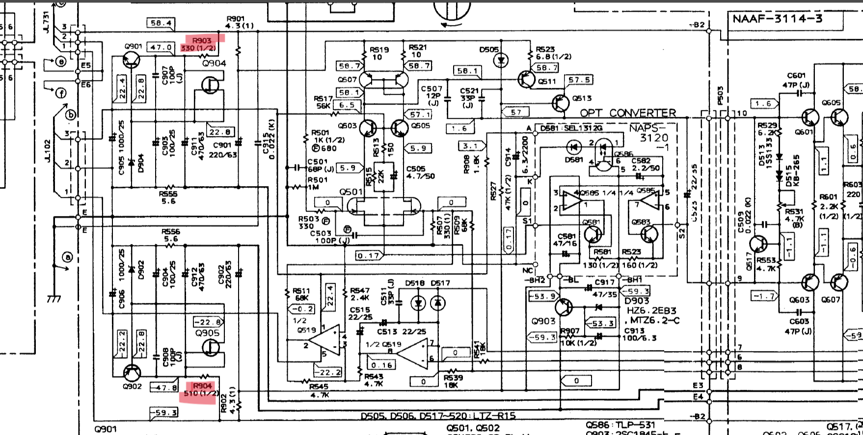

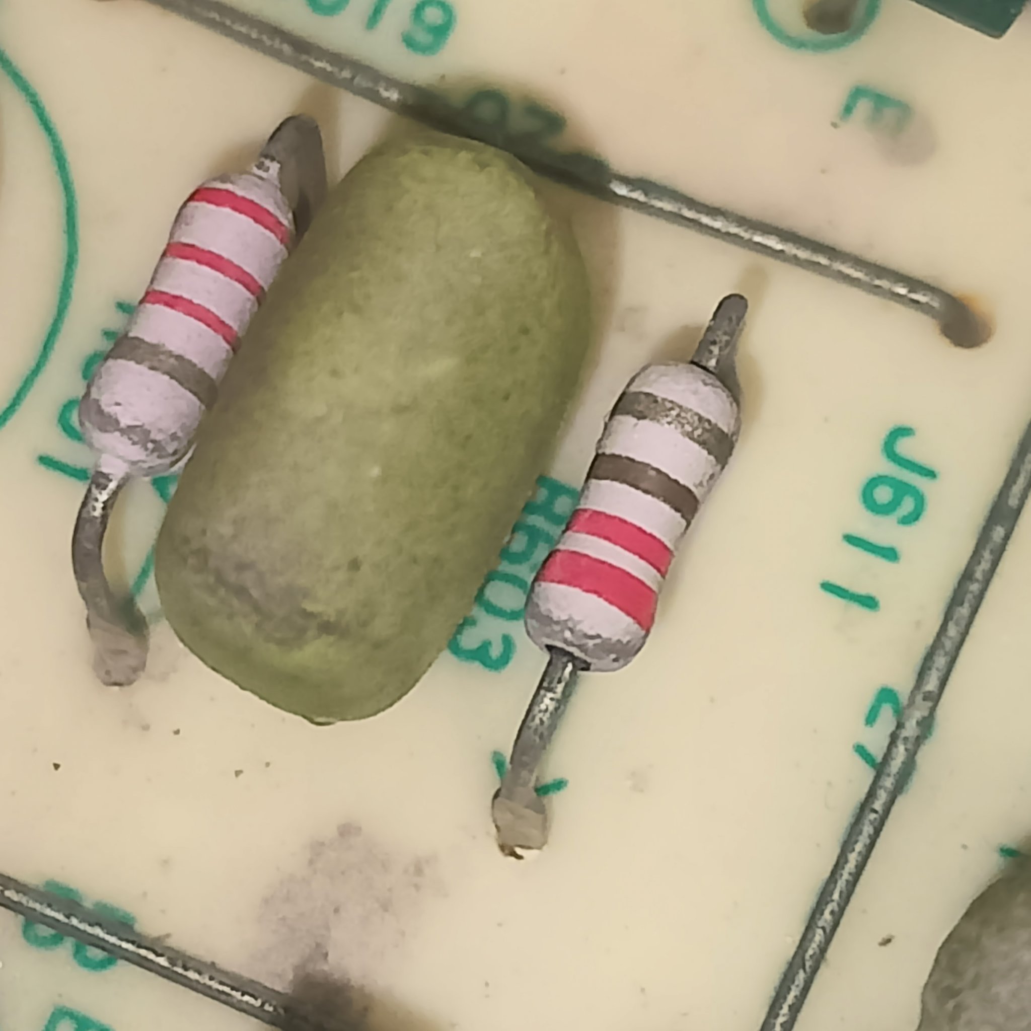

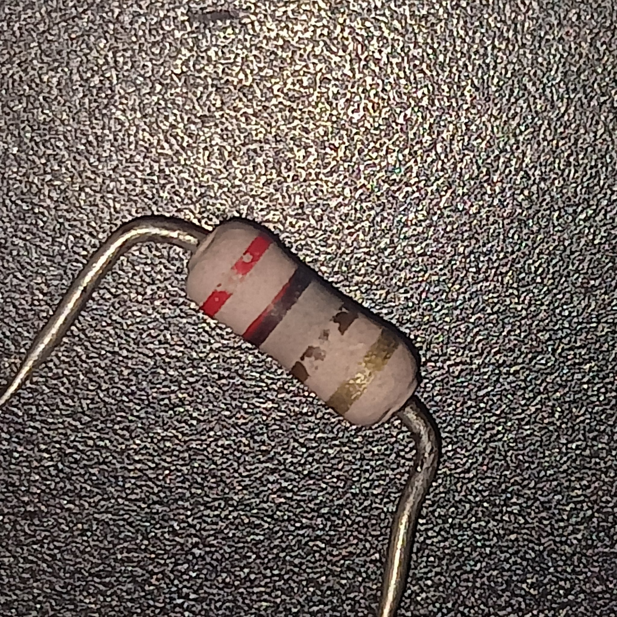

going through schematic in Power amp sec (II) resistors R603 AND R604 are 220 Ohms, but onboard R604 would measure in mega ohms and fluctuate, also on color band is red, black, grey color filled, brown, golden, and it seems it from factory as it is. So i have replaced it with 220 ohm. now Dc in speaker outputs reaches 1.5mv earlier it was zero. I was getting inconsistency in speaker output between both channels and still there is some present.
the problem at moment that is bothering me was even before replacing R604 220hm resistor and lot more so after it, the resistor at R903 and R904 (amp section I) are running untouchable hot, but amp seems to work fine. What can be causing these resistors to get that hot?

Hot resistors,as soon as they keep the value,aren't an indication of faults.
Measure old resistors out of the circuit.
You can' t use 1/4W resistors here.
If old resistors measure good, return those in the position.
If not,use 1W metal oxide.
Voltage drop resistors always run hot.
is bothering me ... the resistor at R903 and R904 (amp section I) are running untouchable hot
More important is that the voltage is as presented on the schematic; for example voltage on R903 is 58.4 - 47 = 11.4V , calculated dissipated power 0.4W
This is close to 1/2W specs and is tempting to change the resistor to 1W, but maybe it is intentionally like that close to the limit, in the sense that if something goes wrong and the current increase the resistor will burn (sacrifice resistors like fuses) and stop the damage to affect more components.
yes, I also think 1/2w is by design. here are voltages calculated with reference to chassis. before resistors 61.4, after R903 49.9, after R904 49.2. AC supply voltage is 105.5, amplifier is 100v rated. is 61.4 within tolerance are can something be wrong there?
ok let me update, when house generator operates supply to amplifier gets to 100-102v AC and before resistors it comes to 57.5-58 . So I guess something else could be causing the heat, more current passing through the resistors than rated but how and where?
