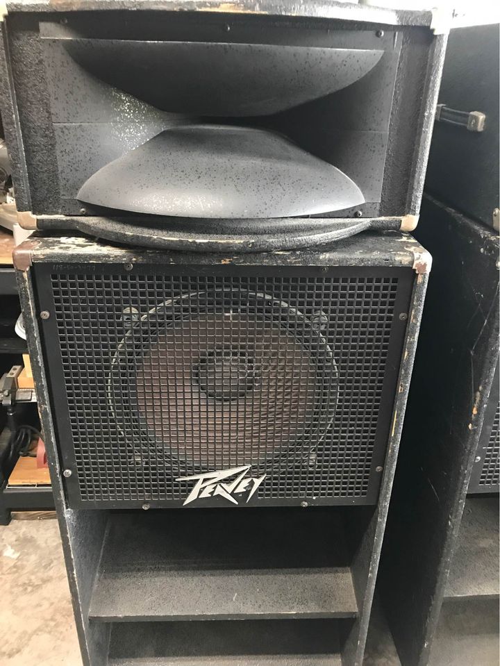

Unfortunately, Dennis (DJK) is no longer with us! My Horns have never quacked, in my room. They are not "perfect" but I enjoy them a great deal! I use a parametric EQ to scoop them out from 1 to about 4.5 K.
