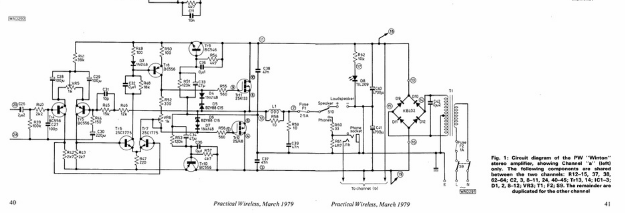

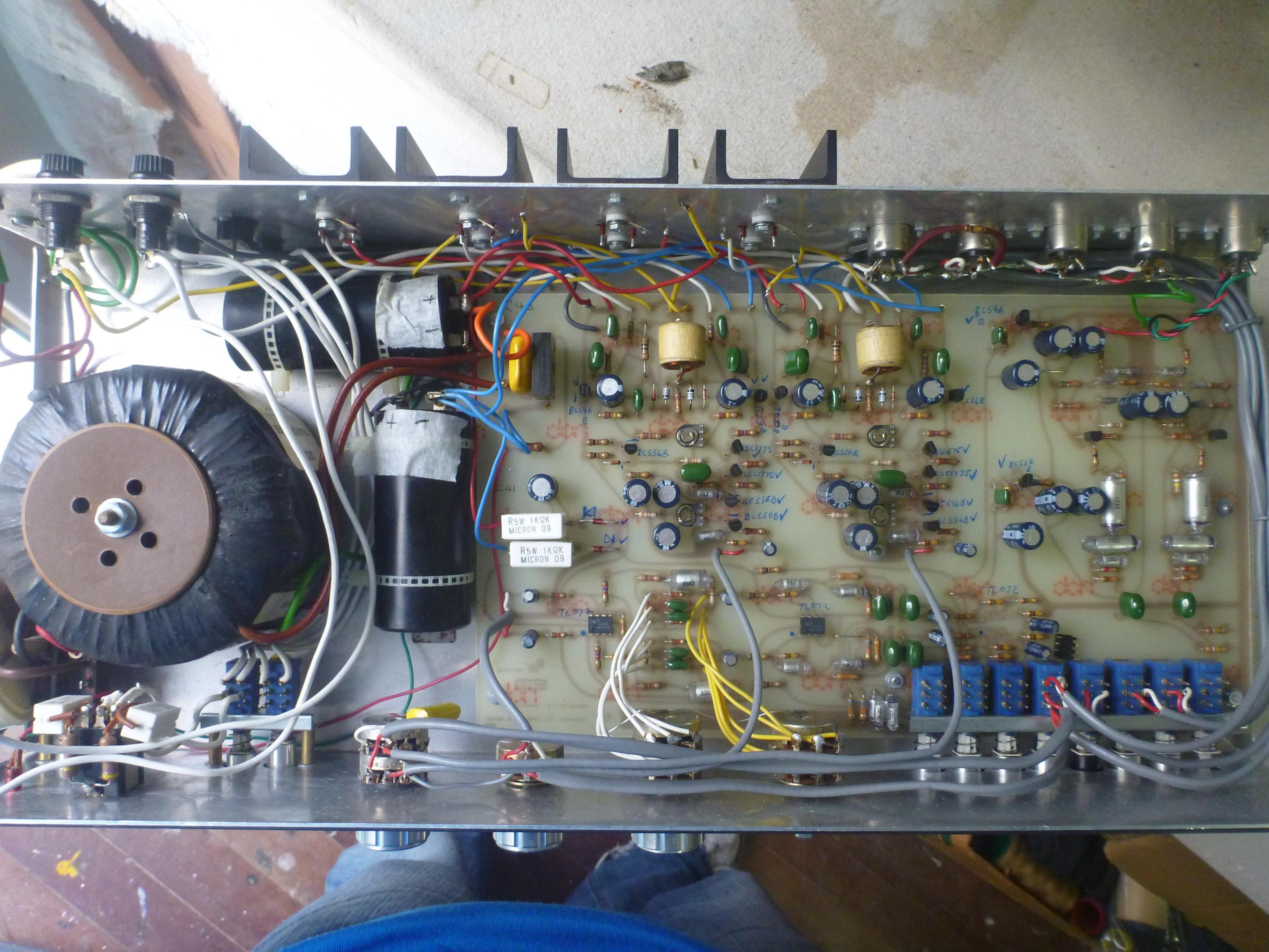

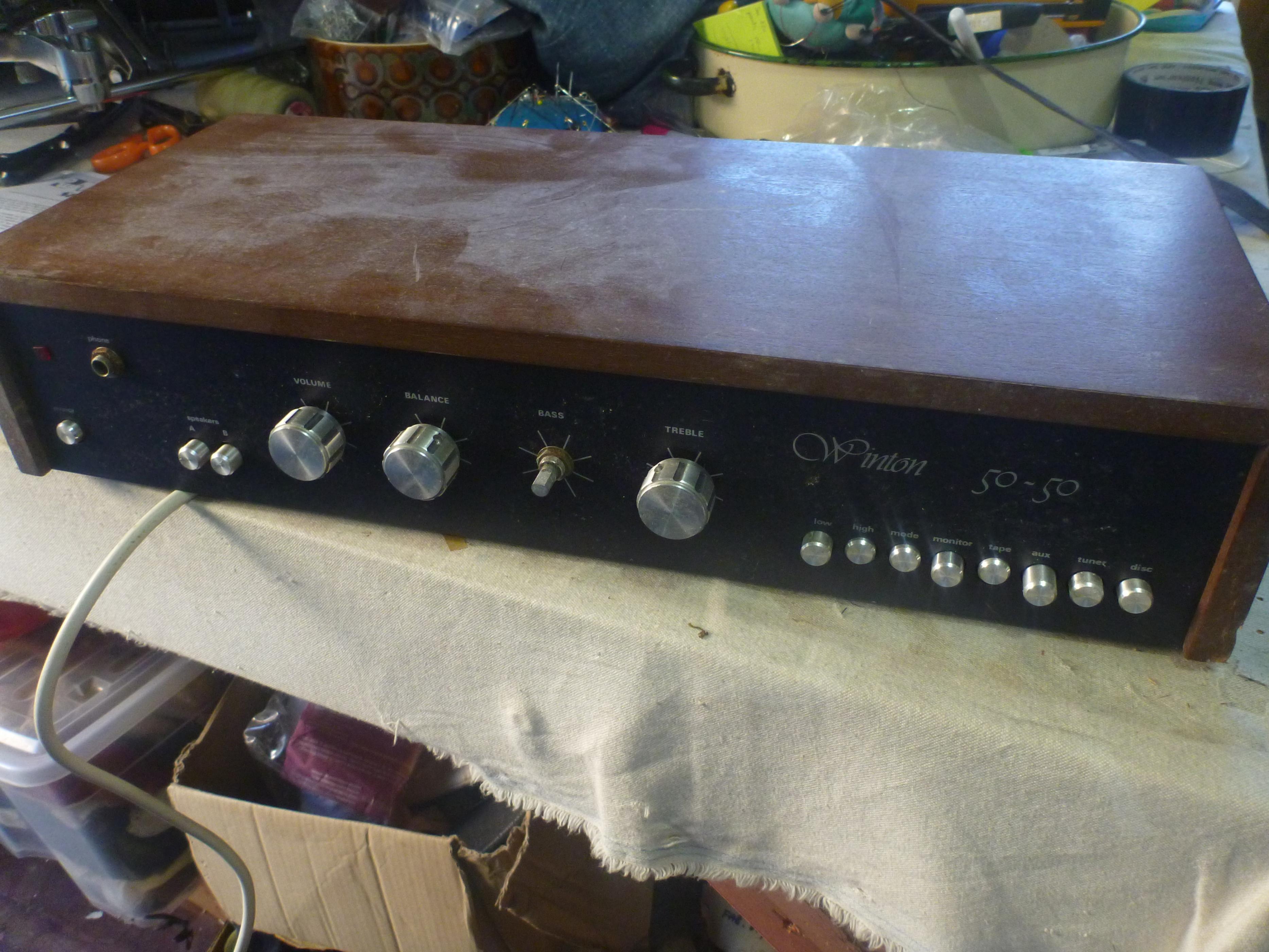

Resurrecting this thread - keen for a steer on getting this amp working. Please see various pics attached. I'm crashing at my sisters place and found this amp rummaging in the cellar. It smells like mould.
I saw it and thought "meh", then took a look at the back - all FET outputs - apparently its one of the first (if not THE first) FET output amps made. Dated from 1979 - it was a kit from a Practical Wireless mag. I found all the construction notes online and have posted relevant excerpts.
Take a look at the components used inside - I think this amp is well worth restoring - its has polystyrene caps throughout.
Issue: the sound is very faint and distorted in both channels. The amp powers-up fine thru the DBT.

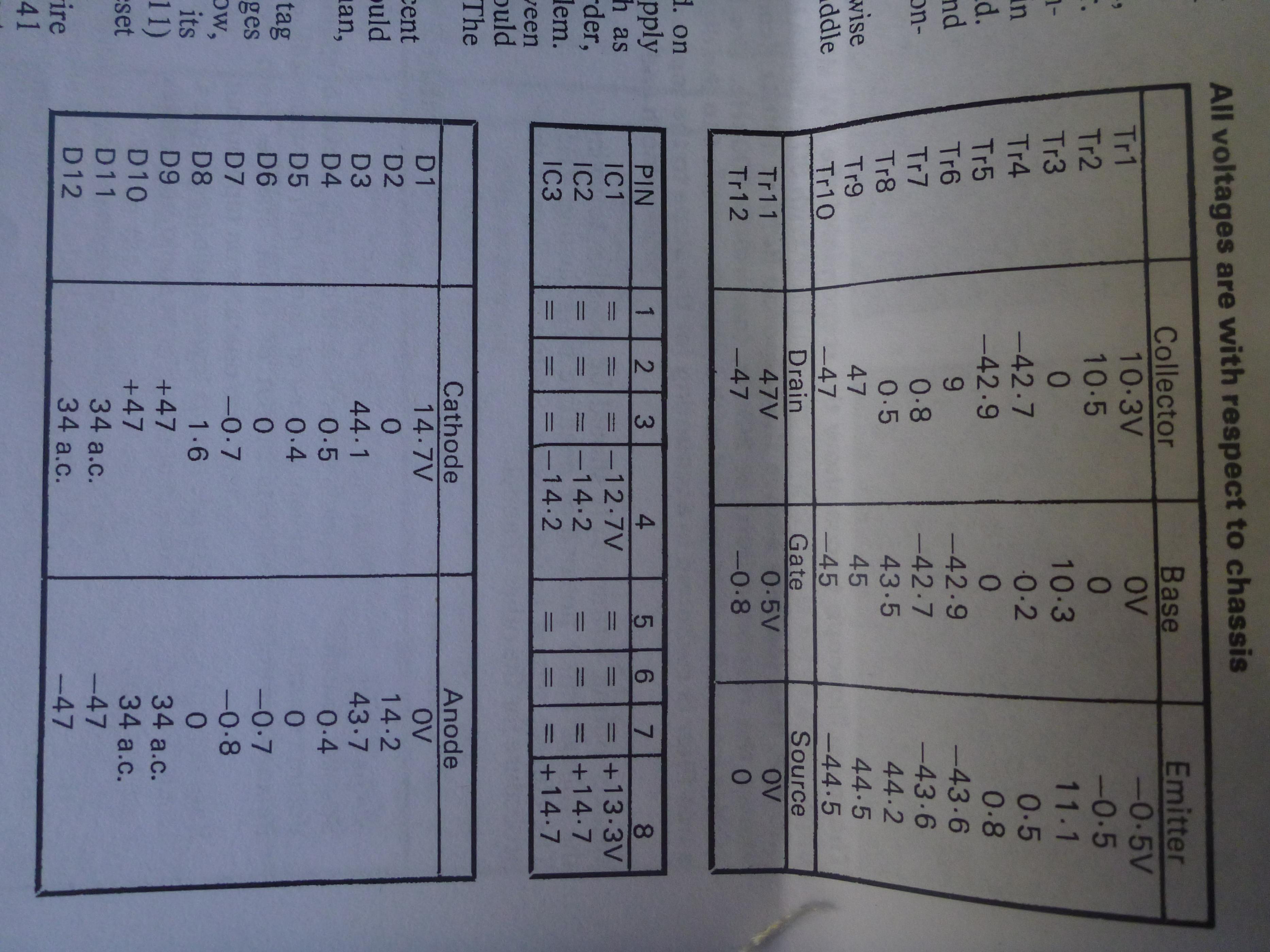

Fault finding: I have gone thru and taken all voltage measurements using the reference chart attached. All transistor voltages checked out OK.
However I am getting lower readings than I should be for D4 in both channels. I am getting 0.2V on both cathodes (instead of 0.5V) and 0.1V on both anodes (instead of 0.4V).
I am also getting a lower reading of 0.2V on both cathodes of both D5's, where I should be getting 0.4V.
I have removed every single transistor and tested them all - they all check out OK.
Output FETs - Im by far not an expert at testing these. However each type in both channels test the same. Plus I have tested all on a component tester and got these measurements:
- 2SJ48 #1: C = 719pF. Vt = 0.58V. P type MOS
- 2SJ48 #2: C= 719pF. Vt = 0.59V. P type MOS
- 2SK133 #1: I= 1.9mA. Vgs = 0.27V. N type MOS
- 2SK133 #2: I= 1.9mA. Vgs = 0.32V. N type MOS
Note that I am not getting the same readings for both types - ie: I wasnt able to get a VGS reading for the 2SJ types.
Question 1: Is there any other test that I can do (I tried multi meter tests but wasnt really sure what I was looking for) on the output FETs to check they are OK?

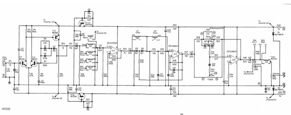

Question 2: The amp has 3 x TL072 input FET opamps - could these be the last remaining culprit? Can these get damaged easily? The voltages on pins 4 and 8 of all 3 of these however do check out OK - could they still be damaged though? If I have blown one or more of these, I could check (it seems) by dropping in some new TL2072 opamps as both a fault-finding measure and an upgrade.
Question 3: I have also set up the bias and that holds correctly for both channels. If there was an issue with the output FETs, could I expect to not be able to set the bias?

The opamps should be fine. If the supplies are correct then you should find essentially zero volts on all the other pins.
If the bias is OK and adjustable (should be around 100ma for lateral FET's) and the DC offset of the power amp is at approx zero volts DC then that all sounds good.
I would imagine the big issues with this amp at this age are the mechanical switches. Try feeding a signal straight onto the top of the volume control by linking direct from the input sockets to the volume control.

The front end Tlo72 leaves a bit do be desired but yet again for the money ok
