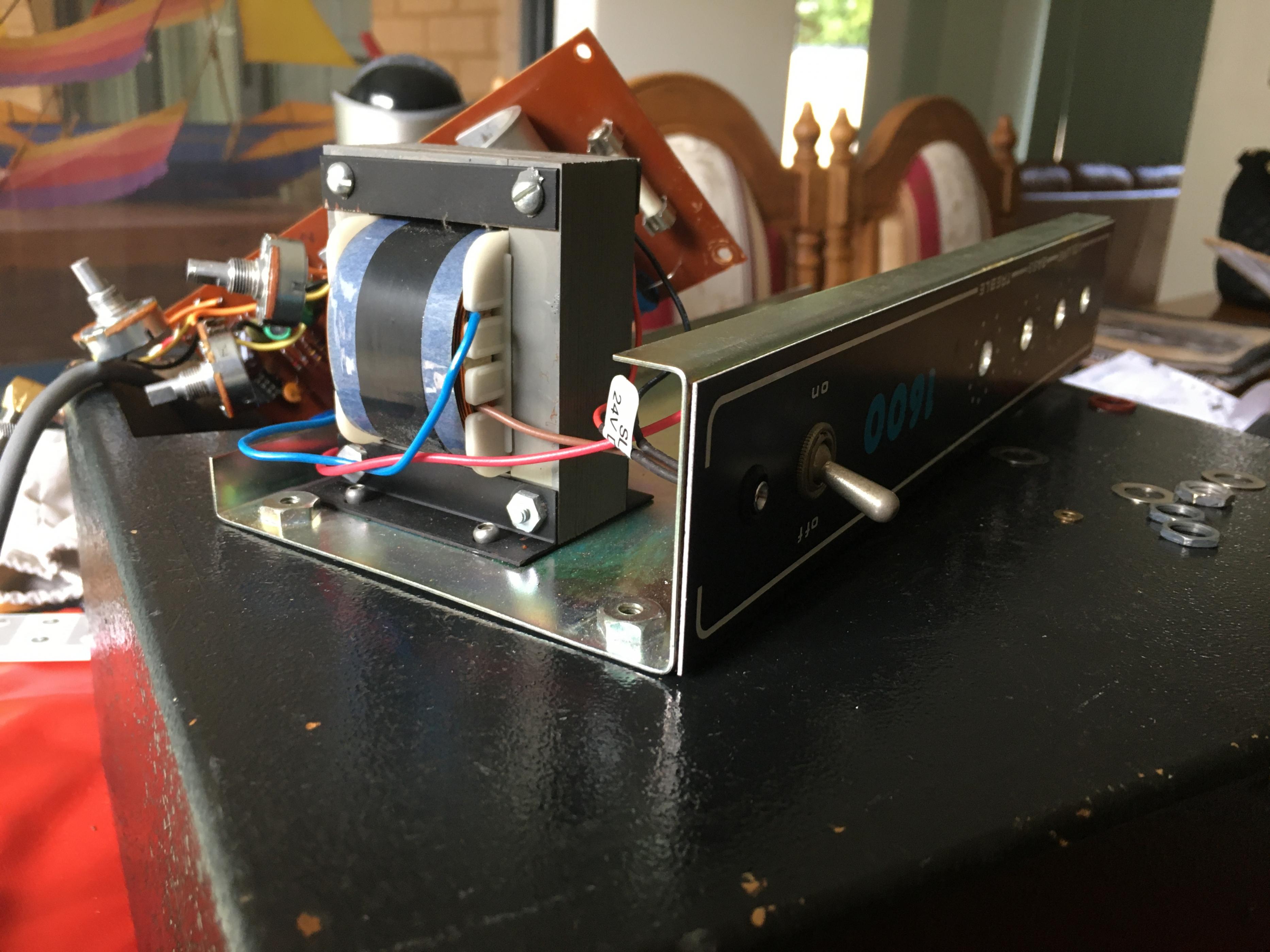

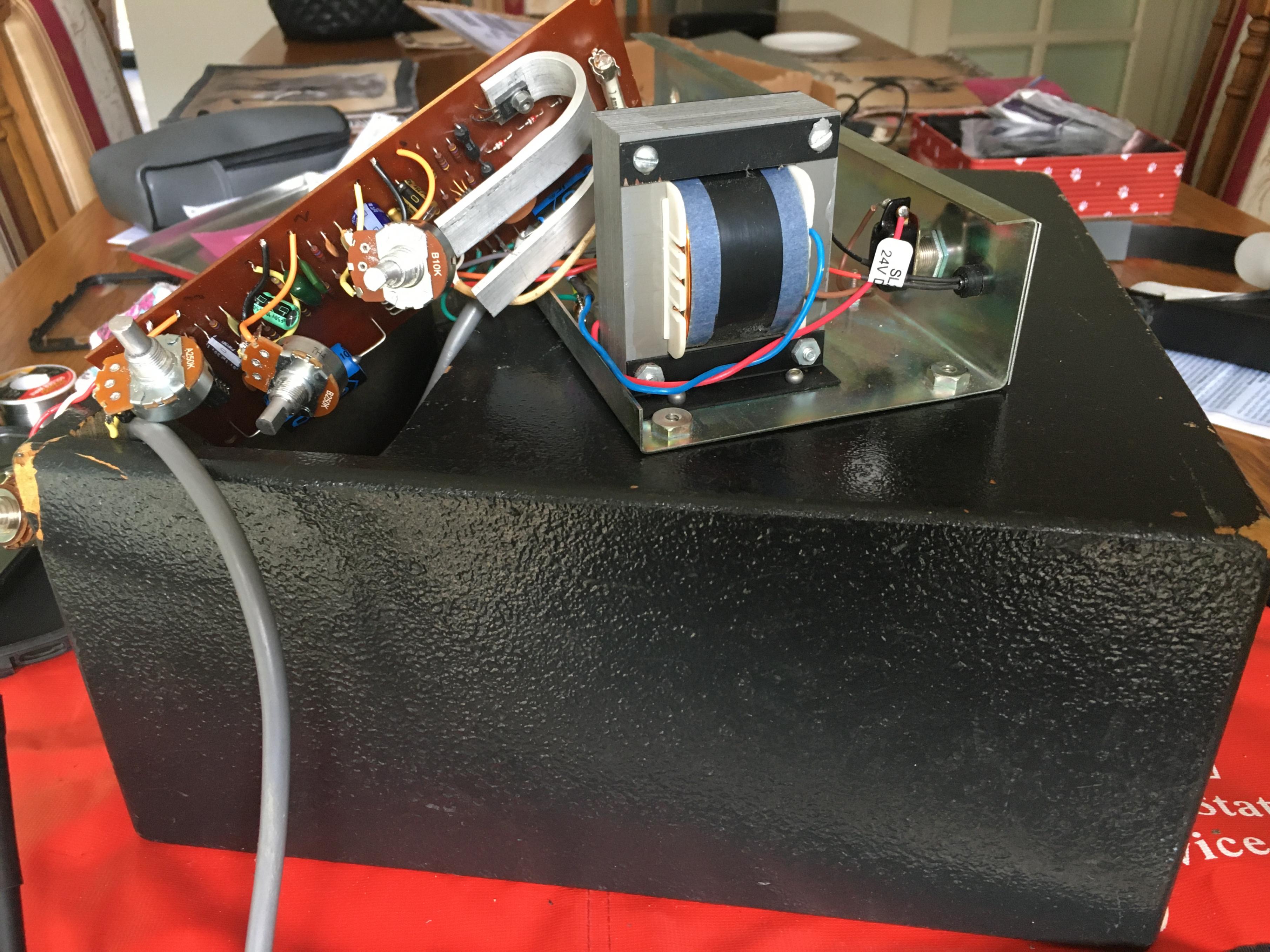

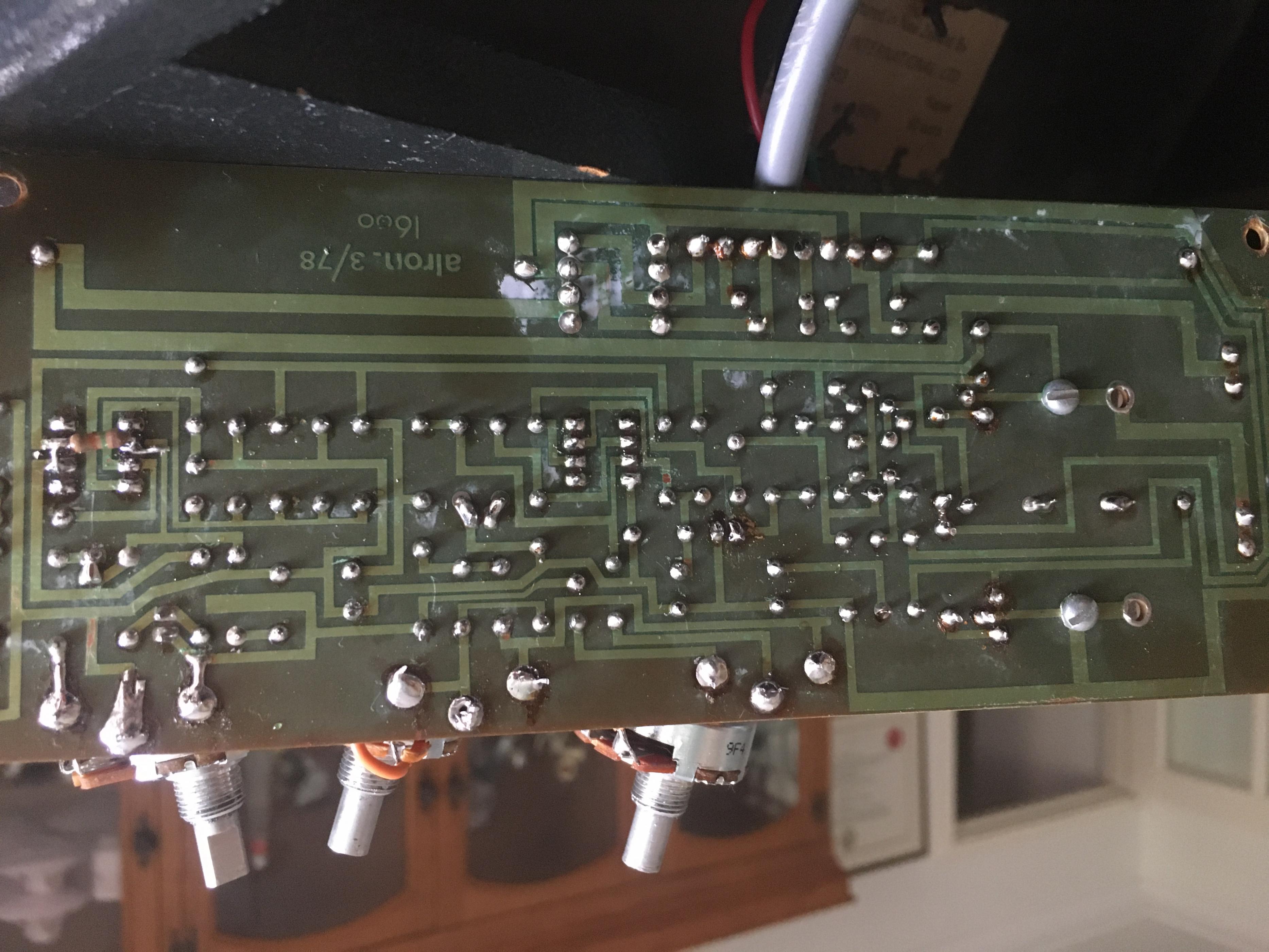

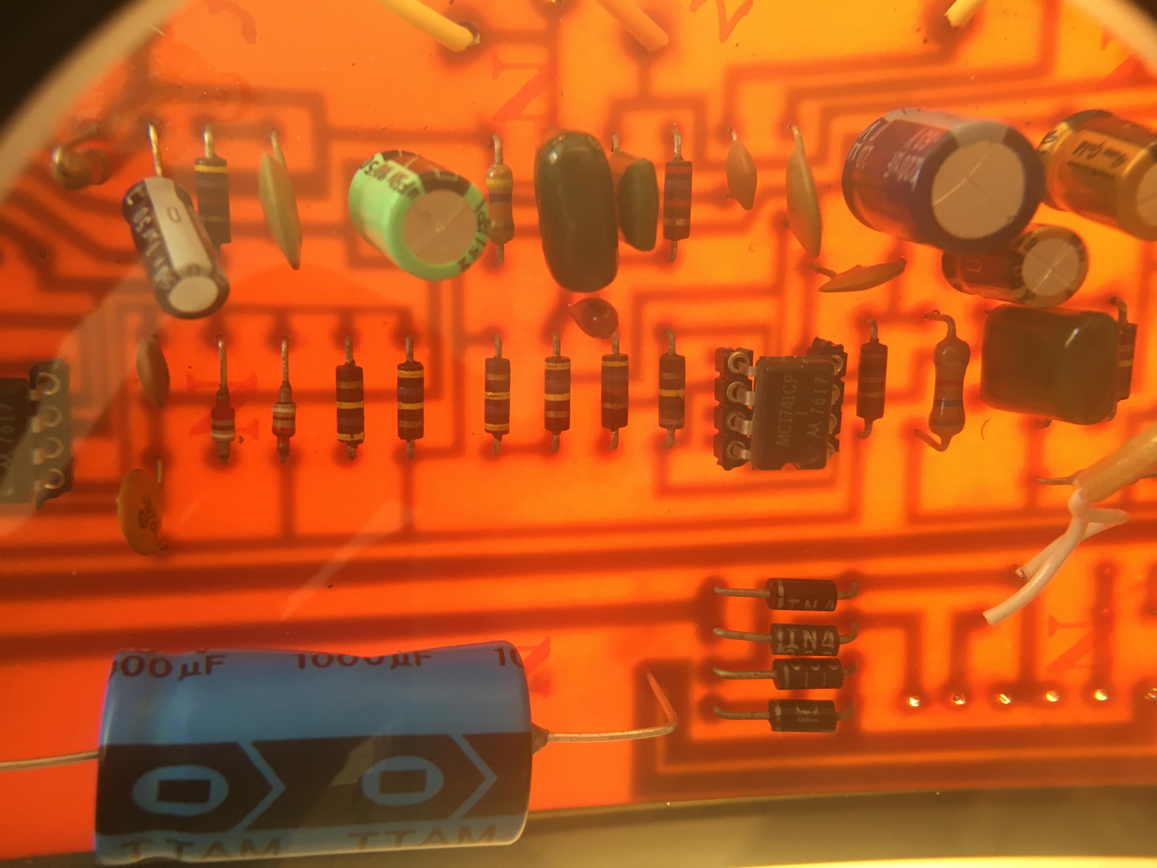

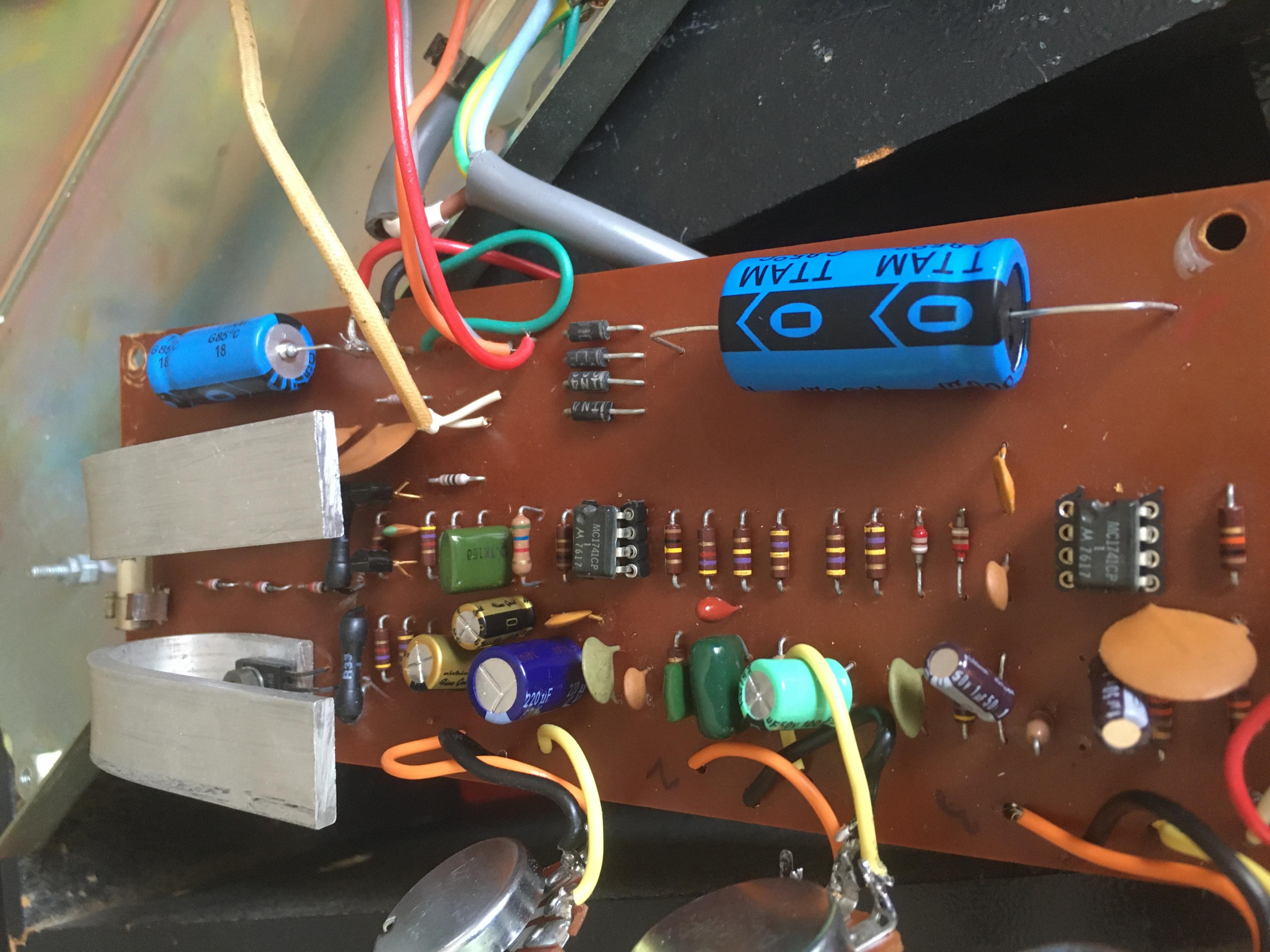

Hi srh, there are four transistors, two TO-92s and two TO-220s
The TO-220s mounted on the heatsinks are BD262 and BD263,
while the TO-92s are BC317B and BC320B. Pics are attached.
Thanks for the offer.
That will be 50W peak for one millisecond.
Nuryev, give me a couple of days to redraw the schematic to make it legible and I will post it up.

50watts?
Yeah! I also wondered about that. Probably explains the unusual heat sink design required to cope with the heat.
Gosh, they're pushing those little guys hard to get 50W [emoji33]

Alron schematic
Thanks for that - the effort is appreciated.

schematic
Hi srh,
Thank so much for the amazing effort!
I am impressed with the professional presentation and detail...
Do you have any ideas to improve this amp without compromising its authenticity or its character?
I haven't played through it long enough to know the strengths and weaknesses - but while i have it apart and a box full of caps, resistors, inductors and potentiometers.....your schematic is giving me ideas 🙂
Thank you again for the time and effort invested in supporting me with this project.
