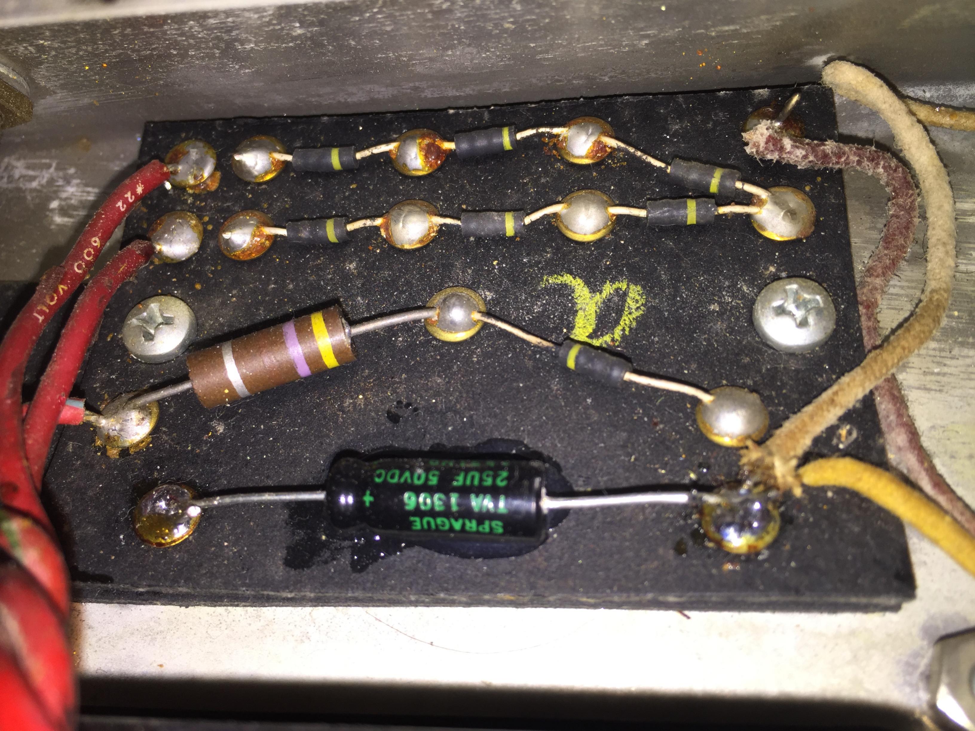

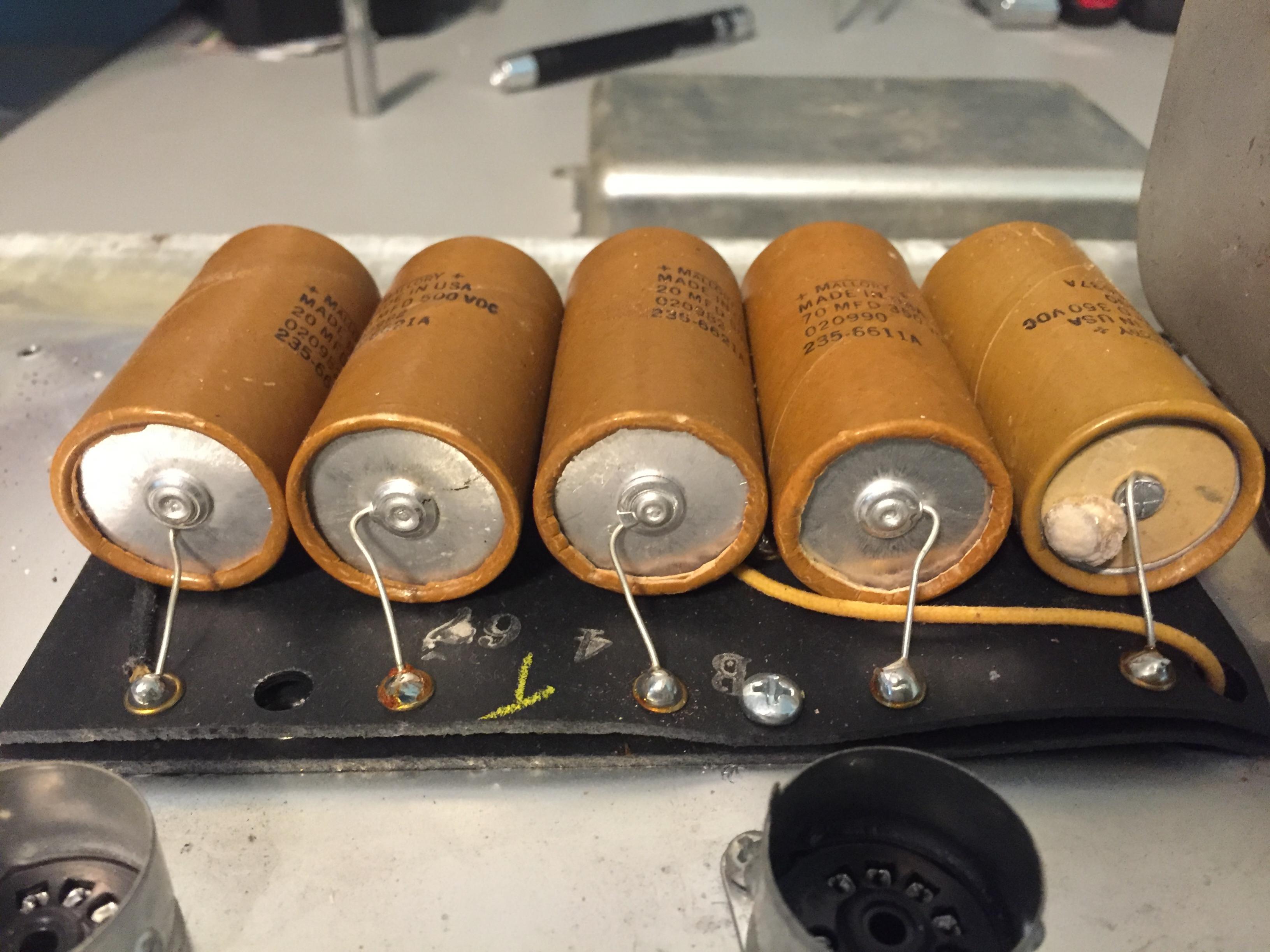

Now for the confusing part, i did the standard procedure electrolytic capacitors, omitted the ground switch and two conductor cord, and a the resistors on the power tube sockets as they looked slightly burnt, even though they were within spec. I tried it, and got no output whatsoever.

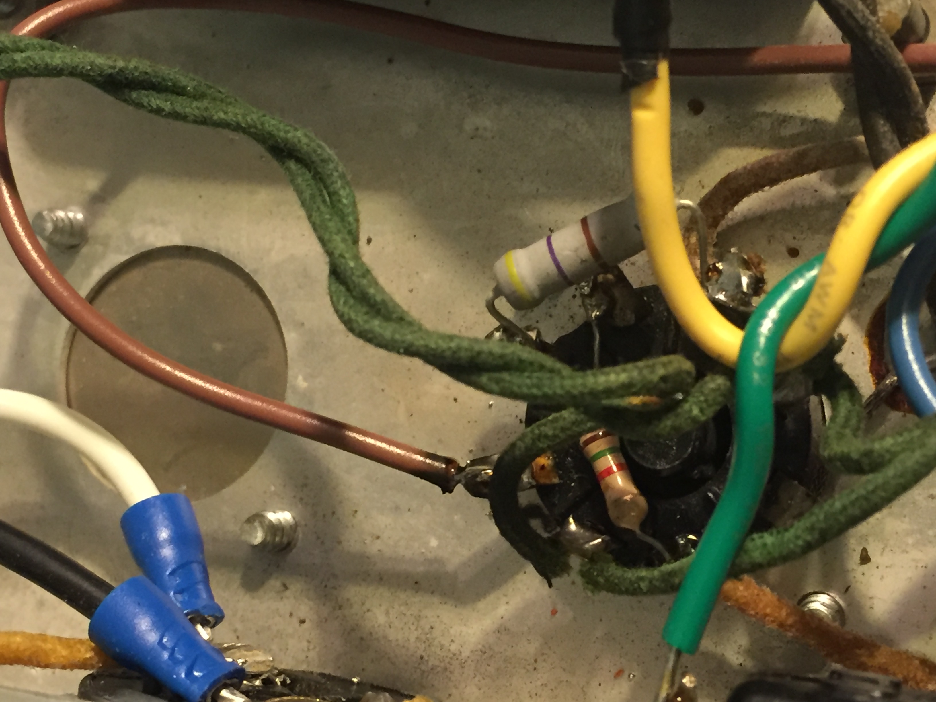

Got it installed, and realized my ground switch only works on one position. Nbd, ill order a new and for now leave it at 4 ohm output. went to check voltages without tubes installed and popped a fuse. I was under the impression you should be able to check voltages wothout tubes installed, is that not the case for a SS rectifier? So anyway i thought maybe that was the case(apparently not lol), and decided to install tubes to check voltages. I had a load i though was a 4 ohm cab attached to it (turned out to be 8) and guitar plugged it noodling until it warmed up and when it did tone was Inredible. Played for litterally 15 seconds, reached to put the guitar down and grab my meter and sudden the insulation on the brown wire of fhe new OT caught fire.1st 6l6 tube socket, pin #3. I hit the switch in seconds flat and once i drained the capacitors ,measured the OT resistances and choke everything seems fine, and the wire is just slightly charred where it caught fire momentarily.

I appreciate the concern, and agree saftey is the utmost importance working with any electricity, especially high votage! I assure you if i wasn't 100% sure if my ability i wouldnt touch it with a ten foot pole. As far as finding the underlying fault i thought i found it with the original filter caps bubbling, but i now wonder if this larger problem may have contributed to some of that issue.
I replaced every electrolytic as well as the resistors on the filter cap board, retube as well as the new OT now. I started with a thorough check before the post(twice), but hopefully its just something simple I've overlooked... The new uf4007's are on there way from amazon as well as the socket for my limiter im going to build so i guess im dead in the water until i get that all straightend out.

I suspect it arced to the heater wire next to it. Are they as close as they appear? Any darkness on the green cloth? This could happen with or w/o tubes installed in that amp.

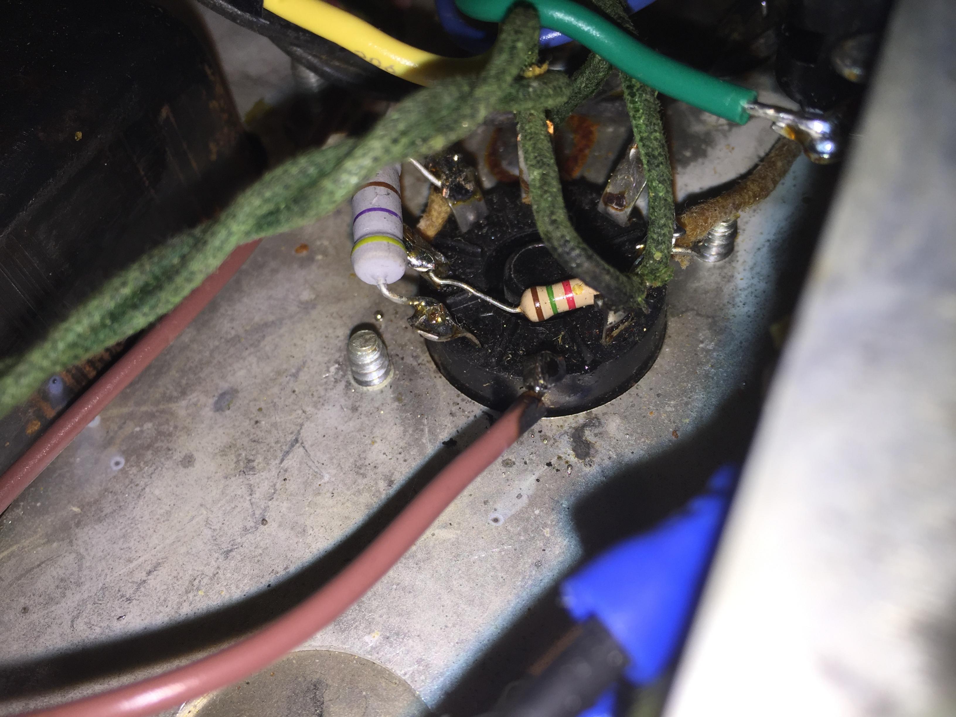

Yes you are correct that wire is blackend and from the angle does look shorted, but it wasnt making a connection, and i believe it was only slighty blackend due to the momentary wire insulation fire. It actually almost looks like it shorted to ground in the picture ive included there is a small black spot below the tube socket.

The normal voltage on that brown wire is about 900 volts when the amp is playing loud, but not clipping. Drive a Bandmaster into clipping with a fuzz pedal set on KILL, down on the 6th string where the speaker goes resonant, and you can have over 2000 volts on the brown and blue wires. The area where these wires connect to the tube sockets MUST be clean and nothing else should be near it. The green wire is the most likely place for an arc to jump to.
If the amp had been abused in the past (likely since the OPT had been replaced) the 6L6GC sockets may have carbon tracking. This is where some of the phenolic material has been burned into carbon and has become conductive. This usually happens between pin 3 and pin 2 inside the socket, or where the solder lugs are. This will blow fuses, and sometimes power and output transformers and diodes. Amps kept or used in damp places are worst case.
Often you can see smoke, burning, white or yellow glow, or fire coming from the area between pins 2 and 3 from the bottom of the chassis when the amp is powered up. Sometimes all the burnt material can be scraped away, and the socket cleaned up, but the proper cure is to replace both 6L6GC sockets.
The little black diodes in 60's Fenders are prone to failure, but once they blow, they remain dead. If your amp has B+ voltage, and doesn't blow the (correct)fuse instantly on power up, they are OK.
