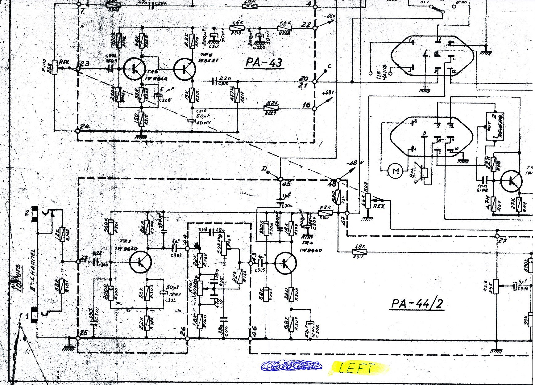

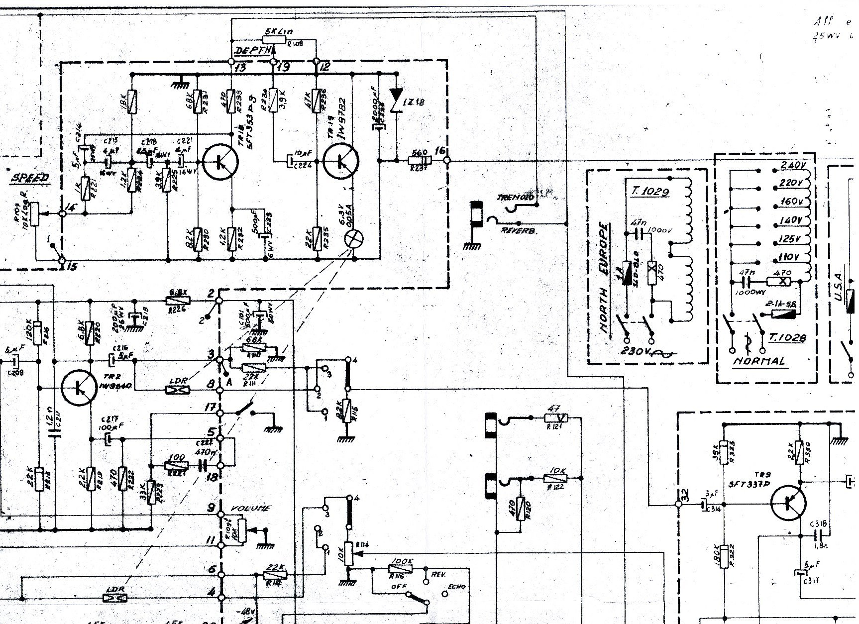

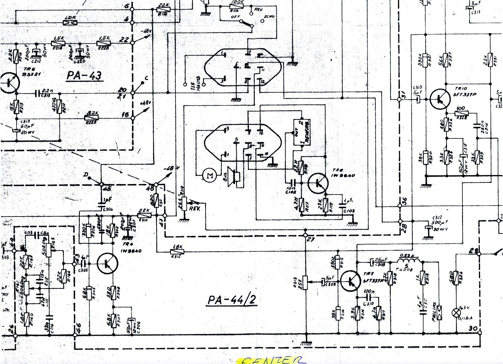

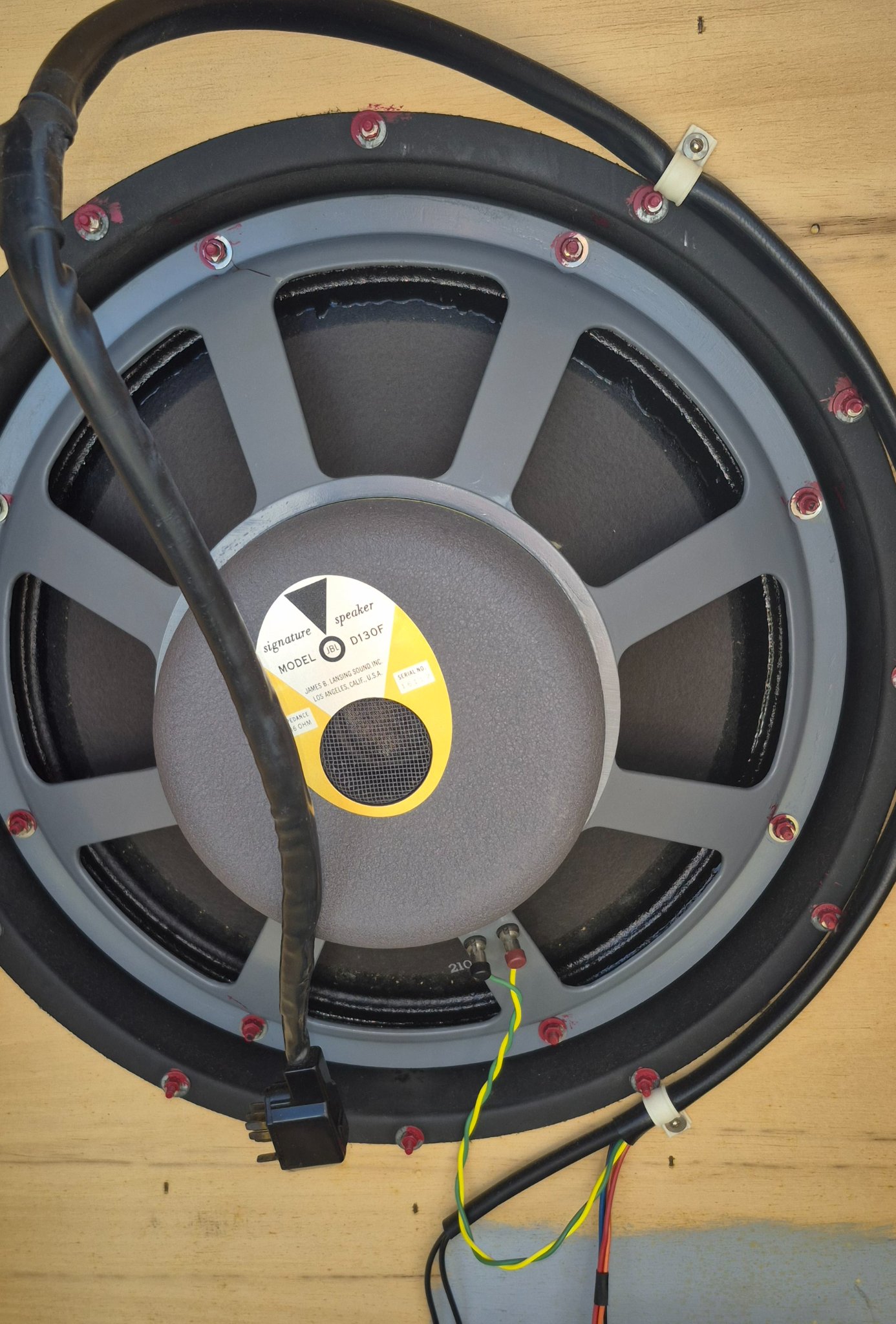

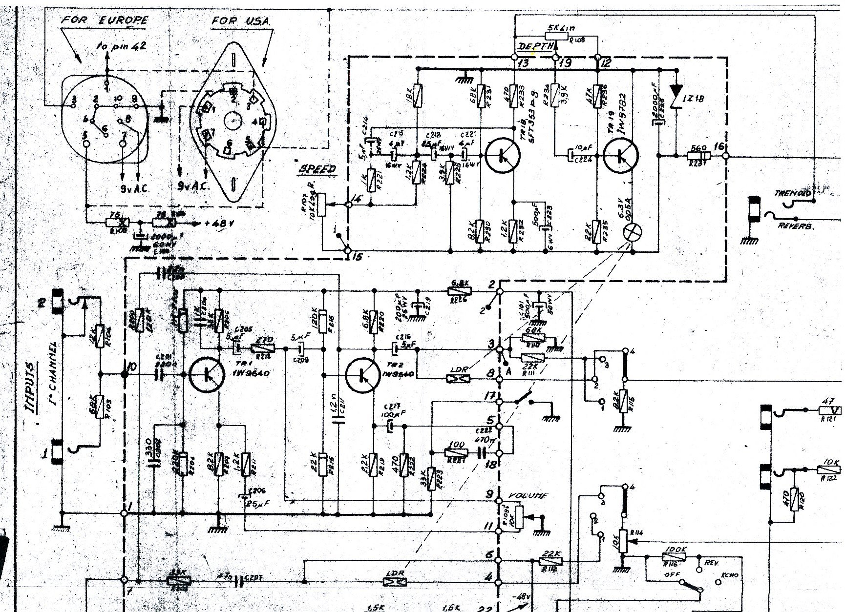

A few weeks ago I found this random cabinet in a dumpster that somebody alerted me to. It was a pristine farfisa cabinet for a br-80 amp combo. A whopping 80 watts of Italian made germanium-powered instrument amplifier, with a very nice pristine JBL d130 in the cabinet along with a tell Ray oil can Echo unit. I found the actual head unit on reverb in non-functional condition. I bought it and had it mailed to me and got it functioning straight away. A few weeks later I got an actual schematic and went about shoring up any other Loose Ends. I now have the unit as restored as can possibly be, thankfully to my large collection of germanium transistors that I've accumulated over the years. But it still has a rather present 120 Hertz hum, which is entirely from the power unit, as with all of the inputs shorted or even with the input cards removed the home is still there. I realize there is a lot of possible reasons for this. For instance that this was a unit made for 110 volts now getting closer to 120, and the age of the amplifier possibly having some incongruities. I figured there has to be some way to balance the hum, as I have seen on a lot of other amplifiers. I recapped the whole thing, or at least every electrolytic that was in it. I read some post somewhere that said that the Falcon caps that were in these things were usually pretty stable. That's complete nonsense by the way! Any capacitor from 1967 that I know of is in no way stable! Certainly not in an 80 watt monster from this era. There were very few solid state professional amplifiers back then that were 80 Watts. I'm wondering if they were limited by the state of the capacitor technology of the time, or the state of tech in Europe and Italy to be specific. If made nowadays if they would have capacitors with several thousands of microfarads versus the highest being I believe 1,000 or 2,000 in a preamp circuit. I think most of the larger capacitors in the power amp were only about 500 to 1,000. And a lot of those were hooked up in series with others which would make them lower. I'll include a few pictures and a YouTube link and the schematic that I scoured the planet to find! Thanks for all of your help and information in advance, though I know this is kind of a big ask! Also I'm trying to figure out how to turn one of the record heads in the Echo unit into an erase head, as I have heard of erase heads in these, but not being tape oriented I'm not sure what any race head would be!? I don't even know how they bias the record heads on this particular unit beings it is recorded via electrostatic energy and the regenerated Echo is gotten by simply not being erased entirely on the first pass. This unit is also significantly brighter than the others I've heard, and I made it even more so by speeding it up a little bit by increasing the width of the motor Drive pulley.

JBL D-130 !! and a oil can delay in the trash !!! WOW good find.
whoever put it in the trash should rethink their lives completely.

Hum could be ground loops, input jack usually grounded to chassis and output jacks.
big old loop sometimes. The so called " death caps" get removed they hum even more.
Can put the death cap back in using line rated X2 capacitor.
People can call them what they are, noise remover cap.

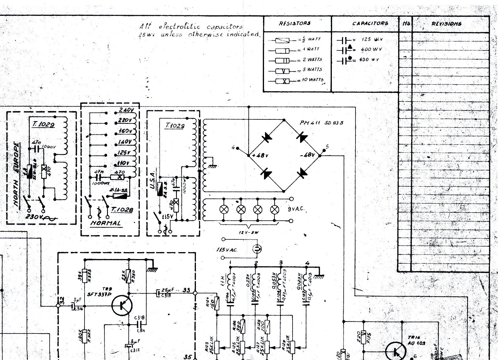

Or rectifier giving out, seems you changed the main caps?
Check solder joints or traces, probe and push around with a chop stick to find loose connections

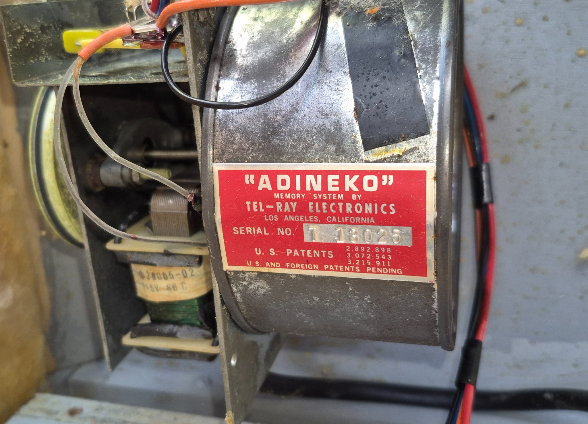

Depends on oil can model dont think they had erase heads, my morley oil can had feedback control
like typical delay. Should be a site for oil cans, can check the oil or add fresh stuff to wake it up.
For a long long time it was a mystery what it was. And people added all kinds of stuff like wd40 or sewing machine oil.
No no no dont ever do that, will ruin the disk. right fluid made by Ucon , LB-65 oil. Some conductive oil for aerospace.
You had to buy 50 gallons of it. Some group figured out a way to finally get a gallon or so, And sell small amounts to refill the cans.
Far as I understand, spinning disk gets thin coat of oil, the conductive oil similiar to magnetic tape recording, self erases after a few spins.
Some had set delay others had a knob which physically moved the head in the can, external circuits can add feedback for repeats like typical
analog delay. others where just preset for a more reverb type effect.
I have been on the oil can sites, but I've since heard from other members that the erase heads were not exactly effective on these. Probably because the actual contact between the heads and the disc is not intimate but through the oil and rather random at that. I'm kind of lucky that mine gets the frequency response that it does, as most of them are very dark sounding. I sped up the speed of the disc with the motor run pulley, adding a little more mass to it. As for the hum, it is definitely the power amp causing it. Not sure if this one had a death cab or not, it seems to have had a three-prong power input, although the ground wire was terminated when I found it. The rectifier is new as I removed the old one which was silicon, but ancient, with lots of cooling fins on it which wouldn't really be necessary these days, and put in a full wave rectifier, as the original was. That seemed to calm it down a little bit, but there still is an obvious 120 hertz. But with no master volume, that 80 watt amplifier is always coming through with full potential. Not that a typical amp wouldn't be that way either but, it seems like it's a little bit more primitive. Just not sure on this one. I have a feeling that there's something out of balance perhaps, maybe likely the outputs themselves! I'm not sure if adding more capacitance would help or make it worse. Do you think this thing would have had some kind of noise filtering death cap sort of thing just for the sake of quieting it down? I've got the schematics but they're in pieces. I can put the pieces up I suppose LOL.

And yeah, I'm aware of most of the oil can lore, and beings that this was hermetically sealed in a speaker cab, it had all the original seals in tact, and all the original oil. I added a little 65w pag oil, and that made it work. Too well! The delay regenerates over and over. If you check the video link I left up there, you can hear it and it's very bright, and it seems to linger forever sometimes. Maybe the mixture I have in there is a little too insulative, and the charge stays on the disc too long! But I'm not quite sure how to make it stop saving the charge as most of the time people have a problem with just the opposite. One fellow in one of these sites said that if I were to add a few drops of water to the mixture, it would release some of the insulating effects and that perhaps mine had because of the perfect seals, never absorbed atmospheric moisture, because the l65 oil that they used originally was water soluble and would literally attract water out of the air, and that that was the reason that the charge could be stored and then released, because the oil is a dielectric which is an insulator by its nature, but the molecules of water within the oil are what releases the charge. I'm kind of thinking out loud here. Just because I'm a little bit reticent to throw a few drops of water in the thing! It's in such perfect shape! But if that made it Echo last long, I guess it's worth a try!
I would kind of like to hear another working version of that amplifier. If I could hear another one that made this particular level of hum then I would know it's more or less normal. Germanium amplifiers were never really considered that amazing. And given how loud this thing gets, it could very well just have that inherent noise in it. I can think of almost no amplifier out there that ever used all germanium preamp and outputs that reached 80 Watts or even near that. And it sure as hell reaches it! The only amp I know of besides is the early Mark 1 Fender Rhodes suitcase amps. While mostly silicon in the preamp and driver Stage, the outputs on those were all germanium, so a lot of time is when they go down, they stay down! I'm lucky that this one is working as well as it is, I suppose. Although I never could get the vibrato to work!

What are the output transistors ?
Schematic shows AU103 being used as driver and output. It’s almost the classic transformer-driven totem pole output stage. Interesting twist - the output stage is a stacked series stage like on the Ampzilla. So they started doing that before they even had silicon, let alone PNP silicon. That would get you in the 70V, maybe 80V range on the supply - which would get you 80W at 4 ohms. With strong enough transistors. A regular classic Ge stage is limited to about 40V due to poor second breakdown capability of Ge.

Yeah, i was surprised that it lived up to it, even all these years later. I didn't have to replace the outputs, just caps and a few preamp stages. The noises it made before being fully on line were pretty epic! The head looked like a haunted house! Like a crypt, with lots of old Falcon caps in their final death poses, bloated, leaking, split. Carnage! Old, very smelly carnage! Lol
If you like electrolytic cap smell, try selenium rectifier smell. About as toxic as beryllium, and P-U. With amps like this you usually just replace ALL electrolytics. I’ll give old Sprague’s a chance at least (some hold up surprisingly well).
Those old classic Ge output stages aren’t what usually fails. With that driver transformer it is well isolated from everything else which usually does fail. Most often I see a dead driver - but here they used the same as the output type giving it a lot of design margin.
