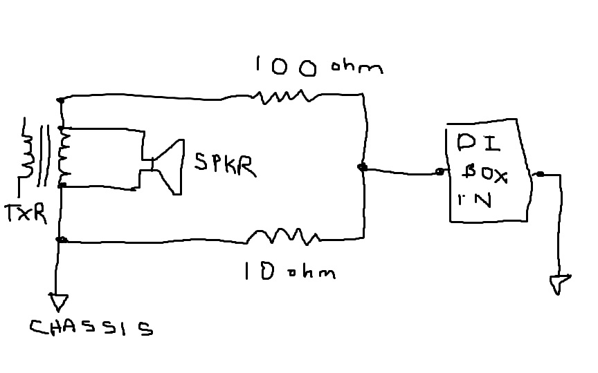

I still gig with my original '65 DLR and have been mic'ing it to the house mains. Open mics can cause their own problems so I'm hoping someone can offer a recommendation on how to tap into the speaker output and take a signal that could be padded down to feed a mixer without damaging the amp or degrading the quality/volume of the amp's internal speaker.
Is that possible? Or should I just be resolved to stay with mic'ing the amp?

If you plan to use still have the speaker connected while creating a line out level then parallel the speaker with two resistors........a 100 ohm resistor connected to the hot/tip in series with a 10 ohm resistor to ground/sleeve. Take the "line out" connection from the junction of the 100R and 10R resistors.
If you plan to not use the speaker then you will have to disconnect the speaker and rig up a wire to connect a properly rated 8R resistor. Repeat the above steps with resistor.

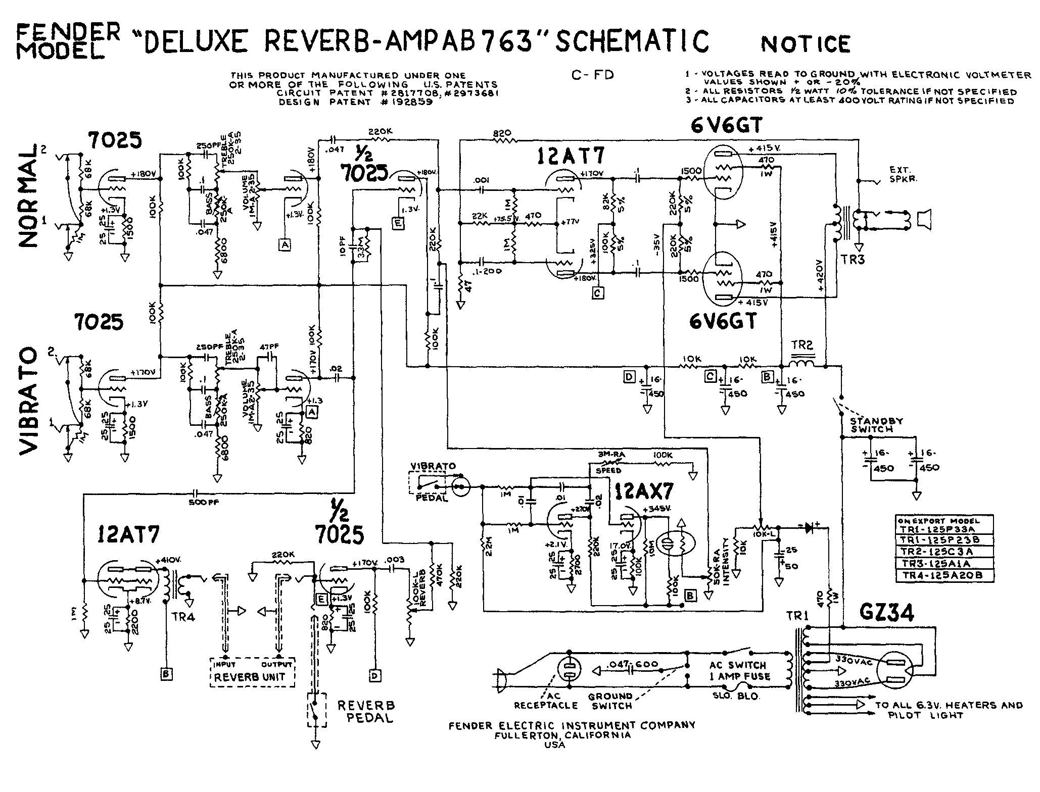

Thank you very much! Just so I'm clear I've attached a very crude sketch of what I believe you are recommending along with the DLR amplifier schematic. Have I understood your directions? Also, what wattage rating should the resistors be?
Thanks again.

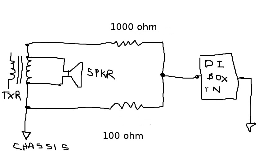

Your drawing looks to be correct. I would use 5 watt resistors for the value resistors I provided in my previous post (100R/10R). If you are using a DI between amp and soundboard then you can use higher value voltage dividing resistors like 1k/100 at a 1 watt rating.

Thank you for your feedback and suggestions. I appreciate that the speaker adds it's own "color" to the final sound. I am using an AKG condenser that I'm happy with. I was looking for an optional alternate method to the desk. I have a couple of isolation transformers (and commercial DI's) that I'll try. If I end up with ground loop or RF hum I'll stick with the mic.

Many commercial DI boxes have 2 settings for the input level: "Line" which expects a Preamp Out (around 1 V RMS) and "Speaker" , which accepts around 20V RMS
