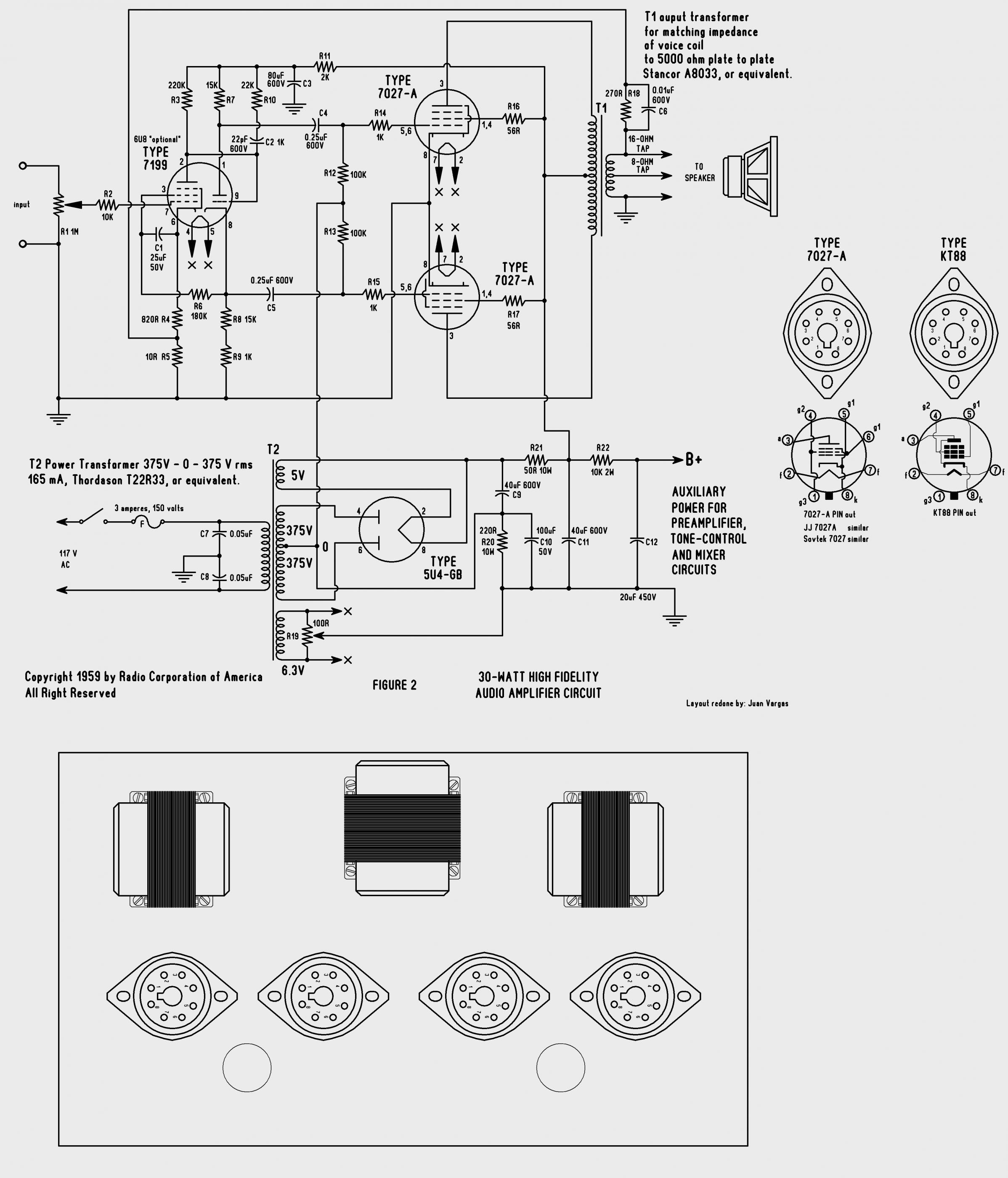

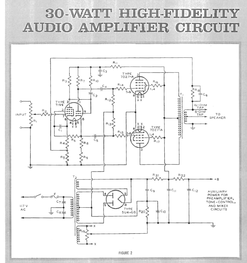

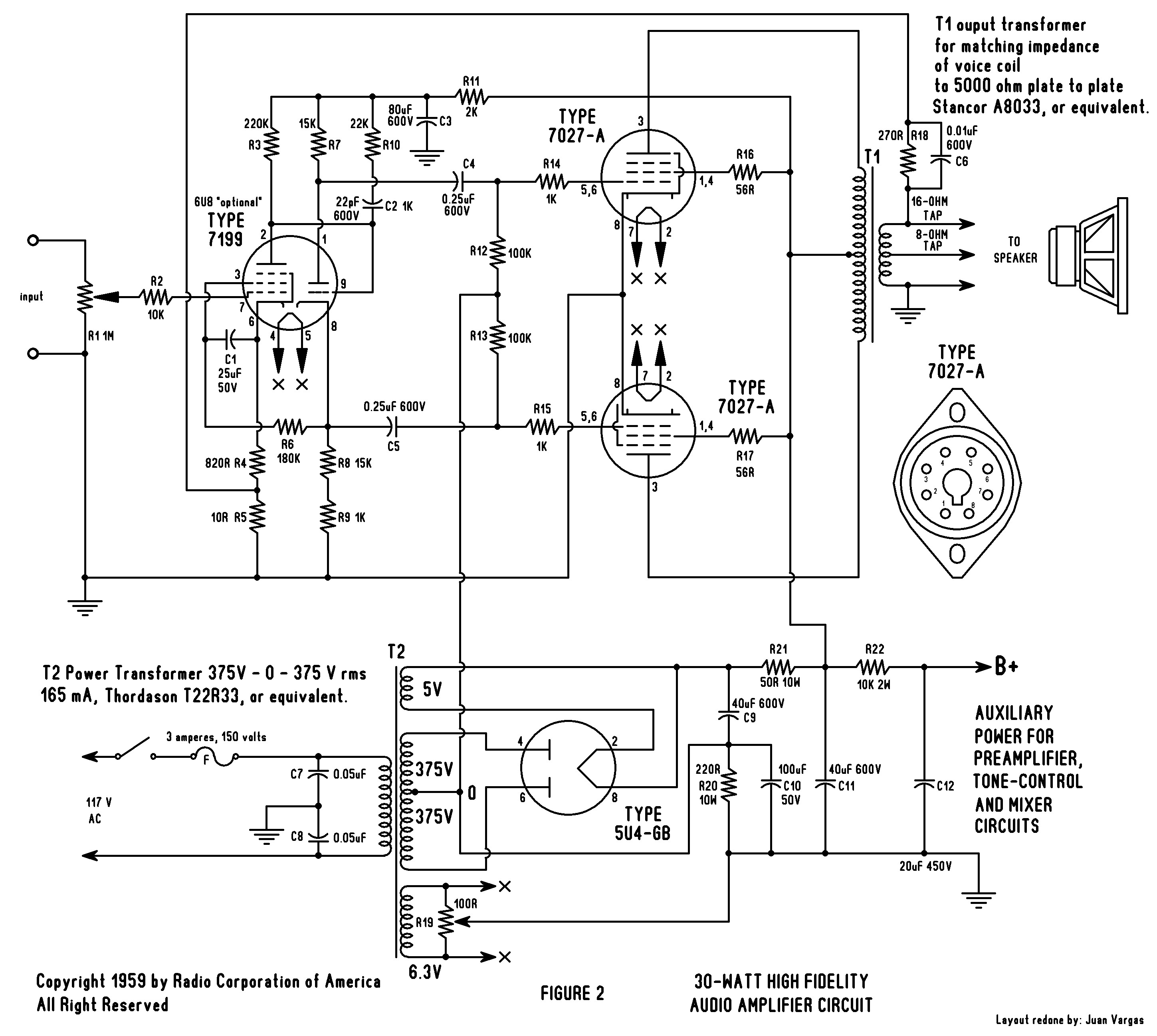

Hello guys I'm new to this about tube amplifiers and I found this schematic from a 1959 RCA book "PDF" and I would like to give it a try, I build solid states amplifier but also I like to learn tube amplifiers, I basically copied the schematic the best I can so if some one can help me out verified is all is ok on this circuit, and yes, I do understand that voltages on tube amplifiers are lethal and can be really dangerous but I'm aware of that I will be careful, "alligator clips all the time", I have found the correct power transformer yesterday and the tube too, the RCA 7199 if I'm correct is no longer in reproduction anymore, so the 6U8 is the substitution for it but just minor wiring has to be modified to fit the 6U8, the RCA 7027-A tube not sure about this I think it also can use 6L6 tubes not sure, about this schematic I just need to know if there is something that might be incorrect or if there is a wrong power supply voltages, I copied the best I can, but I will really appreciate if some one can help me out verified is everything is ok I will leave the scheamatic here in PDF and image format if you want it to add or put notes to it, I will really appreciated any help.
Regards
Juan

Yeah, that's why I said you should copy it. It's proven and it sounds good. The one you posted may be a better circuit -it's anyone's guess. My guess is that it's not. Besides, the output tubes are not that common anymore. That ST70 web page is not mine by the way, just linked so you could see the schematic.
If you get Triode Electronics Dynaco ST-70 PCB board you will get the same type of circuit with easy to find in production tubes. They sometimes show the schematic also. You can run many different output tubes with some mods. Dynaco used a simplified Williamson circuit on all it's amps which that RCA also is.
Some of the popular Dynaco ST-70 boards out there use the Mullard 5-20 circuit like the Eico HF-87/89 & HF50 These are other circuits to look at. diytube.com sells PCB's for the Eico/Mullard type circuit. The Eiclone has everything on one PCB for the supposed to be great sounding Eico HF-87/89
Other popular PCB's with the Mullard circuit are sold by classicvalvedesign.com along with original Dynaco PCB's Tubes4hifi is another popular affordable choice. These last 2 companies have gone with SS CCS on their boards. dynakitparts also sells original type PCB's also. The last 2 companies also have all the Dynaco schematics and manuals on their web site also.
I think you may prefer fixed bias also. The Dynaco ST-70 & Eico amps used it except the HF-87 which is cathode bias and that RCA amp also has it. You get more power out of fixed bias also, but you do have to check the bias and set it from time to time.
All the aftermarket Dynaco boards are fixed bias.
The reason I brought up the aftermarket boards is that most use in production tubes and are well liked and supported. You could always find the schematic for them and do a P2P version if you want also.
Hope that helps!
Randy

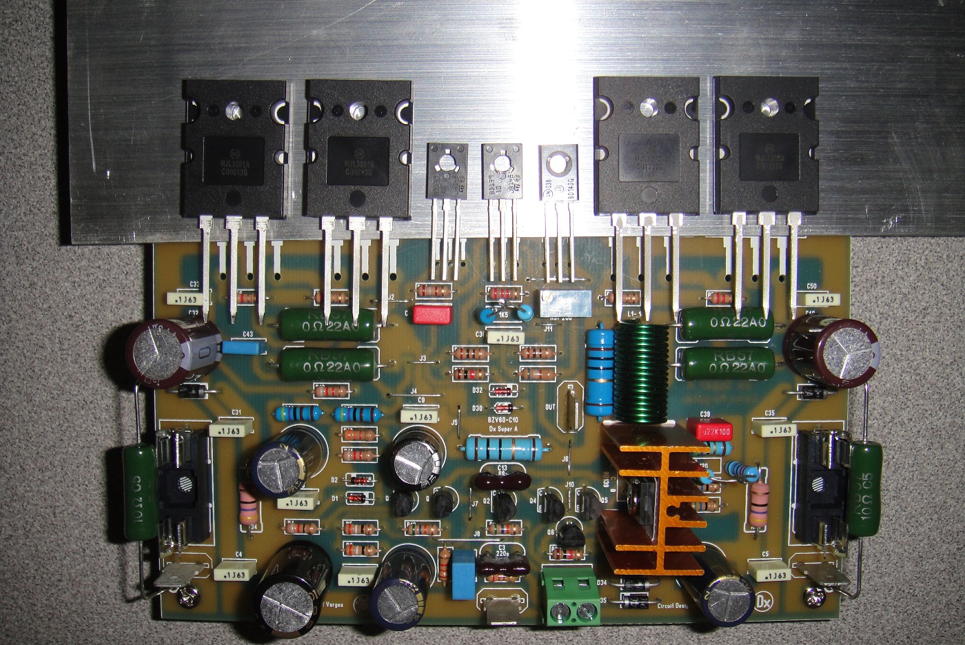

Looks like a nice SS amp!

just a note about the RCA circuit above: it uses a 7199 and 7027 which aren't exactly cheap, unless you don't mind the newer Russian stuff. Personally I would something cheap like a TV Sweep tube, or something really common like the EL34.
Well, sure, if you're stuck on 7199 and 7027 you're going to pay through the nose, but as mentioned the 6U8A is ~$7 and the trusty 807 isn't any more than an EL34. For ~$7 I bet a 1625 even works here, if you're willing to buy the special sockets and accommodate the 12.6V filament. If you're really worried about plate dissipation you could go with the 6BG6GA, still no more expensive than the EL34.
It's an intriguing circuit with a modest parts count. I don't see any reason not to give it a whirl.

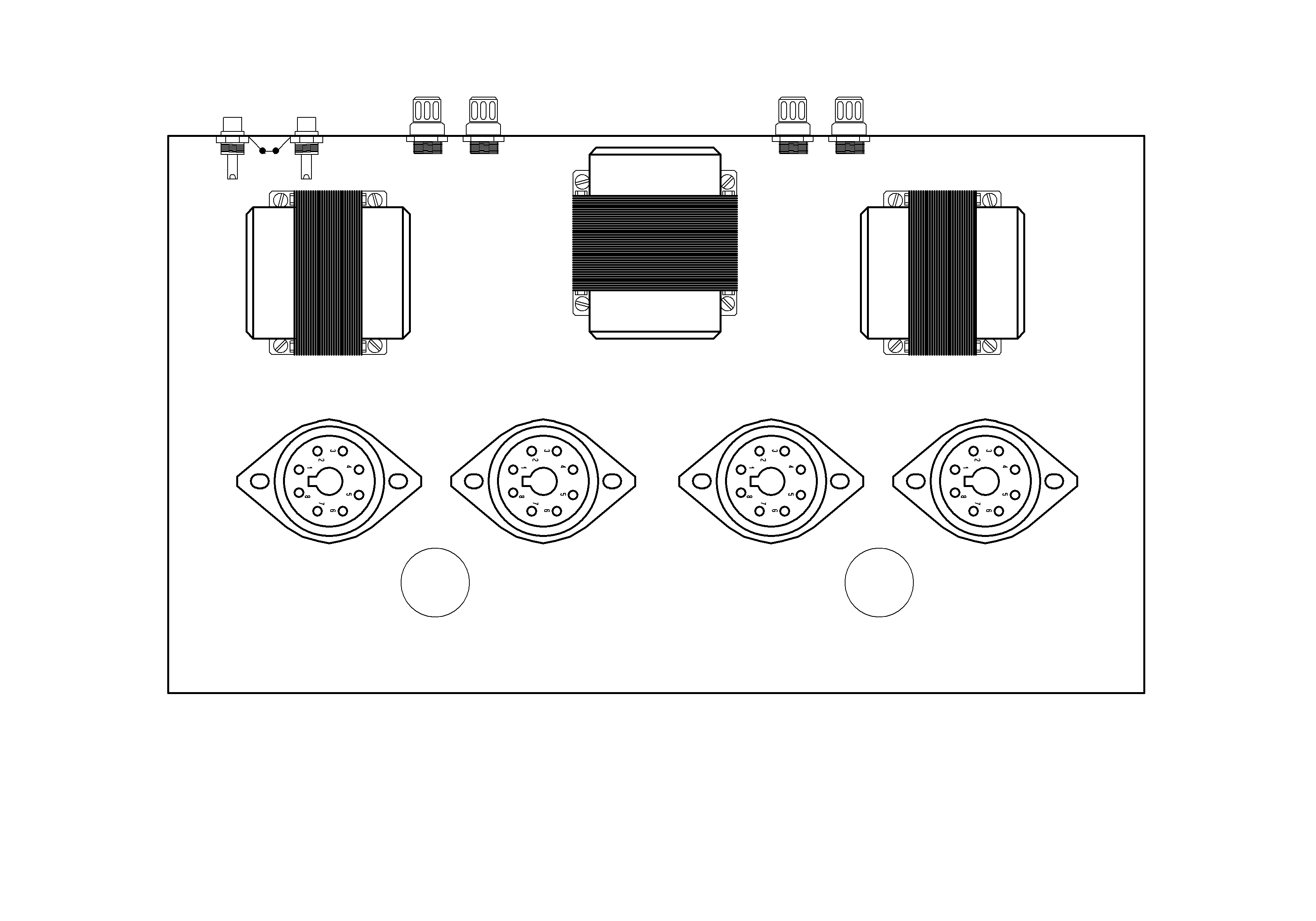

Well I'm putting together the ideas for this project, the budget is kind of high but this is not a "right now project" I will take me time understanding this circuit and other that are quite magnificent, for now I will go a step at the time, here is a "light idea of what I want a draft. I getting a a better understanding for different circuit, so I will studied a bit more before I try out to build it, parts, layouts, filtering, and so on, I will then make a list of " parts for that can be find easily"
if according to my budged is getting to hight I will consider other circuits but for now I have found like the mayority of them, ok thanks again for all the inputs.

I just find out that take time to figure out how to layout the wiring and connections so what I do I "virtually make drawings to see how it looks like first this drawing is not completed yet maybe later will change many times, but I think is a good star for now, I will keep updated this project a bit at the time.
Regards
Juan
