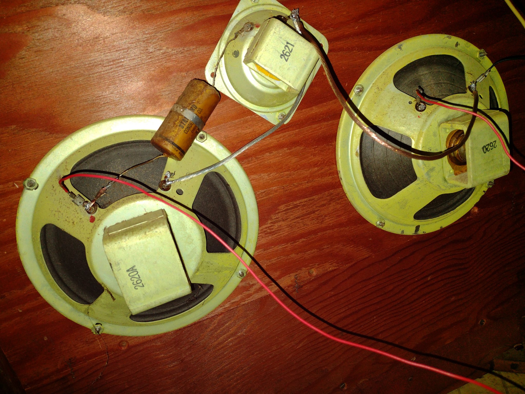

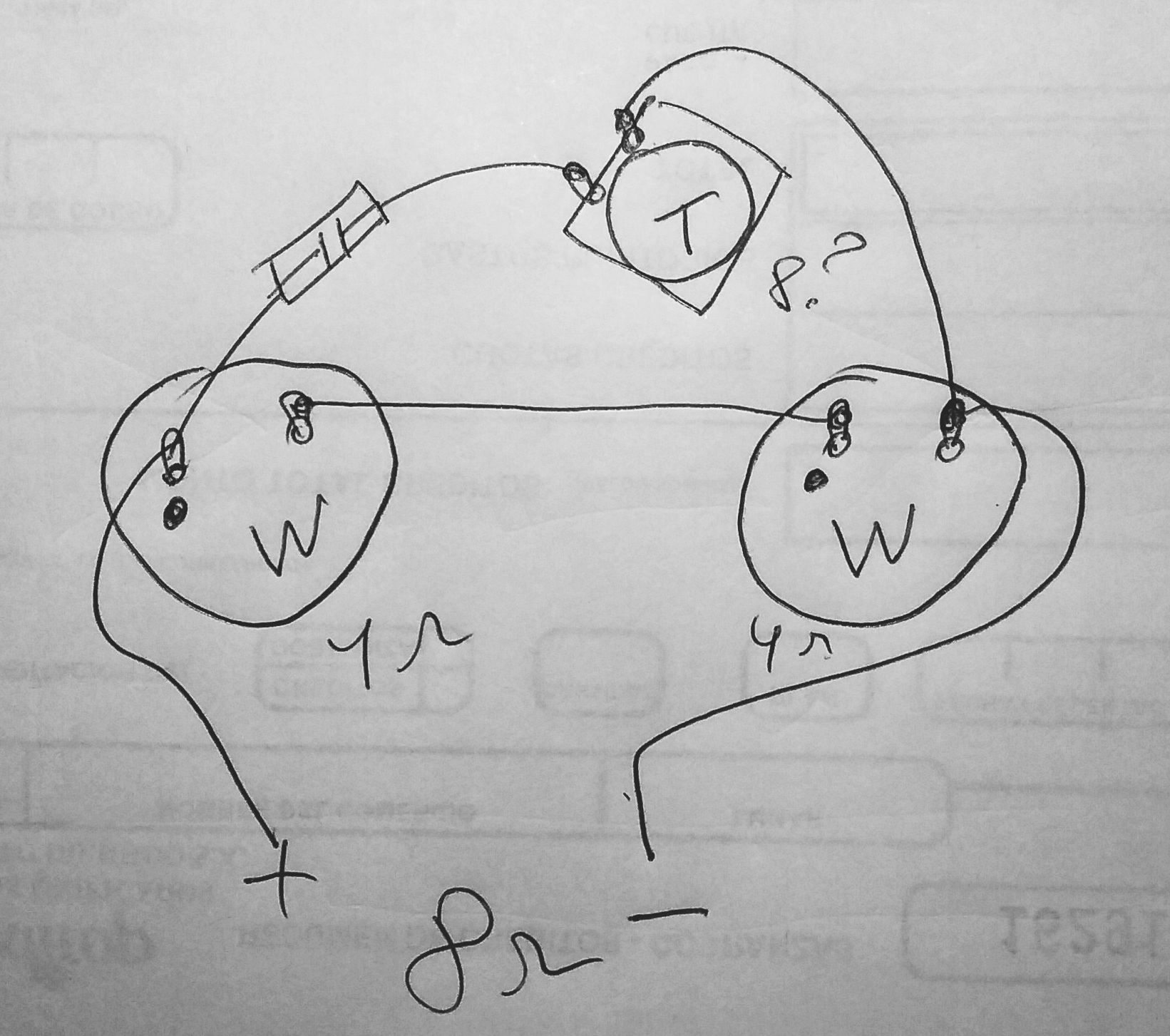

Do the red wires on the woofers connect with each other and then to the amp?
Does the black wire on the right hand terminal of the right hand woofer also connect to the amp?
The red wires go to a switch for console/external speaker selection, and then to the amp. This was indeed the Deluxe model boasting two woofers, and three alternate inputs for Tape, Tuner, and an Aux input. The 4p2t input selector switch has finally given up the ghost, so it defaults to AM RADIO
