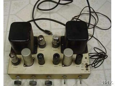

I was looking for a good DIY amp project to get into tube amplifiers and found a 1954 Regency HF-150 on ebay. I figured that the bid price at the time was a good deal for the transformers alone so I placed my rock-bottom bid and actually won it. I've been scouring the internet for information about the amp but have come up empty handed. Has anyone heard of it? I've found lots of sites for amp refinishing with some really good tips but I need some specific schematics for this model. I'd appreciate some tips on where to look. Thanks in advance!

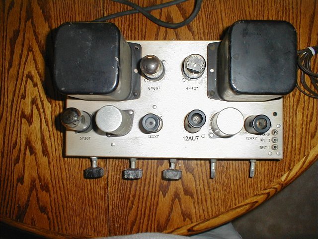

Alright- The amp finally arrived and it seems to be in good shape. The Sam's photofact is in the mail. I'm getting new can-caps from VibroWorld; they're hard to find! They're 20/20/20@450, 250@25 and I'm really not skilled enough to make my own. Being born in 1971, this is the first thing I've ever worked on without a PCB...
From the beginner's stuff I've read on designing tubes, I can understand most of the circuit and I'm working on my own schematic. What is the rationale for the 3 different pre-amp tubes? (see picture)

Great to see a young-timer taking an interest in these oldies. The 3 pre-amp sections are one for the phono preamp which, incidently, has several equalization modes. This amp was made right at the time when RIAA recording Equalization was standardized in 1954. Prior to that time, there were several recording eq's used AES, NARTB etc. The Wiki-pedia has some good history discussion about this.
The second tube has to do with the loudness circuit and the third 9 pin tube is a phase splitter for the push-pull output circuit. The grids for the push-pull outputs must be fed out of phase to each other and the phase splitter accomplishes this task.
