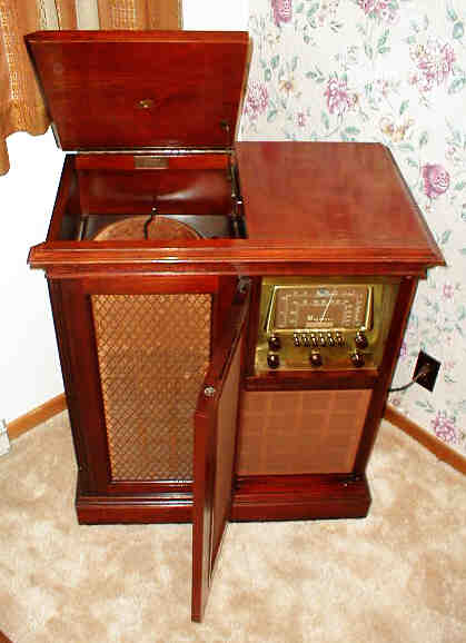

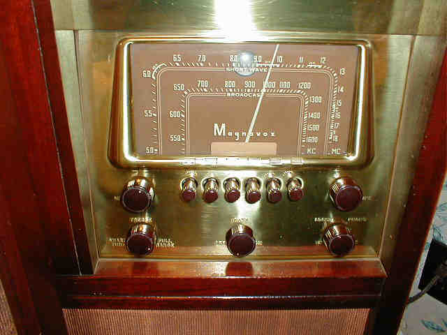

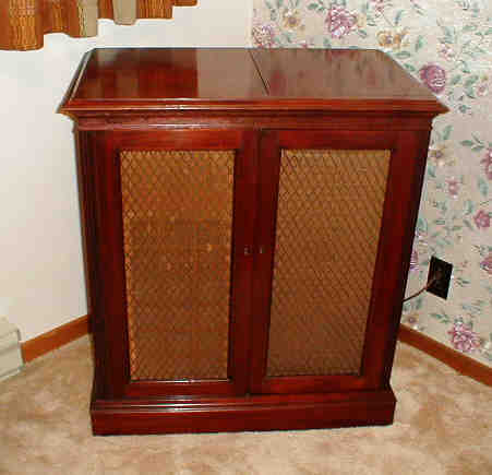

Those old console radios can be nice. The real hardwood cabinets are terrific. I picked up a 1948 Magnavox "Berkeley" at a US radio meet that has AM and SW plus automatic turntable. I think I paid $25 for it. The chassis has P-P 6L6's (making 18 watts according to the brochure) and drives two 12" electrodynamic speakers. Every tube in it was totally flat when I got it, yet it played on AM. I completely re-capacitorized and re-tubed it and it sounds great. Got lucky and did not have to replace any electrolytics. I did a long slow soft start with a variac. Needs an alignment though and it would be even better. Lovely cabinet!
Good luck with your electronic restoration.

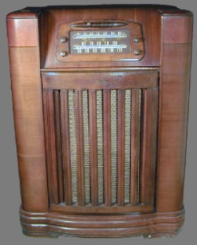

I have a 46-1209 and it's a great looking and performing radio. I got mine back in the early-mid 1990s in my hometown in Virginia. It still had and has it's original finish, back and preset station labels- which is cool because some of those stations are still on the air! I've since moved and that radio is in my living room and used often. Being an early post war radio,Philco hadn't retooled much from war production so, it still looks like a late 30s -early 40s radio.
I found it at the local fleamarket and being new to antique radios, I ran across an old retired fella that was a radio repairman back in the day and he became my elmer. He went through it and got it running in fine shape. Lots of capacitors to replace in that one and some are a little hard to get to. It had a bad band selector switch that he fixed for me. So, after recapping, changing a few resistors and an alignment, that old radio has been playing fine for all these years. I like this radio so much that I found a beater 46-1209 and got the chassis and dial glass from it for backup, just in case. heh
The turntable works, but needs to be cleaned and re-lubed. It also needs a new needle. The 46-1209 came with two different turntables. The D-10 and D-10A . The easier way to tell the two apart is that the D-10A has a shiney metal/chrome strip on the on the tonearm head. The D-10a has a magnetic cartridge and the needles can be found with a little searching, but are not common.
Getting back to the radio, the tuner is sensitive, the pivoting loop antenna works well and that big speaker can pump out the bass.
The only radio that could possibly replace it would be a really nice Zenith, but the Philco would just move to my home office room. Now that I think about it, that sounds like a good idea anyway.

Here's a photo of mine..
Good luck and keep us posted on your progress,
