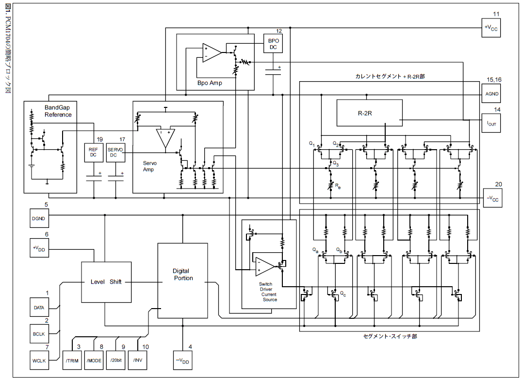

...PCM1704 is mostly active I/V only...
Here is a PCM1704 internal. This schematic come from ANJ1092
We can see that Iout must be kept as near as possible to zero volt. When you have chance to deal with +/-1.2ma use it! It's a very strange idea to use PCM1704 with output tension!
