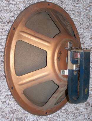

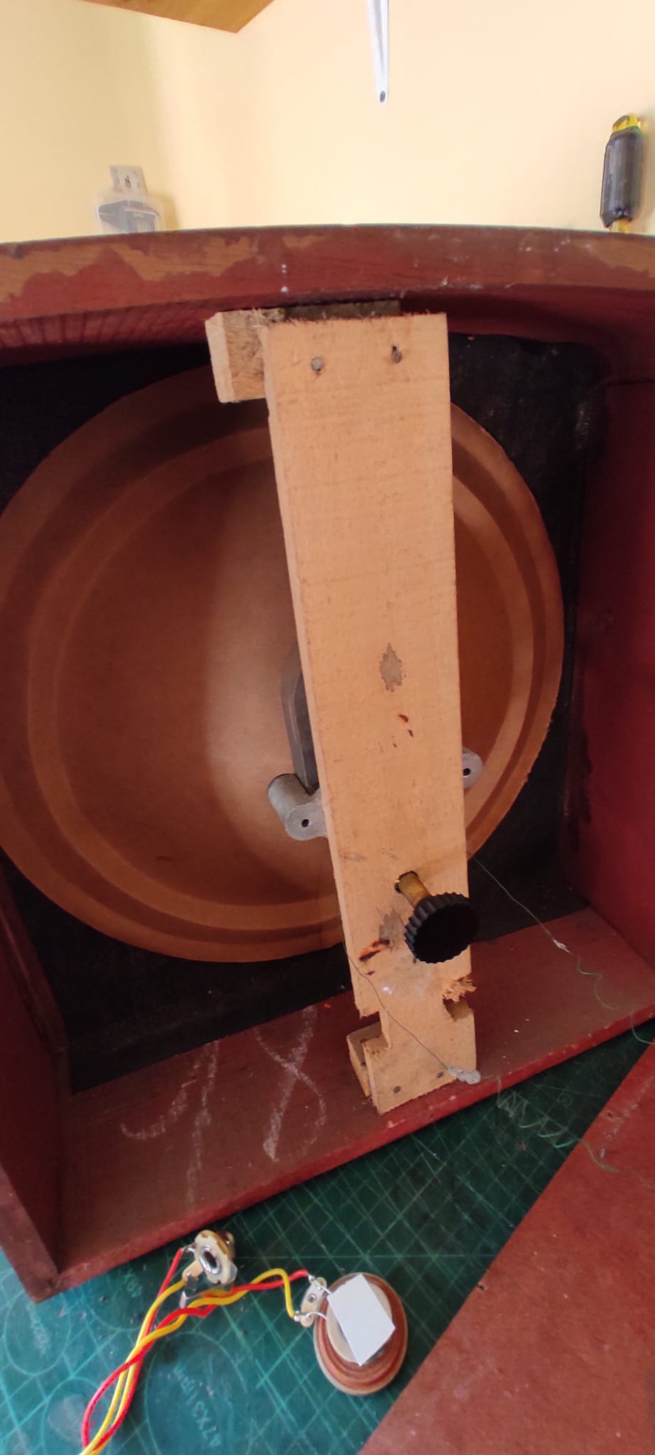

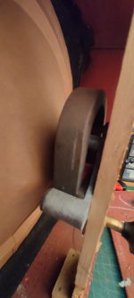

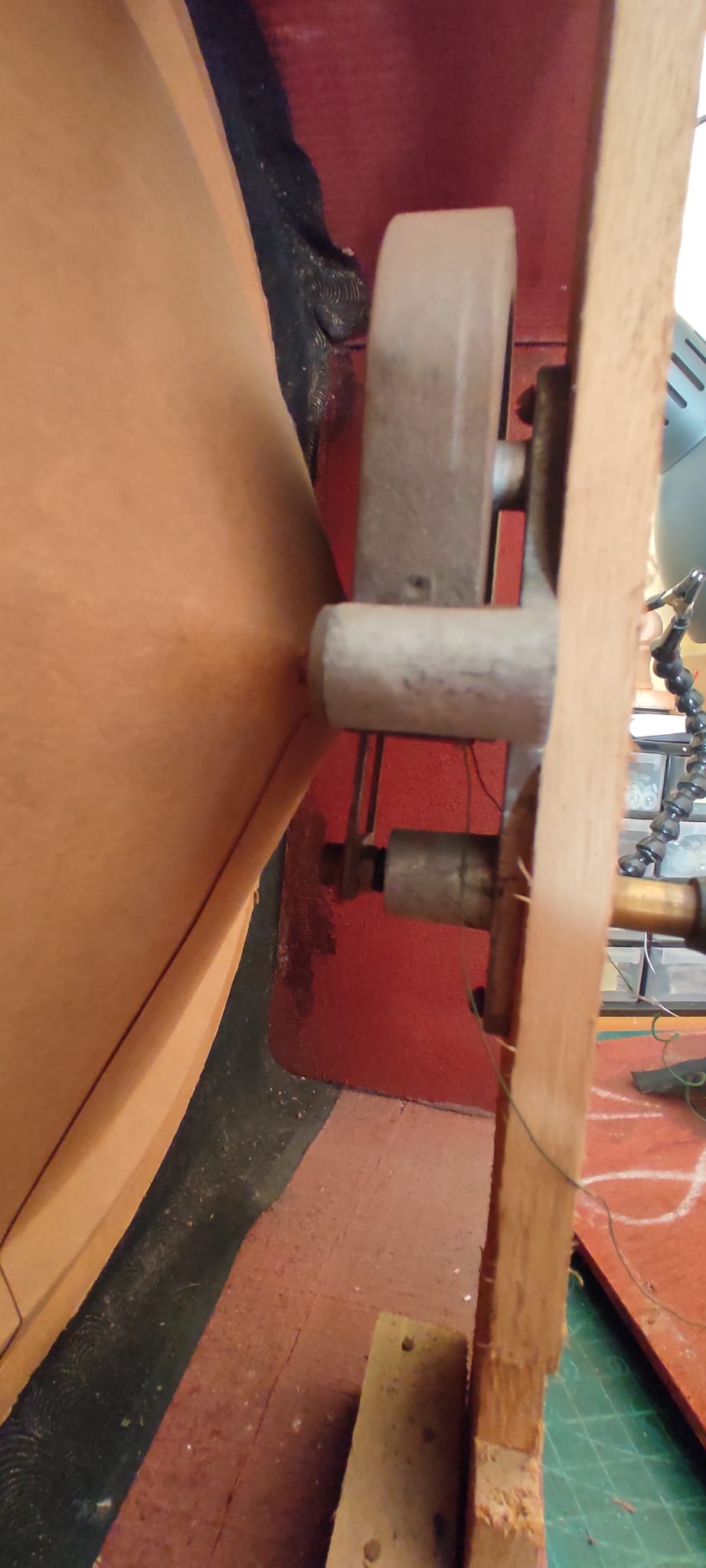

"I suppose it's a field coil speaker, so transformer won't help."
No, at that time there were no moving coils speakers on the market but so called "Freischwinger" in Germany.
They had this classical horse-shoe magnet on the back.
Btw these were used in the "Volksempfänger 'RE301" as well.
As Rayma suggested, a 70V transformer is a good choice. Note that 5Watts at 70V is 980 Ohms. Some amps will require a large series capacitor to drive a transformer. 4 Ohms to 980 is a turns ratio of 15.6 and your amp may work better using the 8 Ohm to 1960 Ohms ~= 2.5Watts because the inductance is higher.
Others have mentioned field coil speakers. Some very old speakers did not use a permanent magnet. Instead of a permanent magnet, they had a second connection for an electromagnet which were also part of the tube amplifier power supply. Powering a field coil would be a huge drain on a 9V battery, ie not suitable for a portable system.

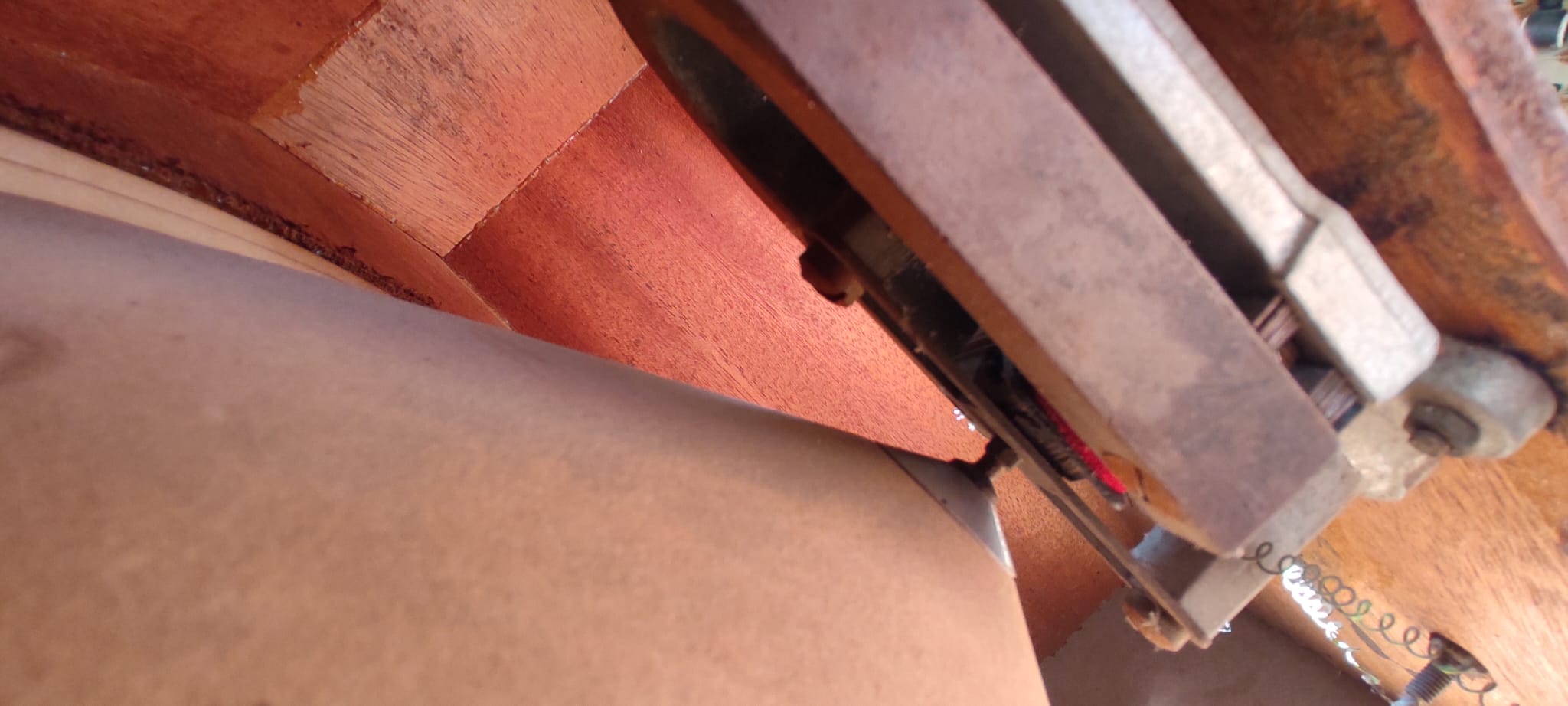

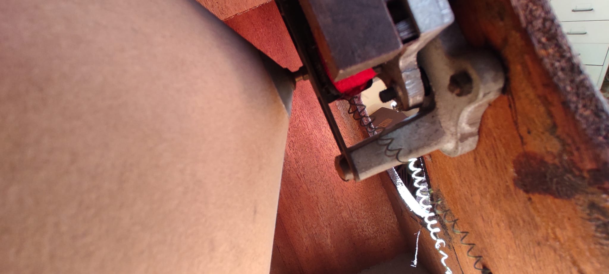

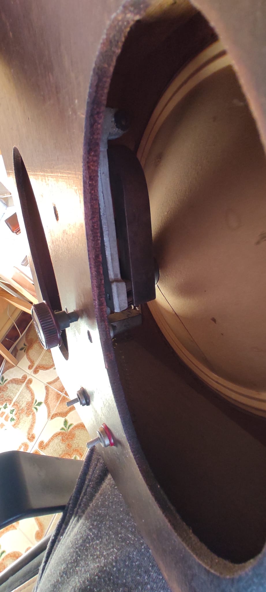

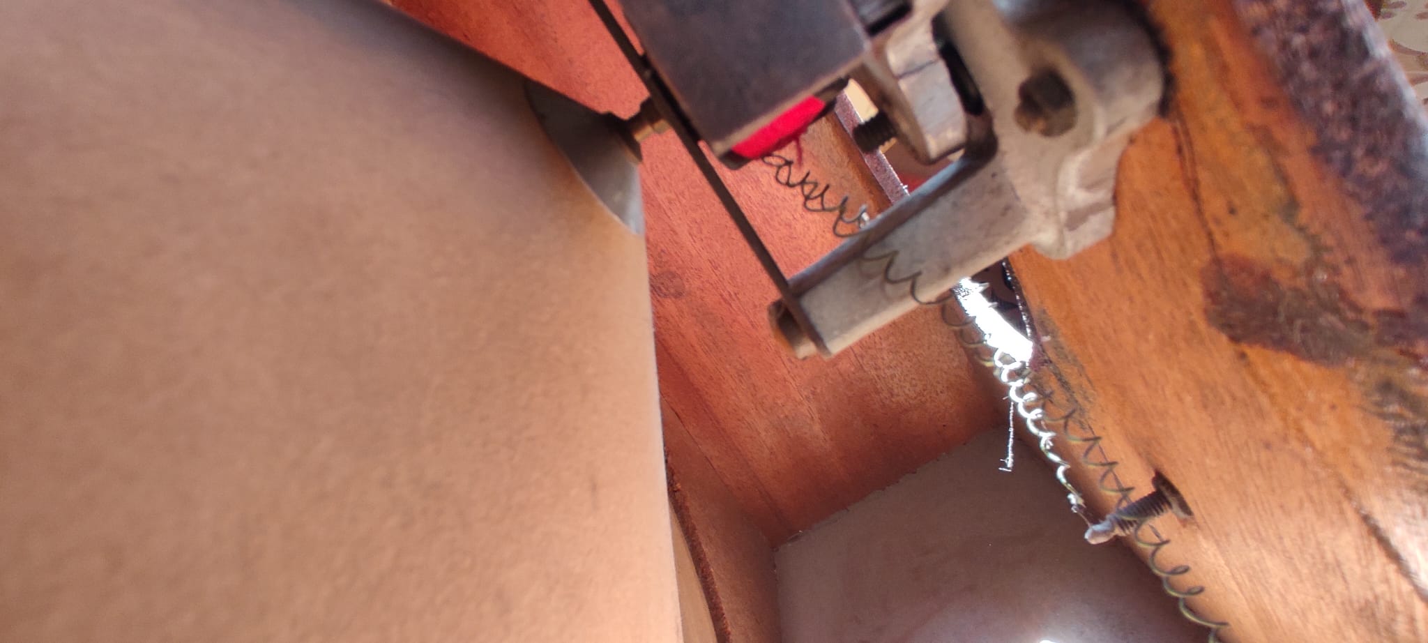

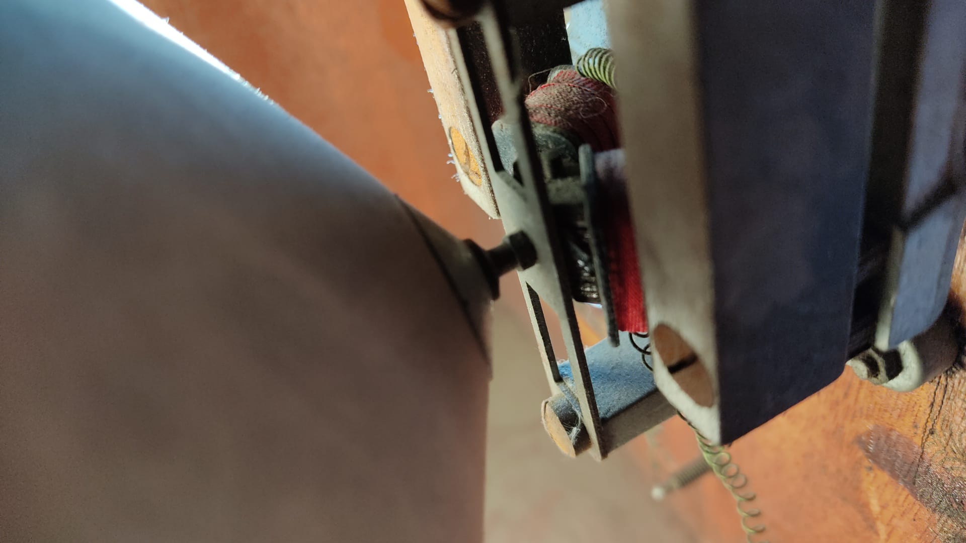

Hello, everyone! thanks for the replys
Here are some pictures. I have 3 speakers of this kind and they all have the same type of coil and magnet. The screw in the back acts as a On/off switch I would say. You screw it and it makes contact and you can hear the speaker work.
Sorry for the messy pics, its not easy to shove the cellphone. The back lits are not possible to open except for one.
Here is more info about one of the speakers: http://earlywireless.com/celestion_c12_picinfo.htm
Cheers!
Cheers!
