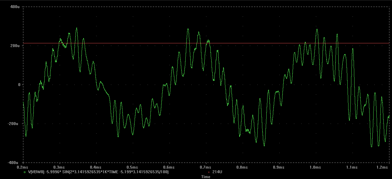

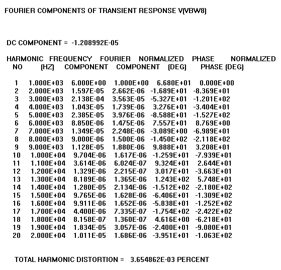

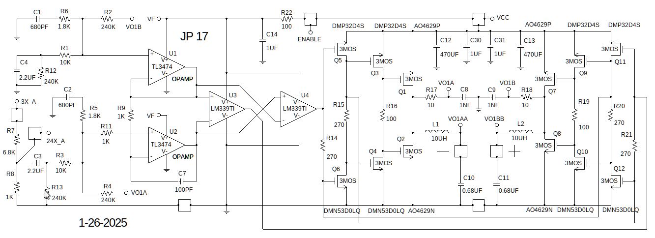

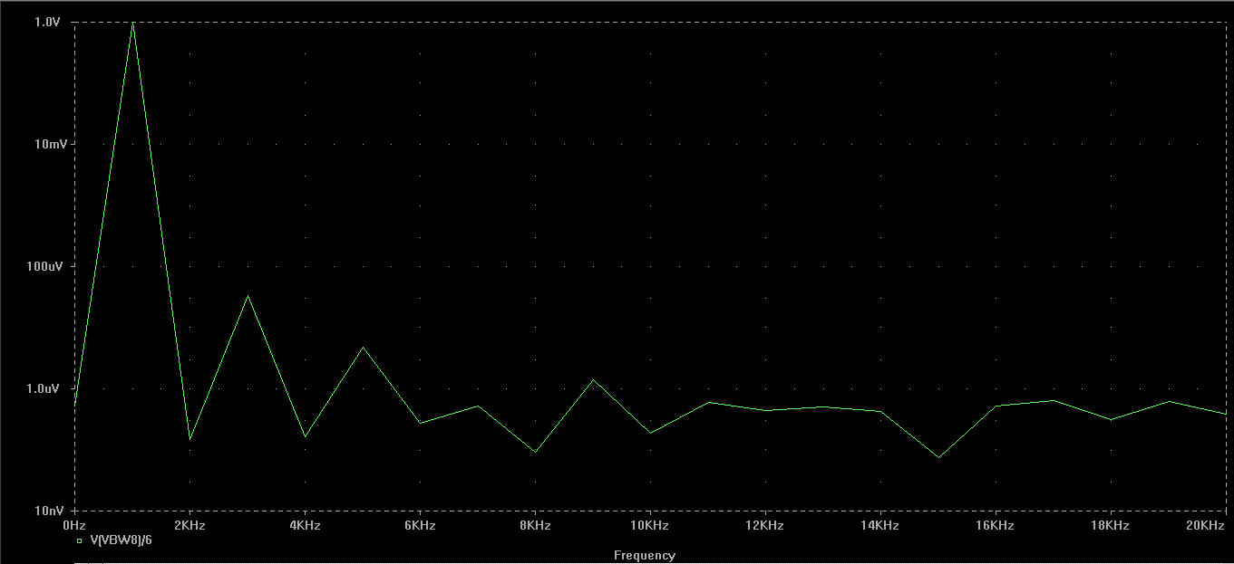

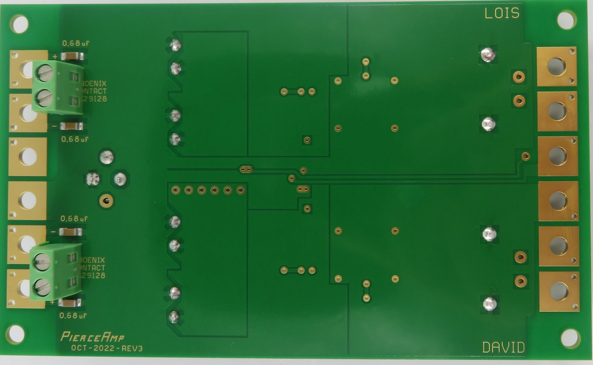

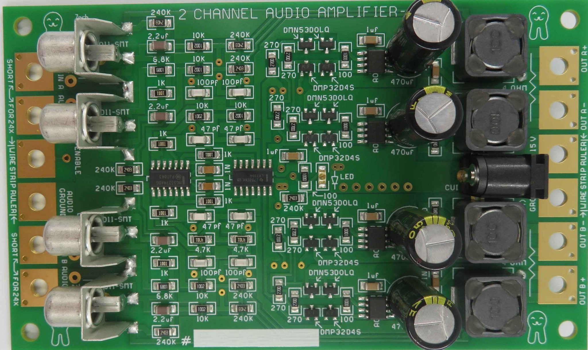

Here is the latest iteration of my Class D Amplifier. It is a low power amplifier compared to many since it is rated at 18W RMS per channel. I use it with a 12V, 3A power supply. The design is similar to a chip amplifier that uses an integrating op-amp in the control loop. It is discrete because the TFA9815T chip amp that I was using went End Of Life. It is self oscillating at about 500Khz on one channel and 450Khz on the other. The distortion simulates to be 0.0037% THD at 1Khz and 5W. Much of the challenge of designing a switching amplifier is in the creating of a layout that does not buzz at some power level because of feedback from one channel to the other. With years of experience and after a few tries, I was able to make a clean layout with good channel separation and no buzzing. It is also very quiet. I hear no white noise from the speakers. Here is the schematic and the layout if anyone wants to see them. I am using a MC33274A high slew rate op-amp on the board instead of the TL3474 that is shown on the schematic. I edited the Spice model of the op-amp and the LM339 comparator to match my bench results. I use my amp with Ascend Acoustics CBM 370 SE speakers which are low distortion and efficient at 89 db sensitivity and I have no complaints. It gets louder than I can stand and the clarity is better than I can hear.

I will have to generate them. My latest schematic is correct but I don't have the latest gerbers for the design. I was modifying older boards to prove the new schematic. I will need a little time to re-learn the dip-trace software.
