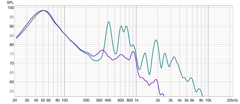

I line the inside of my boxes with sonic barrier from Parts Express. Then I add some recycled denim that I cut into small squares and roll up to the inside of the box. It's important to take measurements without the denim then add it to see if it suppresses resonances. It matters how much you put in and where you put it. You don't want to overstuff the box. But you can make dramatic differences if you get it right.

That's a start. I don't personally model any port resonances. I take measurements because that's going to show you what exactly is going on. Then add some stuffing from there.
The picture here is of 2 measurements of a Purifi 6.5" woofer with a port. The green measurements shows the resonances. The purple one shows what happened when I strategically placed some stuffing inside. The resonances were massively suppressed and the low end remained pretty much the same. This is what you're looking for. Don't overstuff. Put a little bit in at a time and measure.
