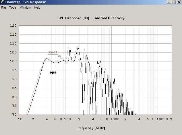

Hi kornnylike,
Not much difference:

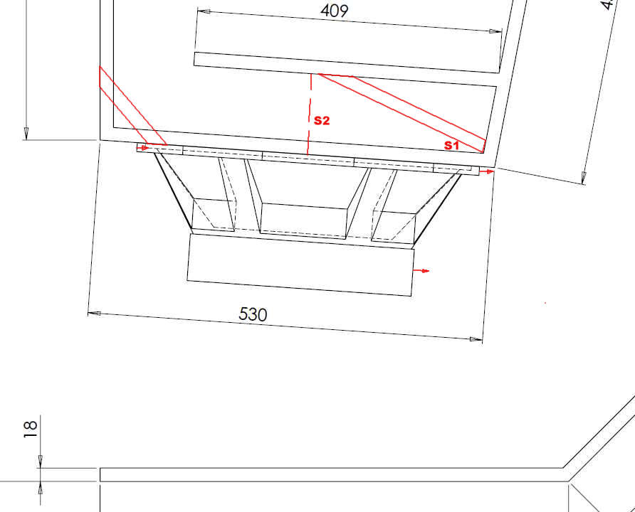

Hi kornnylike,
I'll attach a sketch of what I'm talking about, Josh Ricci did this in his OTHorn. It would be much easier for Xoc1 to add something like that to his existing drawing then for me to start from scratch. But it's a good, well documented design as it is.

Hi kornnylike
I am updating a version for you Going to run out of time today (Back to work in the morning!)
Initial screengrab attached.
Multiply the ht dims by5.88 for hornresp cm sq areas
What is the Xmech of the 18TBX100 driver as the extra panel must clear this! Also the driver will need carefull positioning to ensure the fixings for the speaker can be fitted.
Regards
Martin (Xoc1)

Hi kornnylike
Regards
Martin (Xoc1)
Thanks for updating the design.
I am not sure if this is correct but I google the 18tbx100 Xmech and few websites have the Xmech @ 19mm-21mm.
Also can you put the measurements in inches

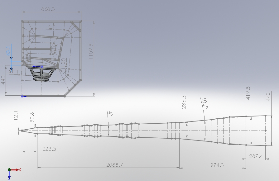

Hi Kornylike & TB46
Plans attached in mm and inches (Last time I was asked to set out anything in inches in the UK was over 25 years ago!)
I am interested in why you think there is advantage in adding the ramp and reflector / flare to the TH. You really need to use Akabak to Sim up the speaker with that much accuracy. Extra dimensions added to the fold detail for that purpose if anyone is interested enough to do a sim.;)
Regards Martin (Xoc1)
  • 18in 30hz - 6 Fold TH Assy.PDF
  • 18in 30hz - 6 Fold TH Assy Inch.PDF
Hi Xoc1,
Thanks for providing a revised drawing for your 6 Fold TH. I agree, there will only be slight differences, but it certainly is nice to have your great drawing to look at. A quick try in Hornresp seems to indicate a small improvement in the impulse response. I'm setting S1 to 6 and S5 to 2957.64 and L45 to Exp. To me your 6 Fold TH looks like the perfect fit for the 18TBX100 (even without any revisons).
There also seems to be still some debate about mounting the driver to the horn with a mounting plate, providing the full cone diameter in the mounting plate, and a reduced entry into the horn. ScreamerUSA did this in his Furybox. This would create a small coupling chamber between driver and horn, which again may be beneficial, but only measurements could tell the difference at high power.
