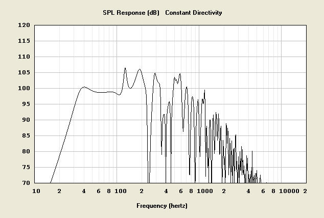

here the difference between mouth 2200 vs2700 cm2

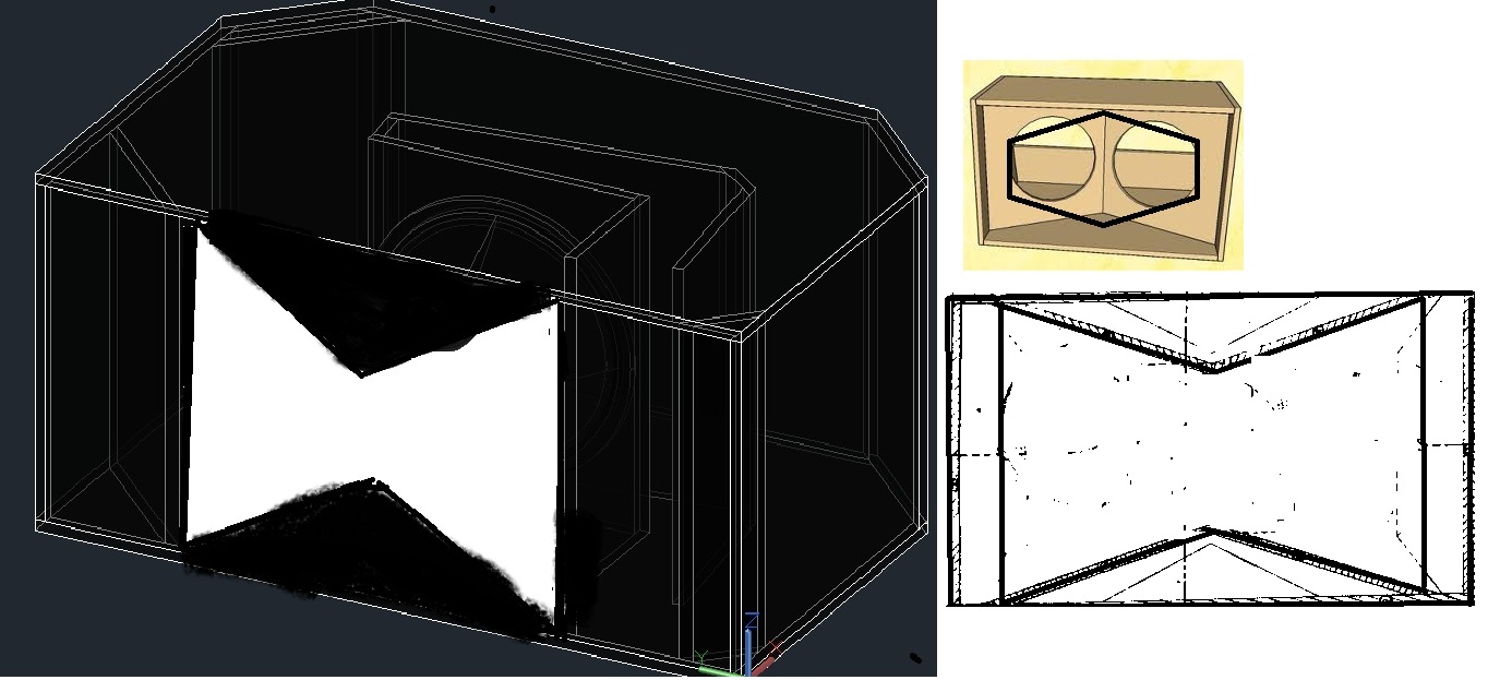

For the mouth use the same cut but the mouth plate slant in a v shape looking a horn mouth.

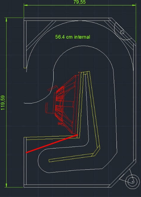

cyclops is great but the weight isn't light. i think this design is lighter than very much. wait to see kornnylike will do finish.
2 sheets per box with some leftovers
2 sheets per cab that is great.
not syre what you mean ,you can cut the mouth peaces slant.[/QUOT
What I am saying is to design the mouth plate like a horn flare

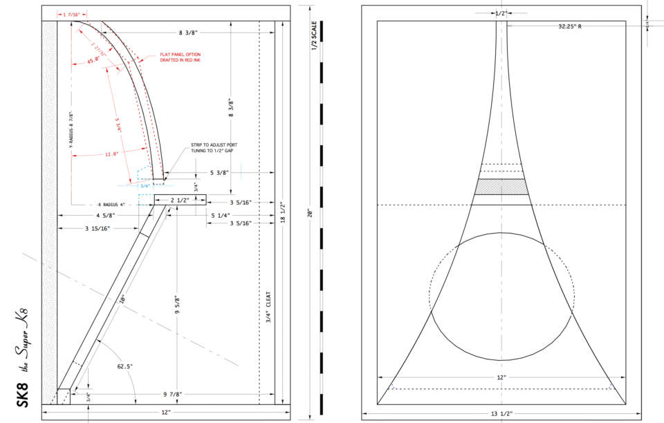

Are you talking about something like the opening on a Karlson?
still not sure what u mean exactly.
i design it with an open hole like the pic and you can put anything in you like,in the mouth.
dims are 122*80*60epa i sim will ok the db seems be the same ,but where is the dimension of this box?
its about 1.5 ~2 db down on the tbx @2.83v
Hi Thawach,
That would restrict the flow of the horn. I don't think it would work.
hi oliver that's only think if do like this. i think epa must rebuild the new plan again.
Hi Thawach,
The modification you suggested will not simulate in Hornresp. You will have to use AkAbak to see if it works or not.
