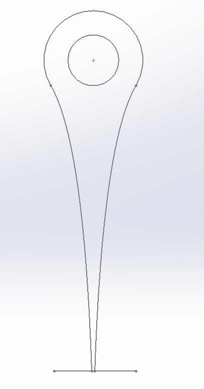

Here is driver:
W.18.200.8.FGX
below is proposed enclosure shape.
Manufacturer advice 18L/40Hz.
Could you advice with quarter wave pipe?

You're going to have to be more specific as to the size/shape of the driver pod plus if sealed as indicated, then can't use a 40 Hz flare frequency since it will be quite long compared to 40 Hz TQWT tuning.
Woofer size is 18cm. Define n*Sd needed. We can add second tunel like B&W Emphasis. Cabinet can be ported TL.
Thank you GM. Some stuffing should help with 400Hz harmonics? I'm going to 3D print this cabinet.
You're welcome!
Yes, as well has the 'bump' at tuning. Since you're ready to do something, give me a few days to fine tune it a bit and do an offset driver version that will reduce the amount of stuffing required.
I'm building for my father and like idea of B&W Emphasis but with waveguide. For this project I use smooth driver DFM-2535R00-08 and ATH waveguide.
