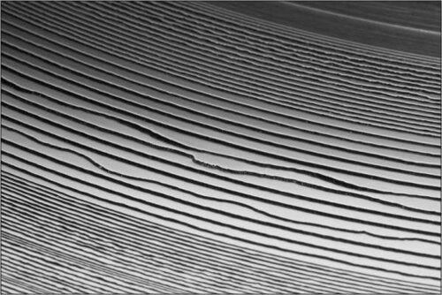

Just look at the groove, it´s larger than anything else there, but definitely it is NOT 40/45dB above loudest symphonic Music, no way.

Such extreme dynamic range, more than 40dB ABOVE MAXIMUM simply does not fit.
