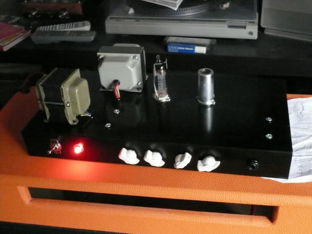

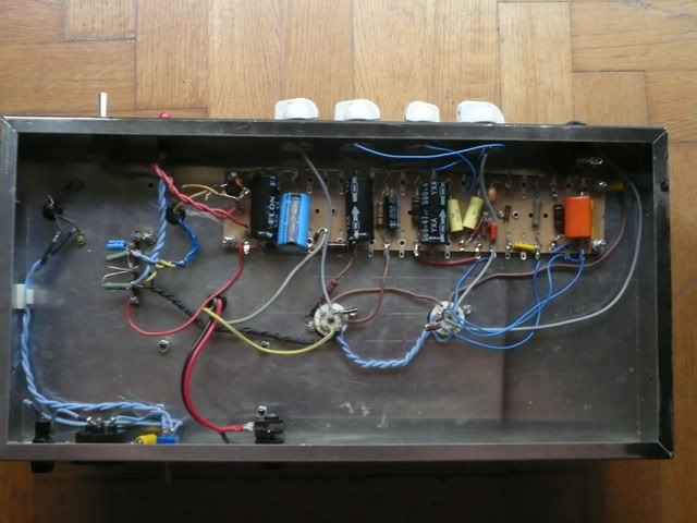

My AX84.com P1 for your reference. You can barely see the ceramic caps across the cheap diode bridge, on the left side of the board. on the bottom side, you can see the IEC receptacle with the ground lug bolted on the chassis.
By the way, it is better not to hardwire the speaker to the cab because it is nice to have it on top of the cab and tweak it while playing, service it etc. (my cab + 12 inch speaker may look like overkill, but the sound of this thing deserves it. My customer says that everybody that has listened to it has a big grin)
By the way, dont worry about blowing up your speaker. 5 watts can't blow anything like a guitar speaker...

Thanks again, I do plan on using the receptacle because I think it is easier to be honest, and I have a million of those power cords lying around. Also, I like the pictures but it is hard to see the diodes or capacitors in the diode bridge. I do understand what is being said about the caps across though. I can get some 500V 10nF ceramic caps easily.

Lastly, when building the power supply, should I mount it as far away from the audio circuit as I can in the chassis. I dont see a separate board in there for the power supply caps and resistors.
Yes,in general, power supply goes next to the power output section. Next the stage before output, etc etc, all the way to the input circuit, which is the furthest away from the power supply. On the photo, power supply on the left, 1st stage ECC83s on the right, If you follow the schematic, you'll see it is natural.
