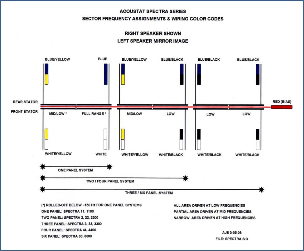

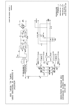

Hi I have Spectra 22's and when doing my room EQ found that both the left and right units exhibited 180 phase shifts at certain frequencies. How can this be corrected?
Here what we got.....I have the Specstra 3s......I run them fullrang..I don't care for the Spectra sound.......cant wate for more input on this.....
look like...sounds like....well to me.....there is some shift....

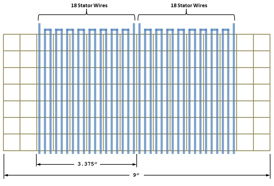

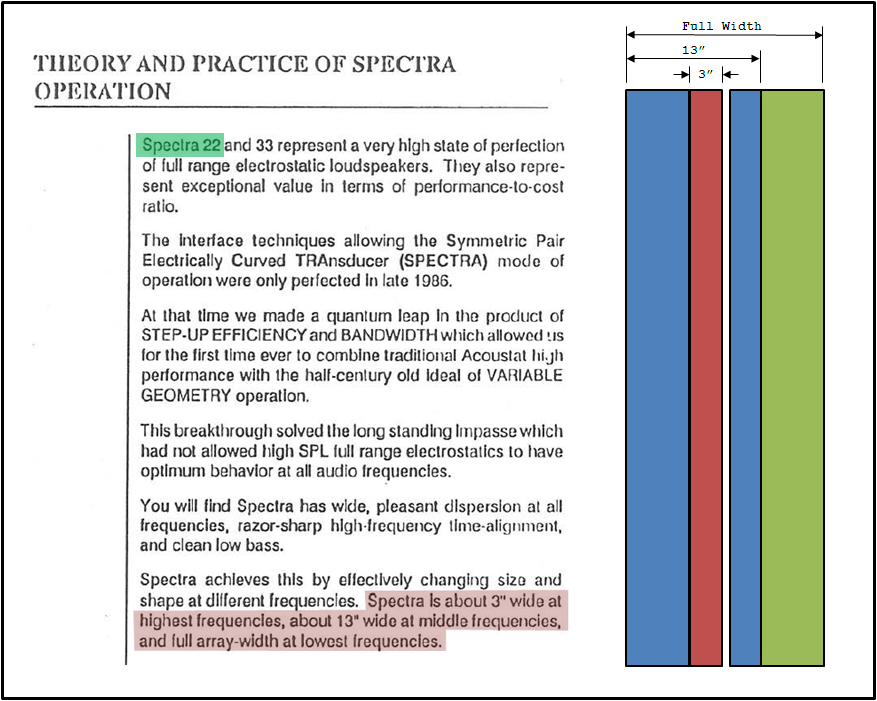

here the setup of the panels.....pic 3 is one panel....so you have 2 in ea speaker.....so that's setup to like 4 panels ea...with..4 front 4 back...but only 2 mylars.............nut right
