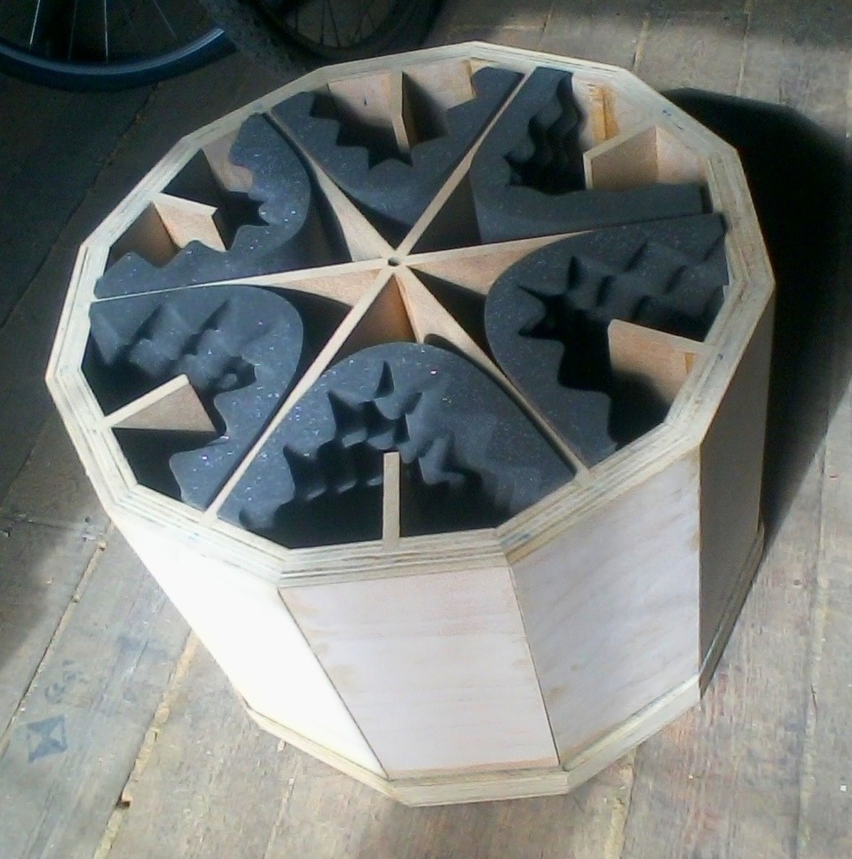

This 50l 25mm ply enclosure has the driver externally mounted to improve cooling.
Interesting is the design shown intended to reduce reflections looks like a small volumeFrom a step-response point of view, definitely. Of course they are woefully inefficient and require tons of EQ but otherwise have very few vices and are compact and usually simple to build. As they are quite small, panel resonances are naturally and usefully further away from the pass band.
55l; side panel width=135mm; Q~0.5 with the damping and the 18PZB100 driver. Damping also helps to reduce higher order harmonic distortion a little, and all panels are tied together or braced resulting in very high panel resonances due to the inherent stiffness. Big cuboid boxes really are a nightmare to stiffen and damp. The route I have chosen requires many amps and enclosures but at least the latter are small and easily manageable, and the transient response is sensational!Interesting is the design shown intended to reduce reflections looks like a small volume

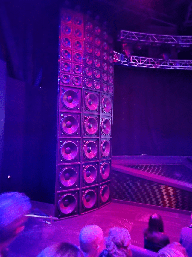

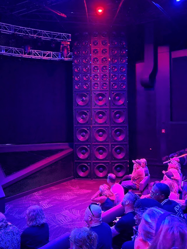

I got to experience this bass last Saturday at the Rock N Roll Hall Of Fame in Cleveland, Ohio.You've surely come across this real-world installation:
Wall of bass
I didn't choose it - they chose me! £125 each!! (They are actually rebadged as Yamaha and were sold as brand new old stock spare drivers).Interested why you chose that particular B&C driver ? How low do you go with it ?
With EQ in a pub, crossed over at 120Hz and driven by a modest bridged amp a pair will go low enough and loud enough to cause turntable LF feedback requiring a steep 30 Hz high pass filter.
Your honest impressions?I got to experience this bass last Saturday at the Rock N Roll Hall Of Fame in Cleveland, Ohio.
