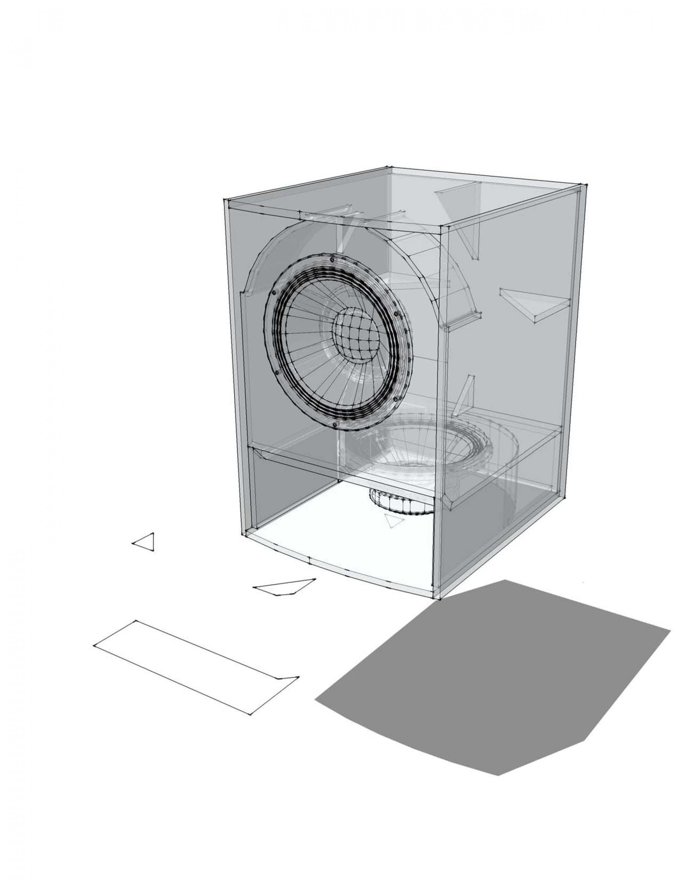

this is the concept i have for the push/pull design.
looks interesting
though due to risk of diaphragm sagging, I would be cautious with horisontally mounting of such big heavy coned woofer
in short, I wouldn't take the risk
looks interesting
yeah, that thought has crossed my mind.

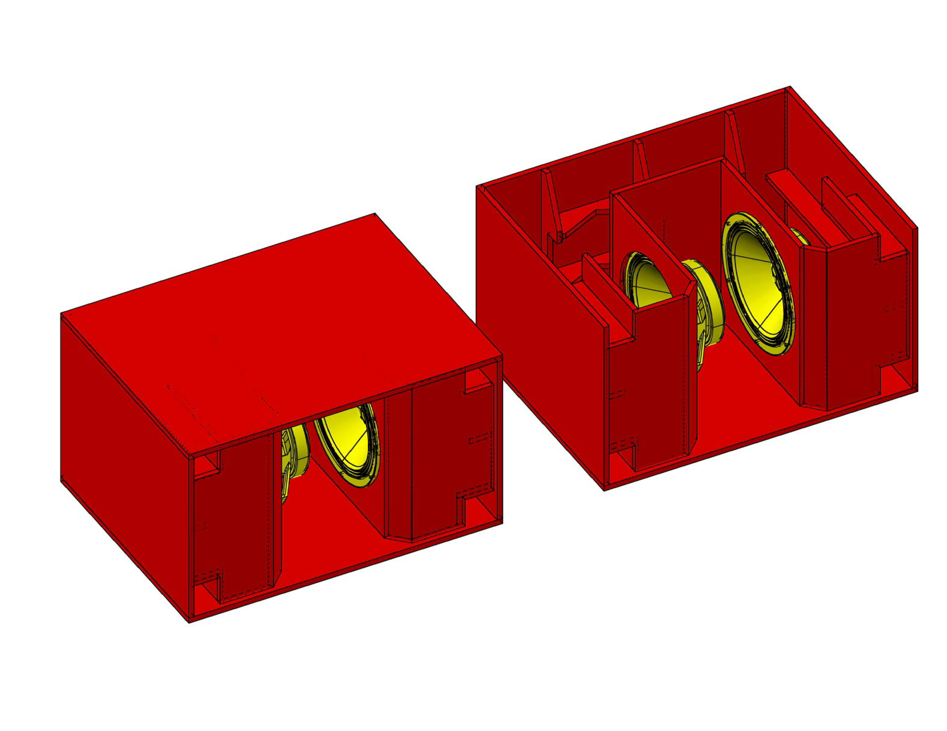

Have you modelled that box ? What's the mach velocity for the all the 4*4 ports on each sub? (Djk)? has boxes like those I think but he has one common slot port on the one side that serves both subs in each box.
design i came up with today based off the 18 sound design using the peavey lowriders. ports 4x4x14. 11.5 cuft.
this type my friend built. he told me the sound was very loud...lol..more than w-bin. if u like pp, might be dynacord F 17 PWH planar pp is the best for u.
i used bassbox pro to figure the cu ft. can't remember what i tuned the box to. the ports seem small to me. don't know if they would be noisy. this was just a quick design. i wanted to get the proportions figured out and over all size of the box. yeah i asked DJK for his concept behind his manifolds. i read a forum where he said you basically figure the cu ft and ports for the driver as if you are building a reflex.
