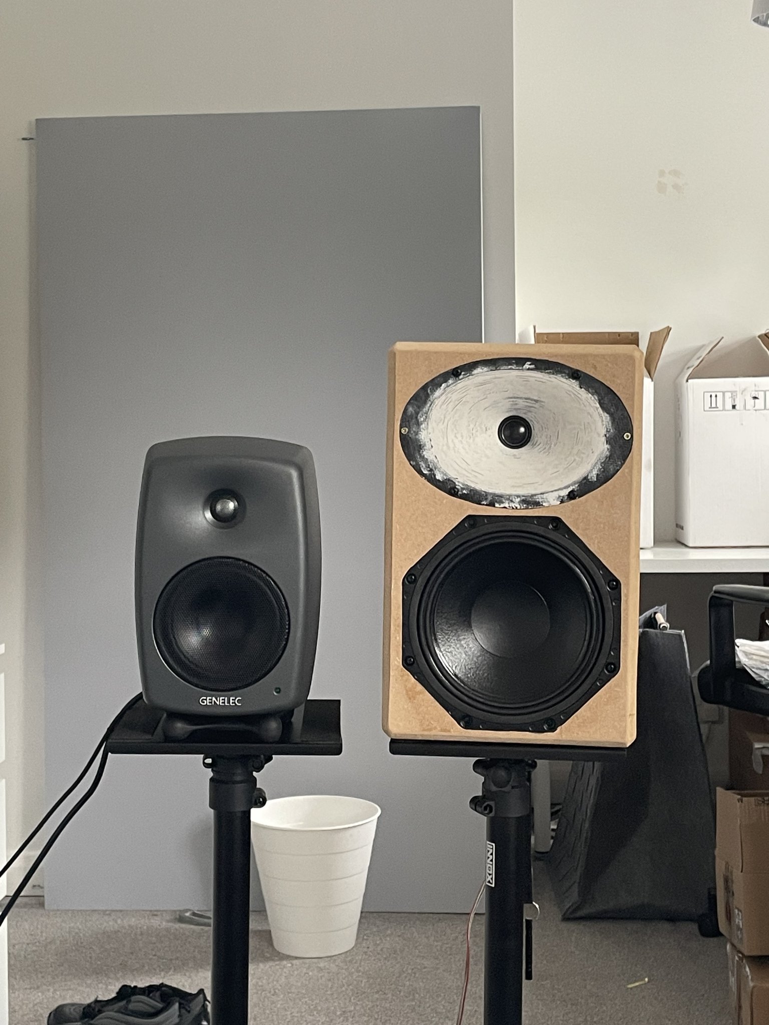

Thank you for you're insightful comments. I should have been more clear, the Genelecs don't audibly distort at reference levels, none that I can hear anyway, but visually it seems even with a 120hz crossover the 5" drivers are working very hard, and probably introducing a fair amount of IMD. I've modelled the 8" B&C driver, and also a rough model of the ported Genelec, given the B&C is almost double the surface area, and also more than double the available amp power will be available, I have no doubts the 8" will give me the levels I need whilst remaining more composed. The Genelecs don't allow me to cross any lower than 120hz given the volumes I listen at, the 8" should allow me to have more room for experimentation in the 80-120hz crossover region too!

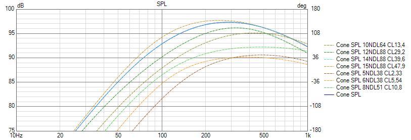

Another example for fun as I had the simulator open 😀 here various B&C NDL drivers ranging 5-15" plotted in closed enclosure automatically calculated by the simulator per TS params for 1W input power.
In general the (max) output down low is just volume displacement. If you had 100W amplifier, then system sensitivity at your target frequency defines the max SPL capability because max output would be limited by the amplifier. Bigger drivers can usually take more power before heat issues so max output grows more with bigger drivers. If you had unlimited amplifier power available bigger drivers have loads more output capability than smaller ones, which would apply here as well. 8" accompanied by heftier power amp might be plenty enough improvement.
On these particular driver models the 8" is ~6db more sensitive at 80Hz than the 5" . Enclosure is four times bigger though. If you put the 5" to the 8" enclosure it gains few db more sensitivity but max SPL would still be limited by xmax, max volume displacement, it would just take less power in the bigger enclosure.

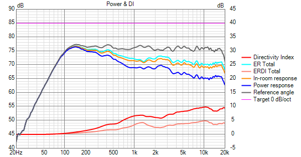

Just to update this thread, I built the 2-way using BC 8NDL51 and 8" somasonus WG with SB26ADC optimised with VituixCad, I couldn't be happier with the sound. As detailed but more dynamic than Genelec 8030c, way more output and only £200 or so more expensive, not counting the hours spent designing measuring etc. Atm its still a prototype, and I intend on going CLD with the box and of course a nicer printed waveguide.
Thank you! I briefly tried an LR8 crossover which tidied up the directivity a little but didn’t sound as good to my ears. My original goal was to get close to the performance of the Genelec 8050 and I think I’ve achieved that!
Can the BC 8NDL51 do an acoustic LR2? Try it you might just find it's improves the PIR and power response around 2-3Khz.😉
I’ve tried LR2, LR4 and LR8. No matter what I did LR2 sounded awful and looked even worse, LR8 smoothed out the directivity peak and power response a little but for some reason sounded worse than the LR4 which I’ve settled on for now. The PR peak at 2-3khz is only around 1.5-2db and isn’t too audible.

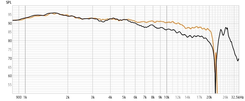

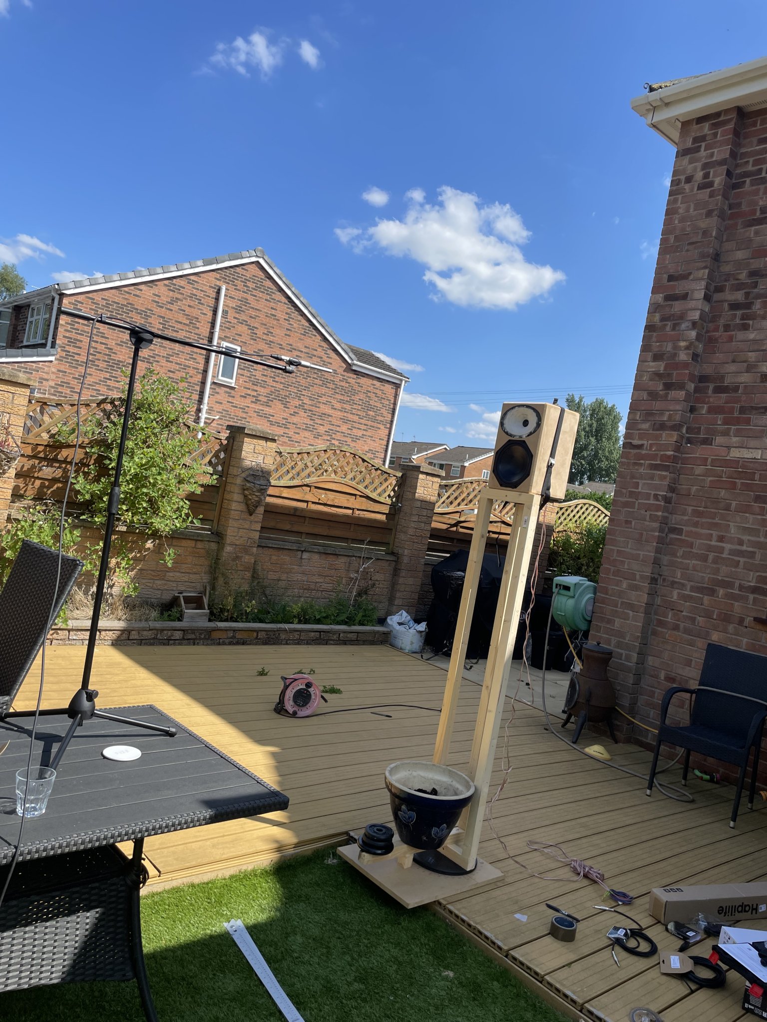

The above are just active XO simulations. My first simulation at 1800hz using ViutixCad was re-measured outdoors and was almost identical to the sim, I still need to go out again and remeasure this one.
For a crossover at 1800Hz you don't really have to go outdoors IMHO. I think the off-axis bump beginning at 2k is baffle-related.
The crossover is at 1200hz, it’s either baffle related or waveguide related, either way it isn’t audible, but the next box will have larger round overs.
To me, it looks like a calibration error in one of the mics... Are you using a calibration file? Be certain that you are using the Umik calibration with Umik, and the EMM6 calibration with the EMM6...
