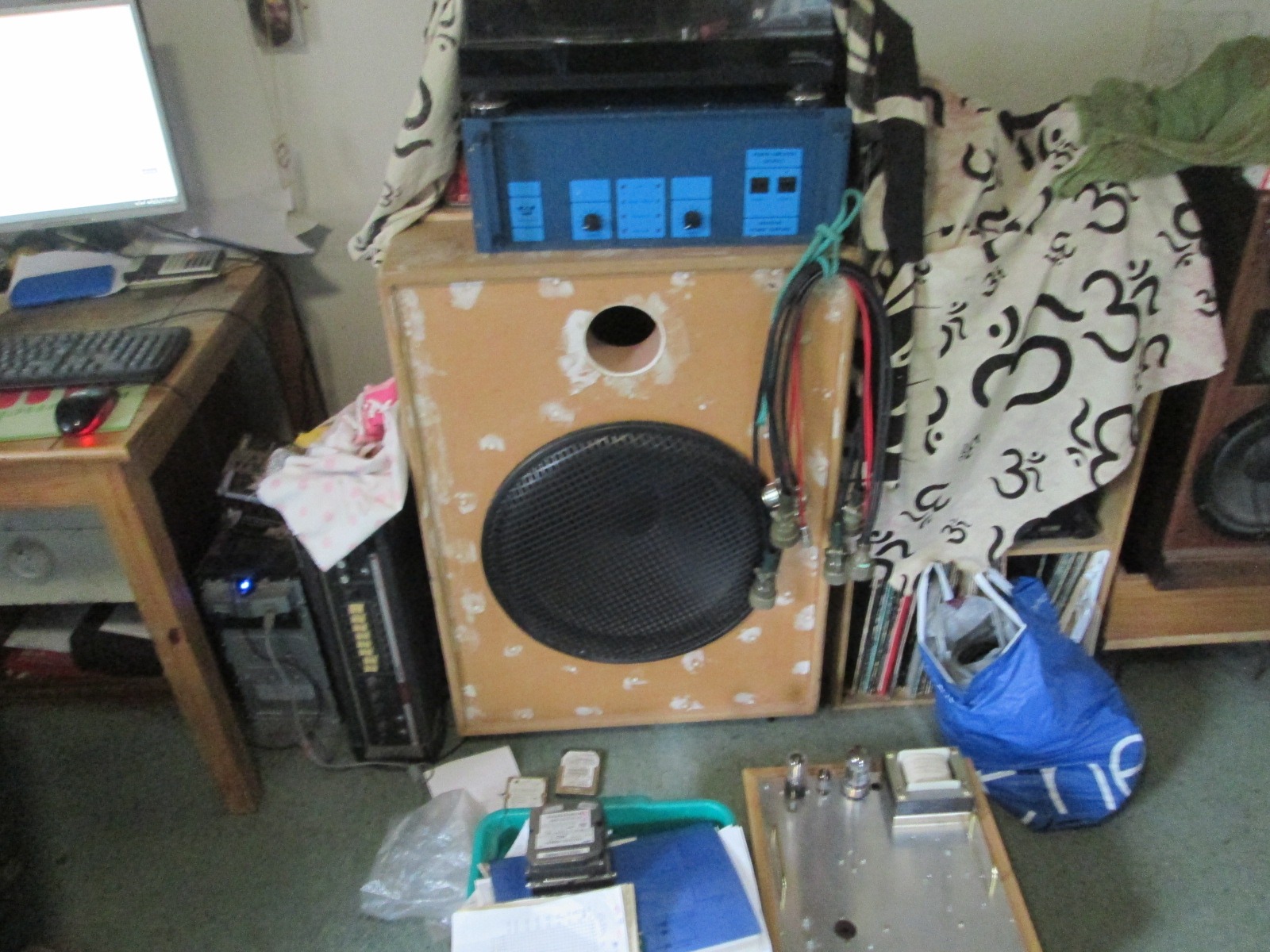

Here you go, it is an EP18 400, Eminence sent me the T/S parameters, it was a custom designed speaker. I designed the cab using WinISD, here's a pic. The cab needs a coat of black paint. Dimensions are - 34" x 24" x 18". The cab is made from 3/4" MDF it's ported but sounds about the same non ported. I used the big blue amp, a Stage Accompany SA900C to drive it. The variable filter from memory is 20hz to 500hz.
"Here are the T/S parameters for 18083:
05-RE OHMS 5.90 13-FS HZ 27.96
06-LE MH 1.36 14-MMS GMS 102.57
07-QM 8.89 15-CMS mm/N .3159
08-QE .280 16-RMS NS/M 2.0267
09-QT .270 17-VAS LTRS 596.18
10-XMAX MM 5.50 18-SD SCM 1159.17
11-BL TM 19.58 19-EBP 100.8
12-EFF % 4.53 20-SPL dB 98.6"
